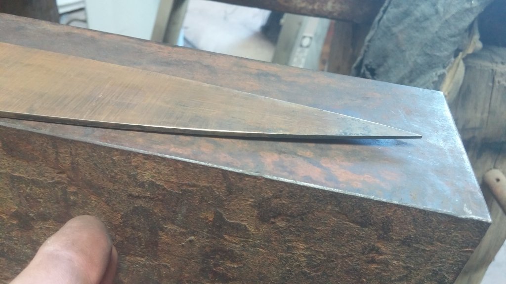

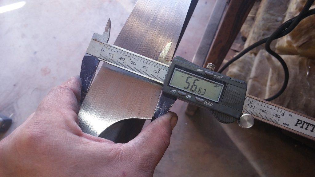

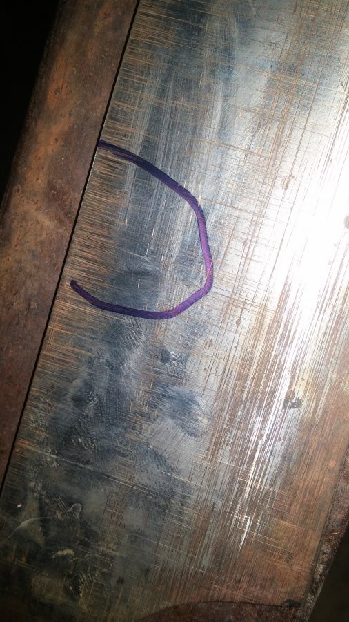

    Currently, the blade is sitting at almost 270mm long, and 57mm on the heel. The extra length and height were to combat warpage and/or possible issues with the heat treat. That said, it survived (although it warped pretty badly lol), so I will be free to shape the end profile as I please.
    The black lines indicate where the apex of the two largest warps are...one to the left and one to the right. The blade almost through hardened...with whorls and spots of soft steel mixed in all over...so straightening it will be even more problematic. 64-65HRC W2 isn't exactly what you'd call tractable when trying to make it deform lol.

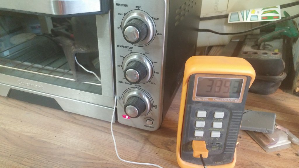

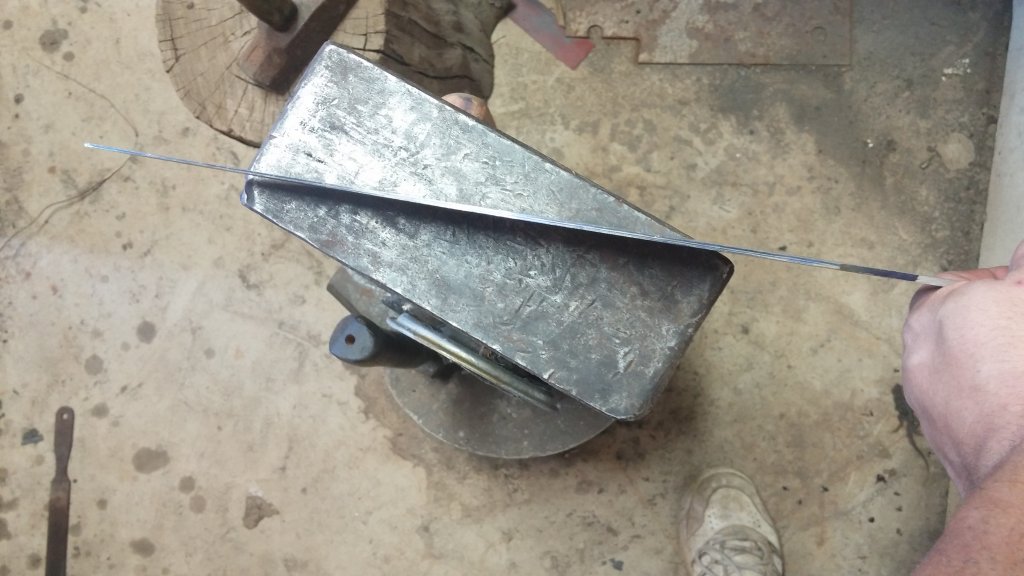

    This is my tempering setup. The thermocouple ensures that I keep things at the proper heat, while the blade sits inside a muffle to keep air movement minimized around the blade. I ONLY straighten at tempering heat...in this case 400°F to 430°F.
    As you can see, fully hardened W2 is no joke. I personally have never seen greater than 68HRC...but even still, that's nothing to laugh at. At my preferred tempering heat I consistently got 65HRC, with some blades coming in at 64HRC.

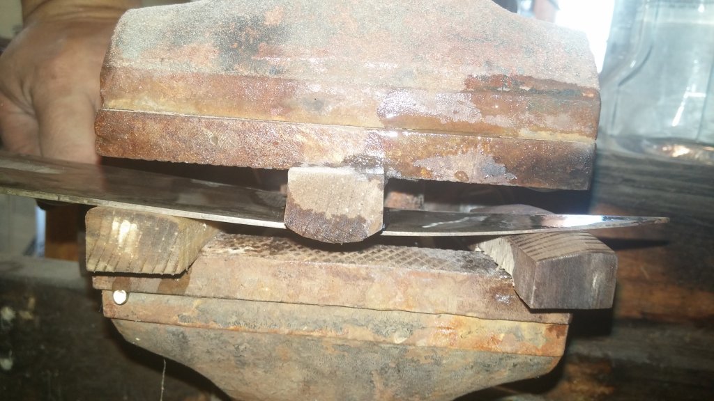

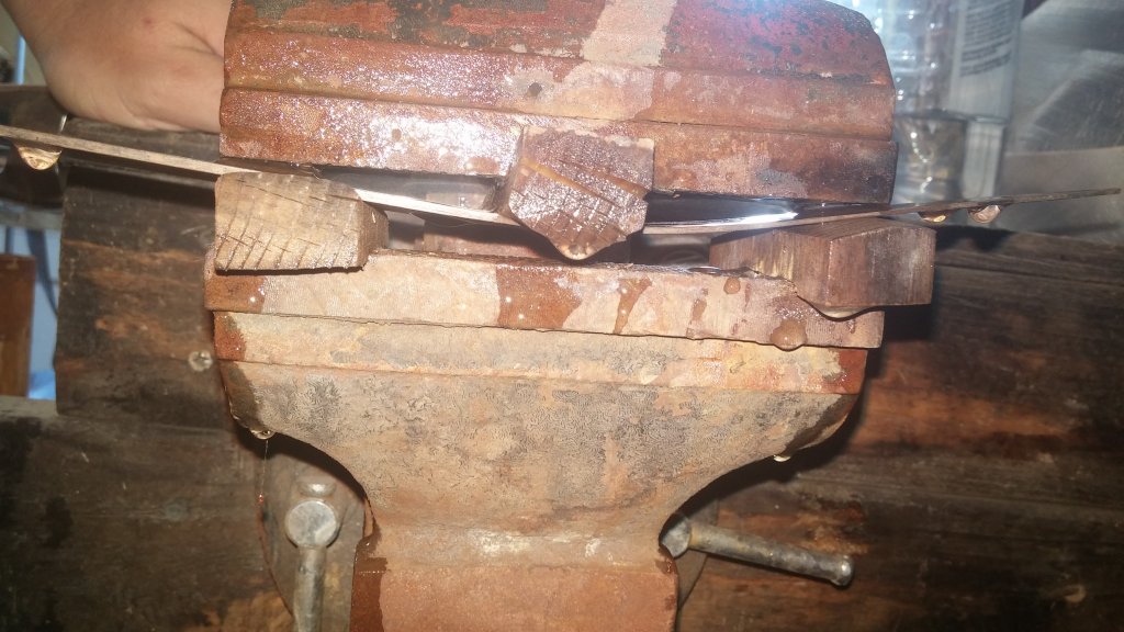

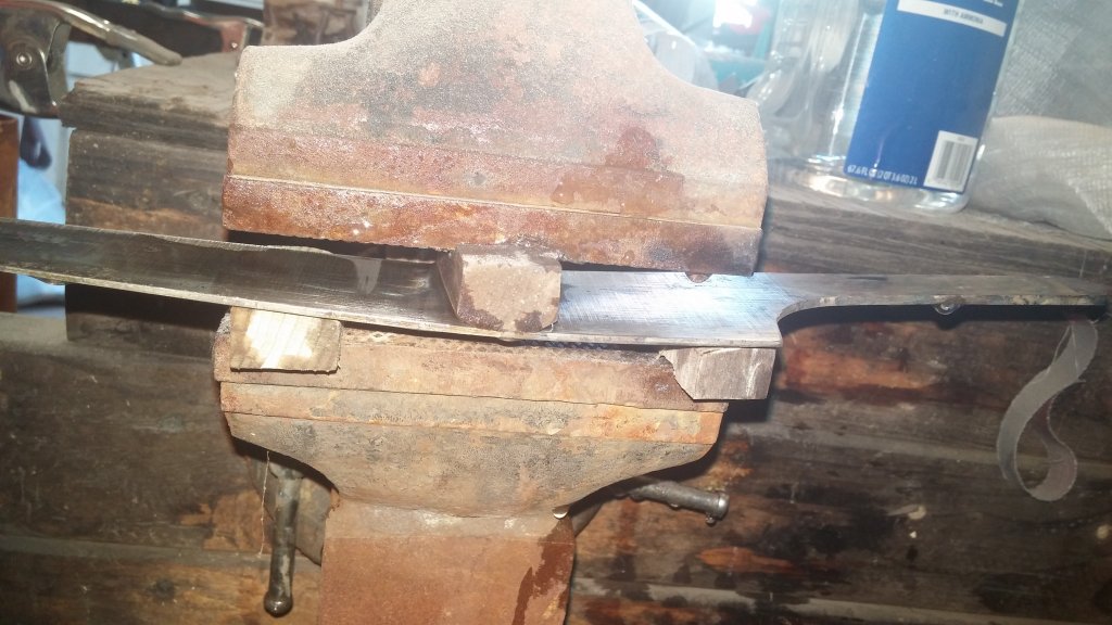

    When straightening blades this hard...it's best to start out slow. I temper for an hour at 400°F, then begin my process. Slight bends, quench the blade in the vise...return to the oven...rinse and repeat, increasing the amount of bend each time. This takes HOURS...sometimes days. In the case of this blade I've been at it for two days. Believe me though, two days taken straightening, is far better than a snapped blade.

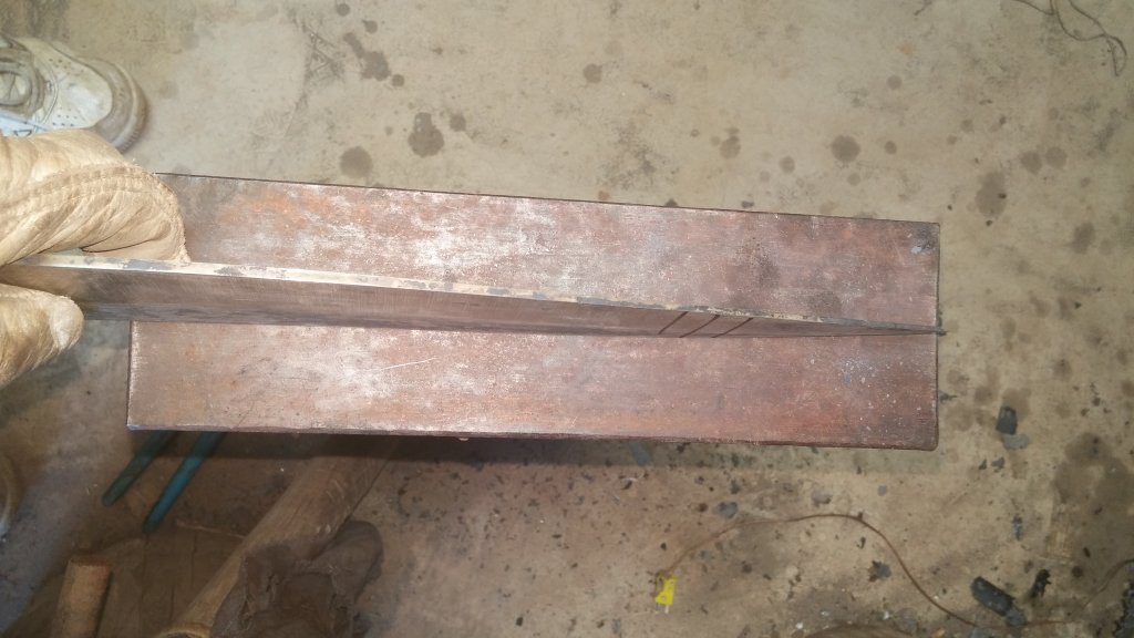

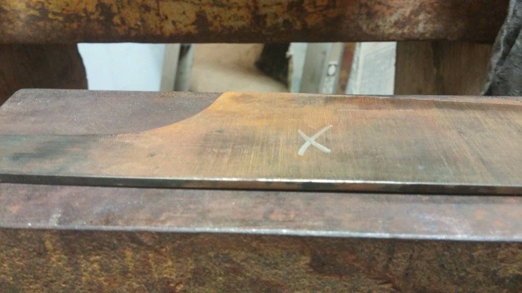

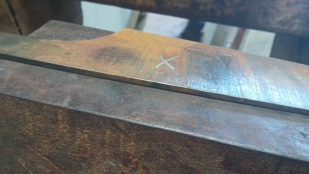

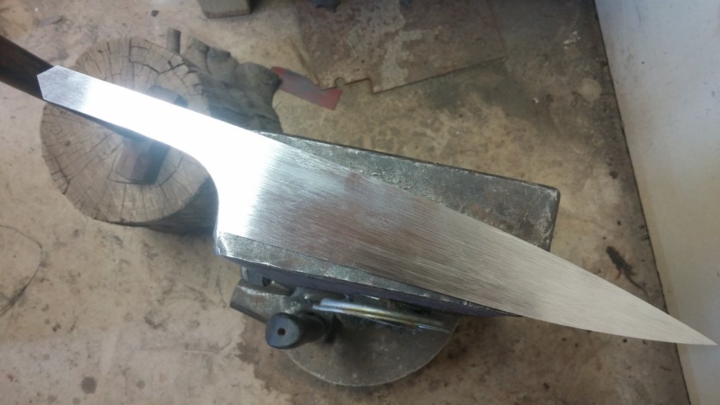

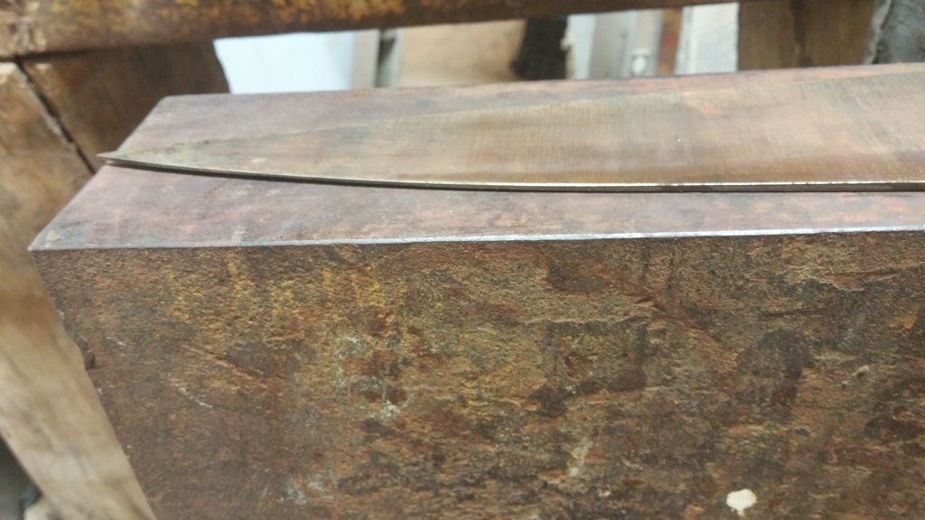

    This is how the blade looked after three cycles today. As you can see, most of the bend has been removed from the heel warp (it was previously 3mm high). The tip however, still feels that 425°F and 30° bends are hilarious. Time to ramp up my efforts.
    The blade is currently sitting in the vise like this while I go to dinner lol. It sat with a slightly less acute bend overnight last night. When I get home this evening, I'll be using the hammer and dished out stump to beat it into submission.

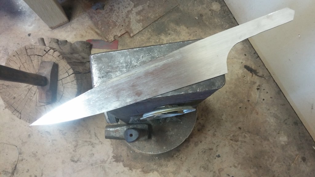

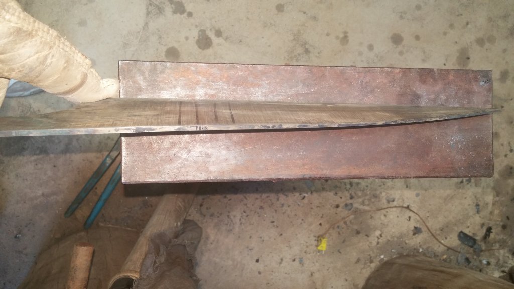

  5. Basically...it's a stump, with a dip in the face. Heat blade to tempering temperature, place apex of warp over low spot on stump, proceed to whale away (mostly on the spine side of the flat...the edge side will follow suit) with a 2lb deadblow. If THAT doesn't work...pick up the 4lb forging hammer, and repeat.
    Remember, this is pretty much a fully martensitic blade...meaning, it's freakin hard.
  6. WildBoar
    WoW! Marc is trouble, isn't he? :D
  7. Maybe a little lol...but nothing I can't handle :p.

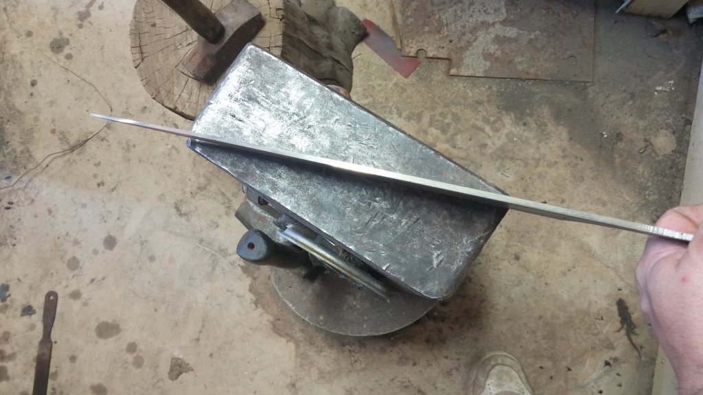

  8. Straightening with a dished out stump:

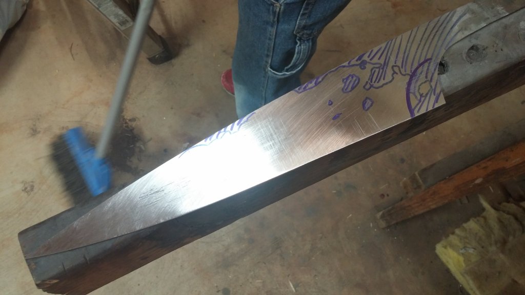

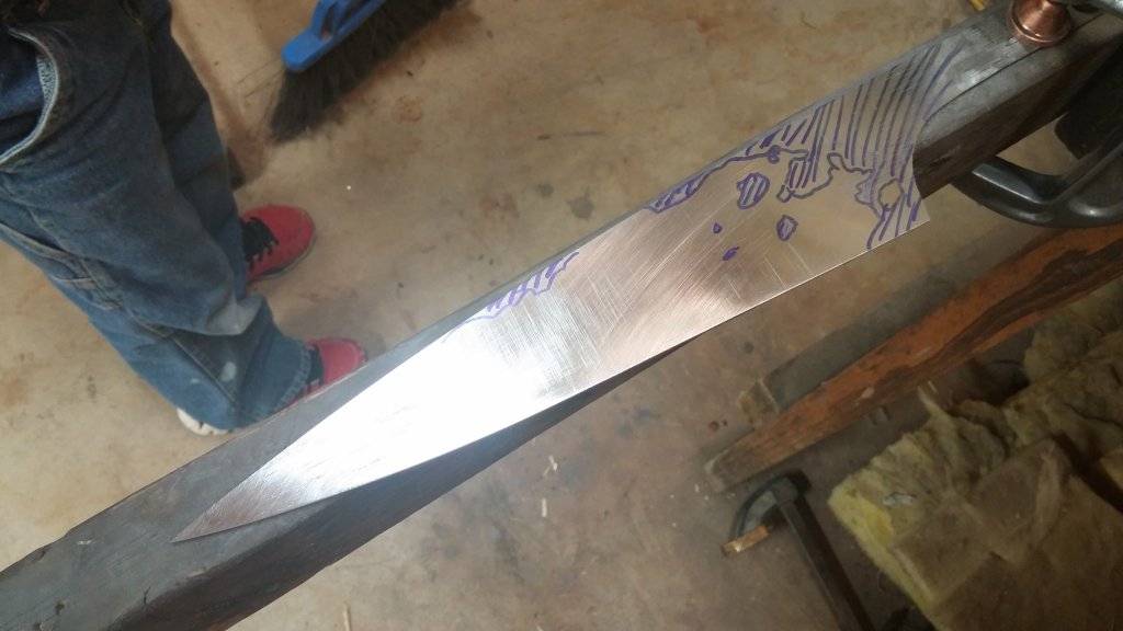

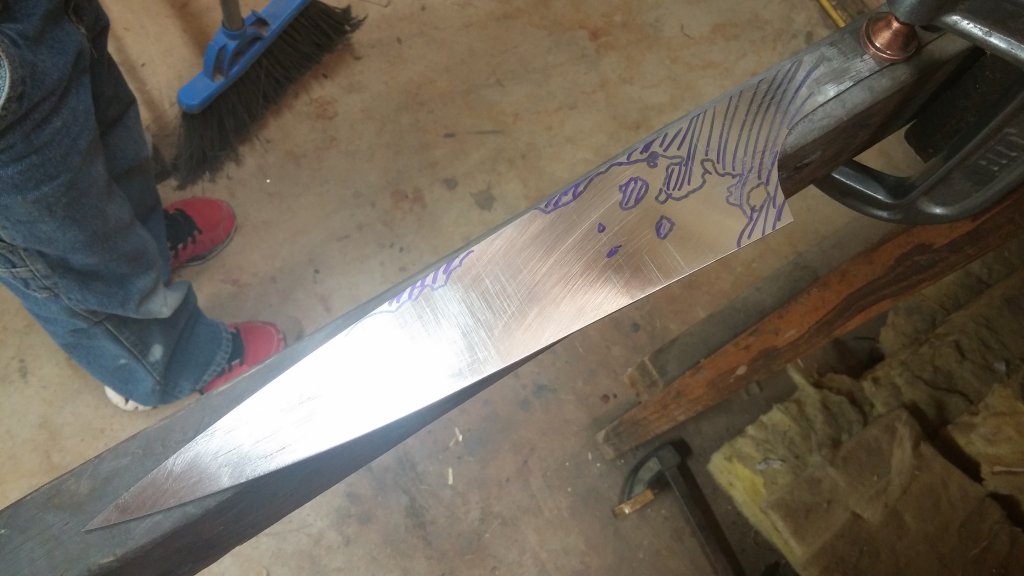

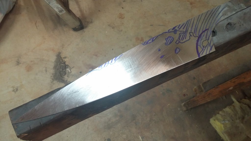

    And the results. Compared to above...it's a pretty decent difference. Enough that I could get the blade on the grinder for a few light passes...then do some diagonal sanding with 120 grit to check out the hamon. Some things in life just need beat into submission it seems.
    Here I've gone and highlighted the line of the hamon...and filled in the soft steel with blue stripes. Needless to say...that heel will NOT work (unless you don't care about edge holding or sharpness for the first 2cm lol).
    BUT!! This is why I always make my blades a few cm longer and higher than necessary. You can see the new heel marked out...which puts this blade right at 249mm long, and 55mm high. The only thing now though, is that I HAVE to get the tip perfectly straight. In all honesty though...I wish I could have kept that portion of the heel. If the hamon had been just ONE cm high in that area, we'd have taken the extra length off the tip. I just love when there's holes of hard steel mixed into the soft and vice versa!!
