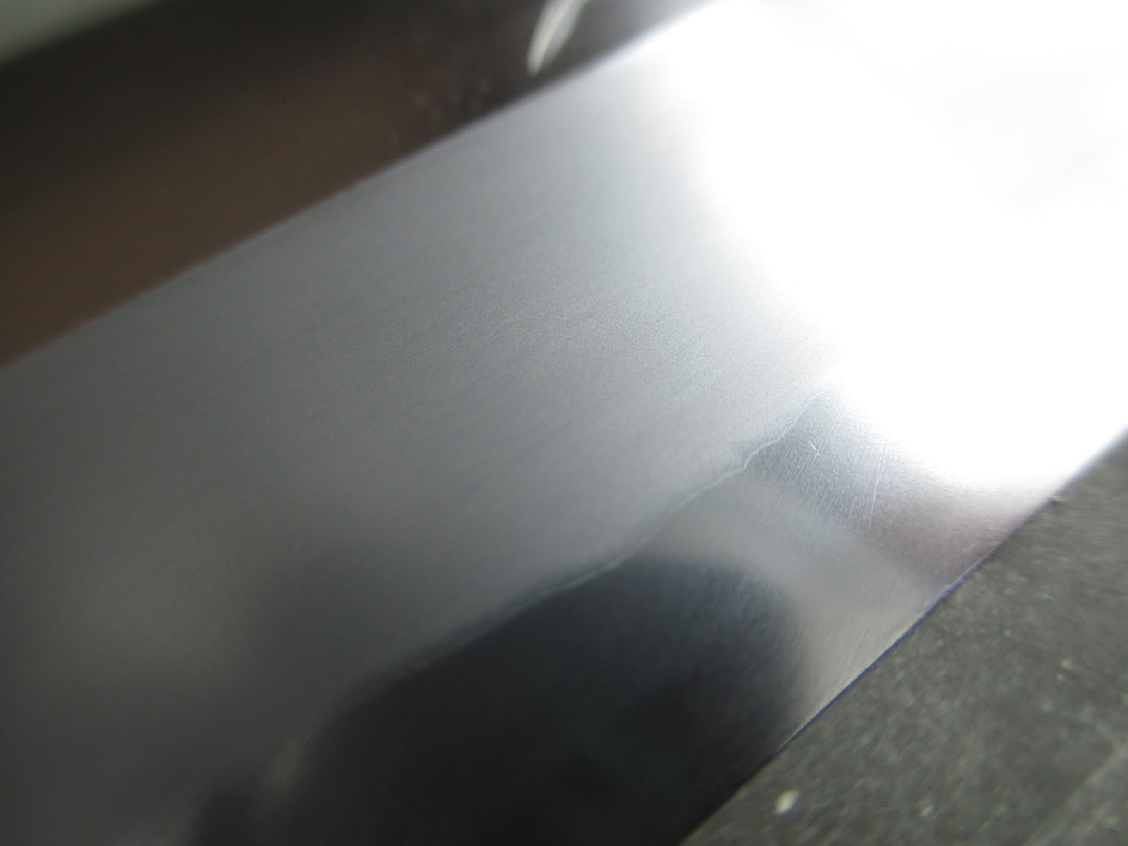

    Look on pictures of my Suisin Densyo.
    JNS scratches and White Binsui scratches:
    After polishing on mystery stone:
    After mystery stone fingerstone:

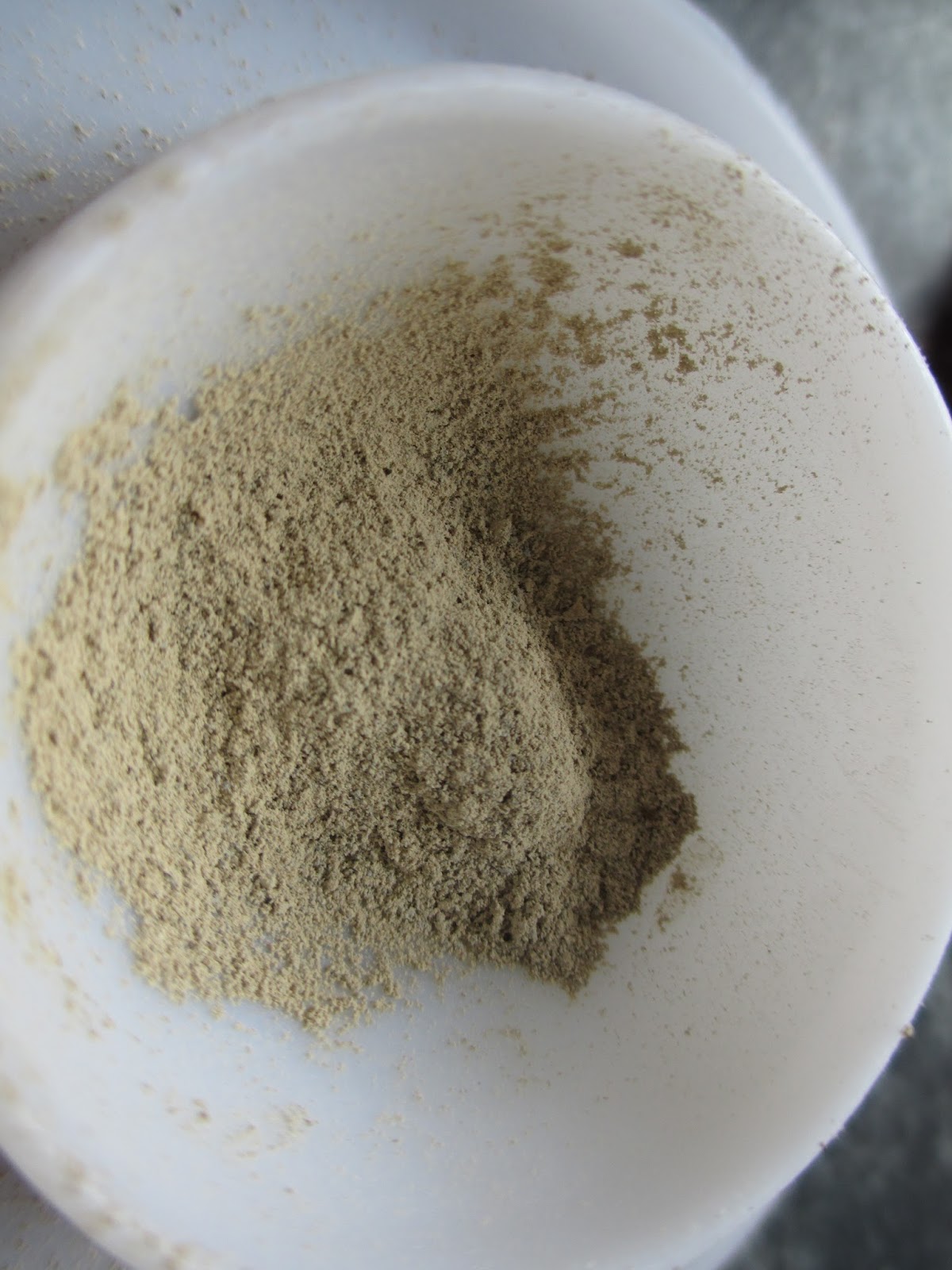

    And after that I ground few pieces of mystery stone fingerstones and uchimogori in mortar and used it to polish yanagiba.
    Look on results:
    Not bad as for stone which cost £20:D
    But unfortunately I will give 330_mate.com a big minus because first of all it is very hard to communicate with him and secondly he lied to me about that stone. When I asked him about details of this stone he gave me wrong information. He told me that strata is central Tomae and it is Mid age mine Nakayama Akapin Nashiji red! Hardness is class 4. Also he added that this is best stone for hard knives and that I am lucky. It is very confussing because Tomae Strata and Akapin are two different stratas and this is very soft stone from what I have noticed.
    This stone have the best feedback of all my stones. It feels slippery but also you can feel that steel is being removed and you can hear very specific whizz. It is hard to describe but using that stone is pure pleasure. I've noticed that finish depends on knife itself. When I sharpened my deba I got some scratches. In case of my Suisin Densyo which I showed you before finish was perfect. I
