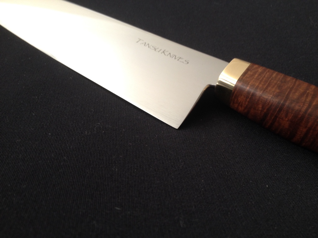

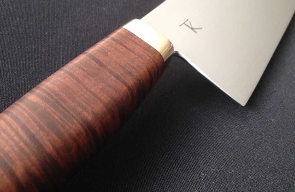

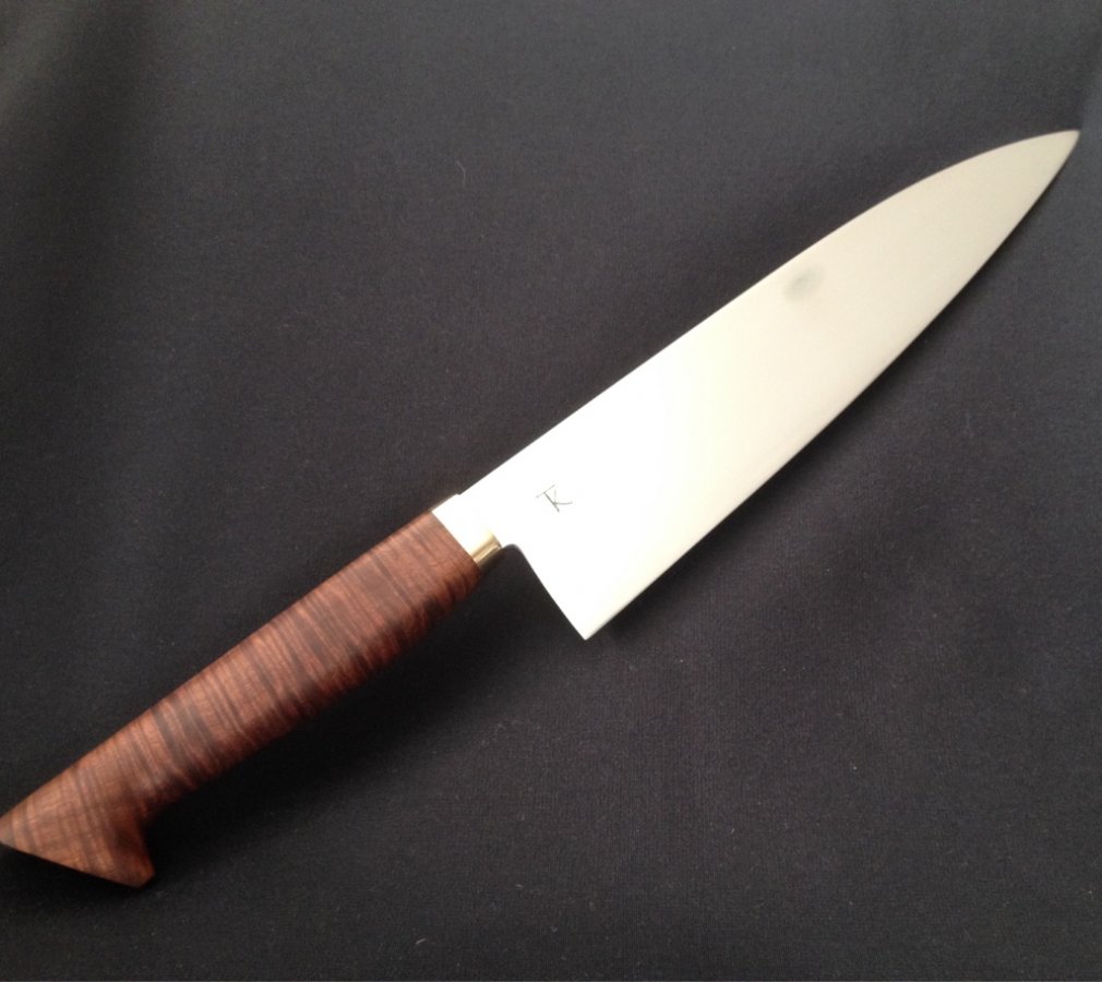

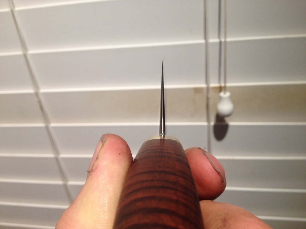

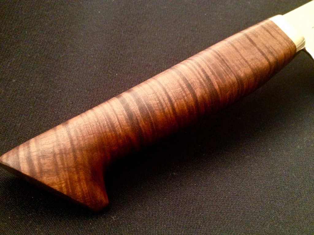

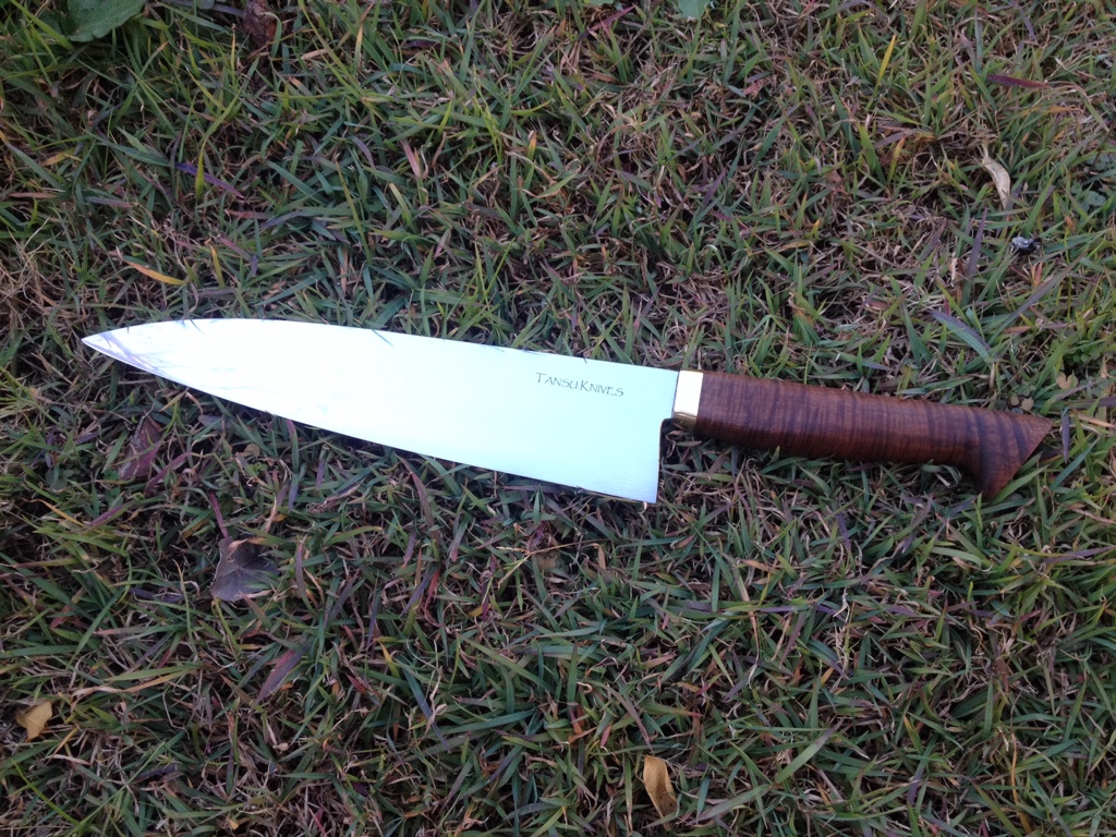

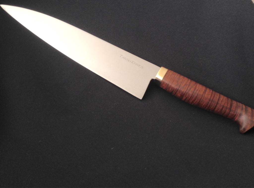

    This is a custom order I have finished recently , it's a gyuto forged from 52100 with a slight asymmetric right handed grind and good distal taper . Handle is brass and my favourite timber , ringed gidgee from Peter Cheal , the timber joint .
    It weighs 207 grams , 3.2mm thick at spine with only minor flex at the very tip ( .73mm inch before the tip ) 53.6 mm tall and flatter and pointier compared to the my usual profile . I am very happy with the way it turned out and its cutting performance. It is properly thin behind the edge

  2. Beautiful knife!

  7. Yeah, it looks great!
  8. cheflarge
    Darn sexy, sir!!! :cool1
