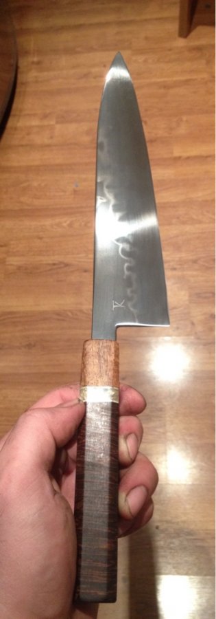

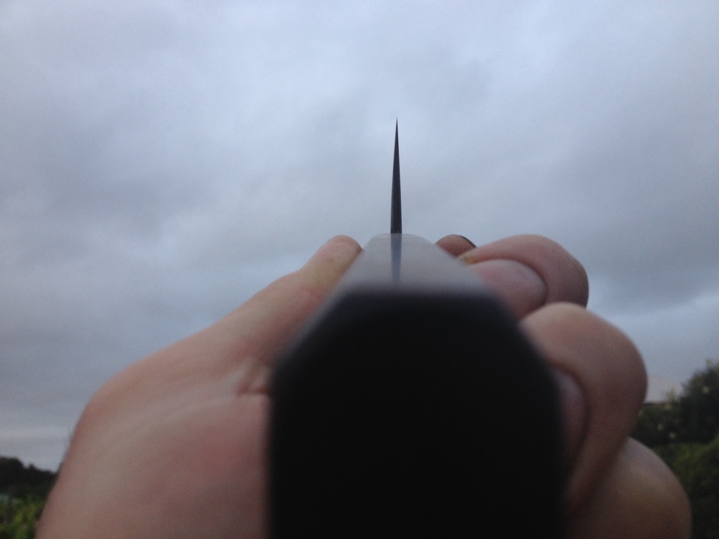

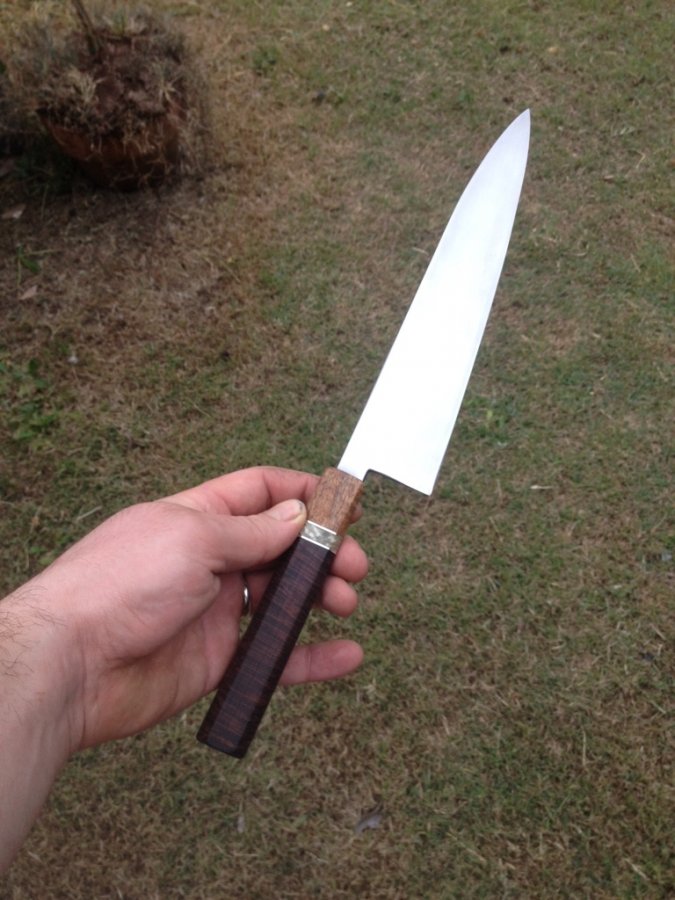

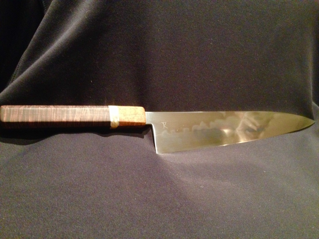

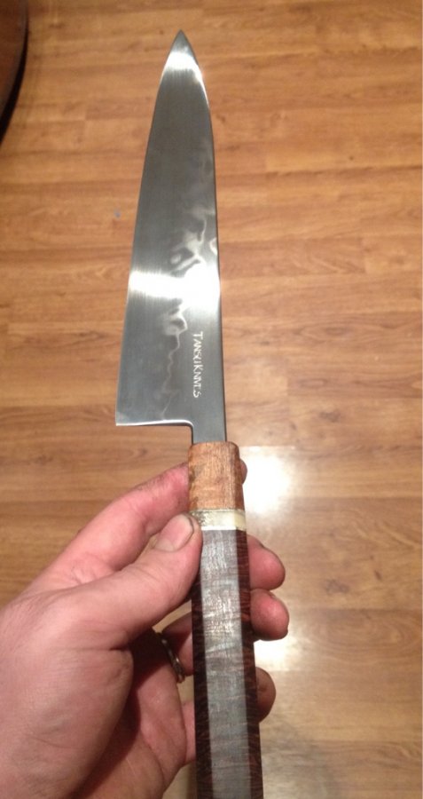

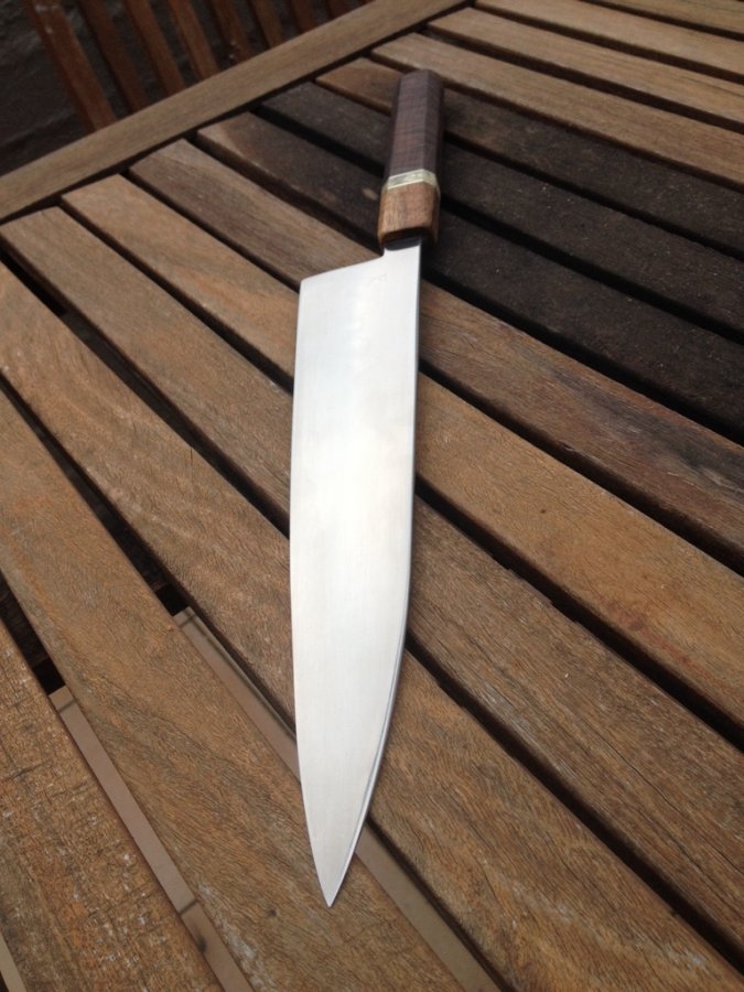

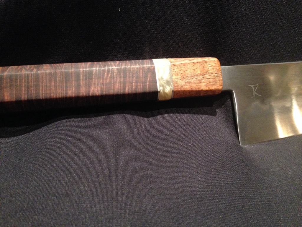

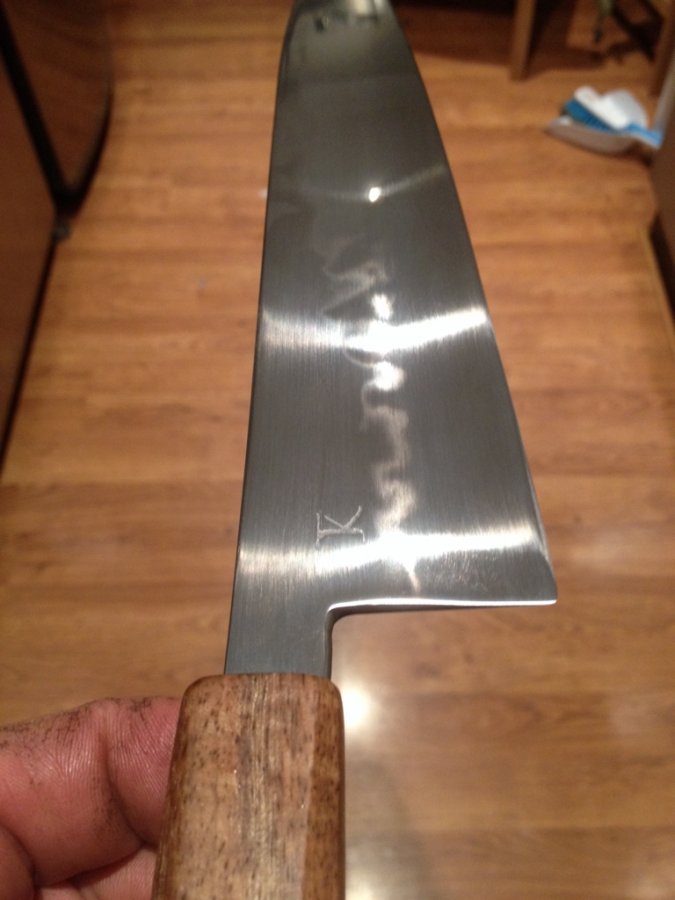

    This knife was forged some time ago and heat treated , just managed to finish it . It is forged from 1095 , differentially heat treated with clay on spine , has a good visible hamon .
    I am not big fan of copying profiles of other knives but after I was done grinding I realised it was almost identical to masamoto ks, with flat profile and 250mm length and 50mm height at the heel .
    It is slight asymmetric ground for right handed person , more like a workhorse grind with spine thickness starting from 3.6mm at the heel at tapering to 1.6mm just an inch before the tip. Very thin behind the edge and it is very good cutter . It weighs 237grams . The handle is octagonal ringed Gidgee, double nickel spacers , mango ferrule and musk ox horn spacer . Will go to auction unless someone grabs it first , Thanks for looking
    Mert
    ImageUploadedByTapatalk1444309222.942652.jpg ImageUploadedByTapatalk1444309243.088115.jpg
