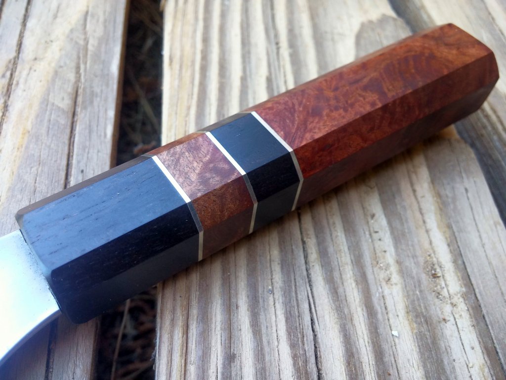

    A couple examples of the blackwood on handles.

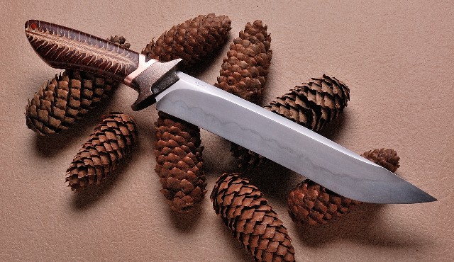

    Well, I have to bookmark Ankrom exotics and order few pen blanks from them to try. A lot of gaudy stuff, but in a good sense IMO. Loved those scales made from cones and cactuses
