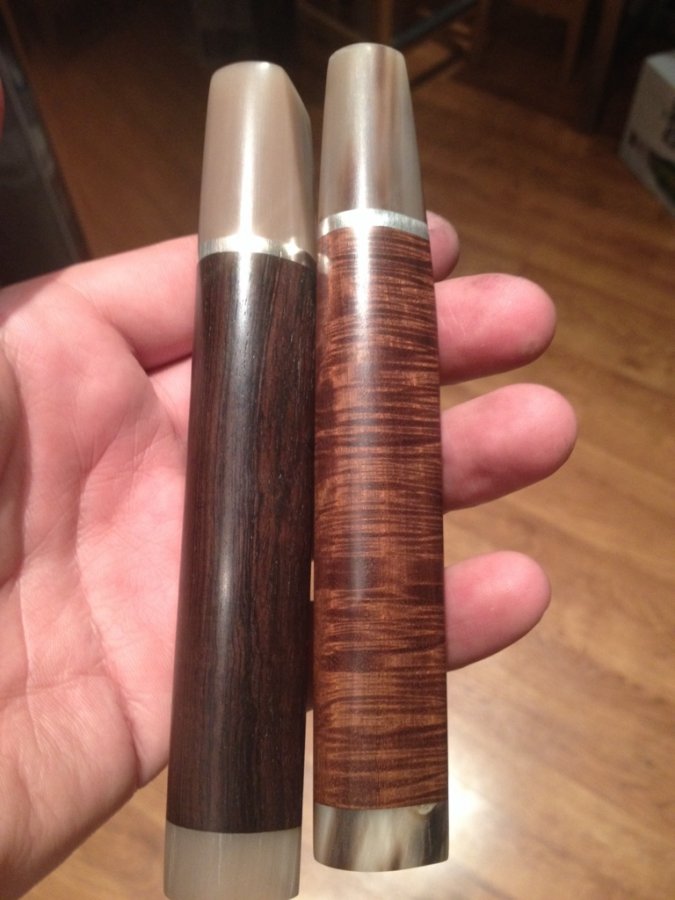

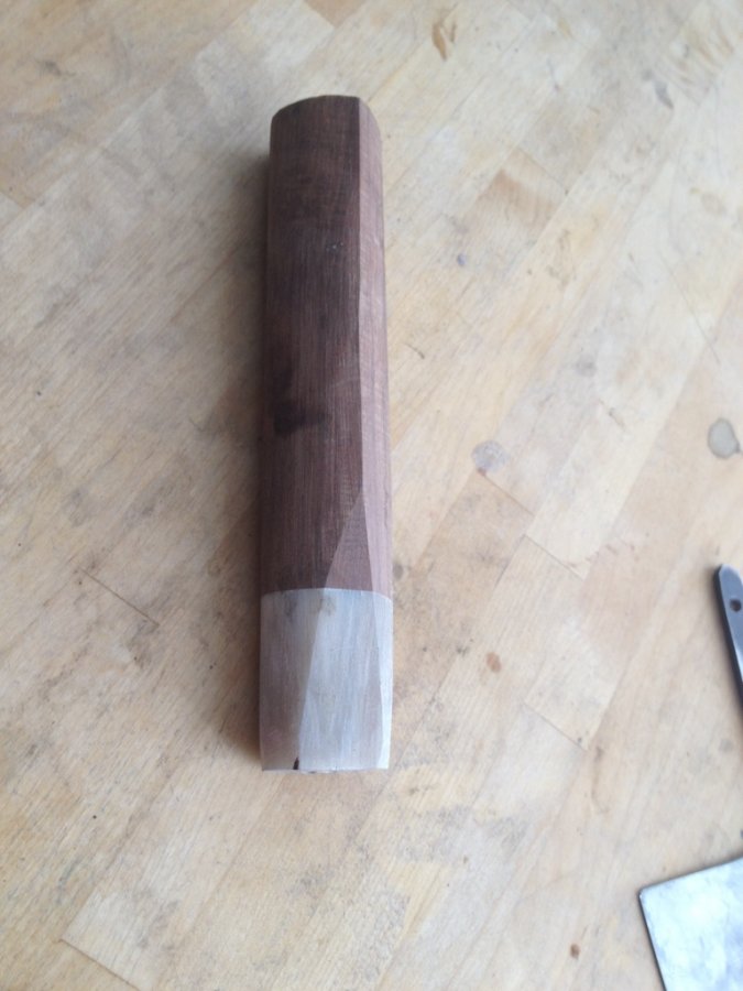

    I have made some wa handles , some more basic than the others with just ferrule and recently some with metal spacers etc.
    I shape them on grinder free hand then try to flatten them on my dmt xxc , then hand sanding and buffing . I don't have a disc sander , I am aware it will make things faster easier but it seems like I am spending 2-3 times more effort and time on them compared to my western handles and they still look not nearly half as good. And recently on top of that a wa handle I made for a friend came apart from ferrule
    I do like using wa handles and like the minimalistic approach to them . Any tips how to make them more efficient without buying more equipment ? I am about to give up making wa handled knifes altogether

    I am still really new to the whole thing but I found it infinitely less daunting to start with 1 piece handles in predictable woods like maple. I shape them on a 12 inch delta disk sander I bought used for around a hundred bucks. Chris' tutorial was incredibly helpful especially the part about using a caliper to scribe a set of # to find the center point, cut the tapers and then cut the octagonal in by making a triangle at each corner. Having the table to use as a guide to pivot off of onto the disk is far easier than anything I tried on a belt. Let me know if that makes sense but I would advocate the purchase of a disk sander.

    D style Meiji it is for me from now on I guess

    Looks nice

    Well done.
  19. Yeah, pretty cool handles. And the size seems to be just right. Love the tapering
