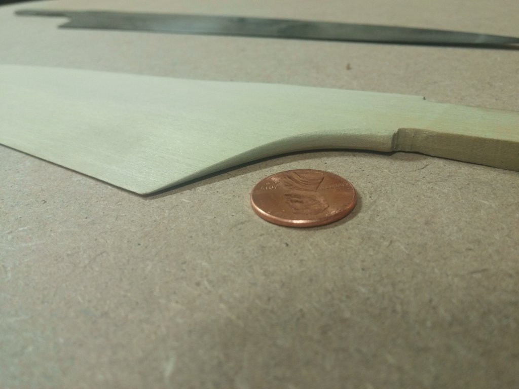

  5. This. I've never actually seen another person forge, grind, or otherwise shape a knife in person...and I like to think that developing my skills in a semi vacuum has helped me form my own style. I feel strongly enough grounded in that style now, that seeing other makers working would help me gain in efficiency, without effecting the end results. Remember, most often...our methods absolutely have an effect on the appearance of our product.
    That said, go down to your local hardware supply, and pick up some 3-4mm thick wood sheet. Cut some knife blanks out, and grind your knife. Multiple times. You will learn what angles are necessary, you will learn to control grind lines, you will learn how certain ways you would instinctively grind something absolutely WRECK other things. You can develop your own grind...and even though you can't test them, when the time comes that you make them from steel, you'll know precisely what you need to do...because you'll have done it dozens of times for pennies on the dollar of what it would have cost you in steel.
    I was actually going to PM Anton about helping him out by heat treating bar stock...if we can find a feasible way to do it with the distance :).
    This is basswood. Note there is no burned wood, it has a clean feather edge, rounded spine and choil...if this were steel, it would cut like...well, Anton's knife I just finished!

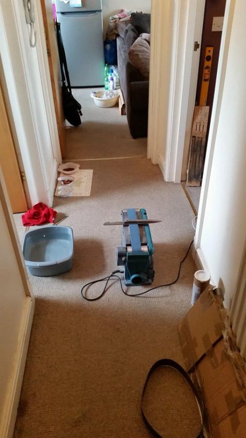

  9. The pictures are awesome, Greg, so even such a dumb person as me could get it. Thanks a ton. This is a final grinding being made on a hardened blade, right?
    … but I think you were cheating a little bit there and moved your grinder out of the bathroom.
  10. Nice Greg!! I also spy a soft backing on your platen!! Is it cork or leather?
  11. BathonUk
    BathonUk Founding Member
    You are right Anton that I was cheating. I was hand sanding my blade and I have found few very deep scratches which looked like impossible to remove, so I quickly put my belt grinder on the floor in the main corridor and quickly ground it. Sometimes I am doing that when I am lazy.
    Cris I just super glued piece of cork to my platen. Gosh, I wish I had proper grinder. Faster I mean... Mine is doing only 400RPM.
  12. Nice!! The cork is brilliant. I use a piece of 2oz leather :D.
    On the grinder, I lower mine down quite a bit for doing what you're doing in the video...perhaps 10% speed (340-400rpm), so you're probably not far off in regards to speed for the work you're doing. That said, I also wet grind my blades, so I do have a bit of advantage there :D.
