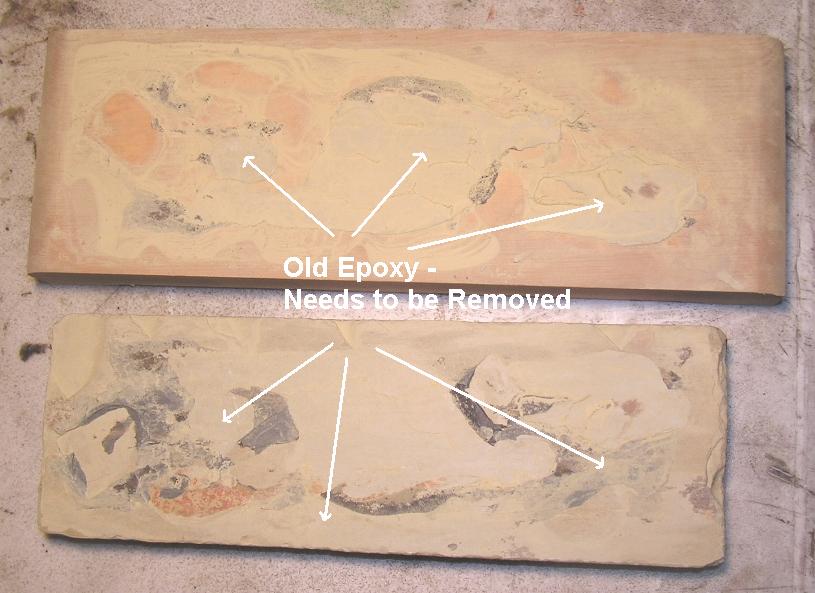

    In the below tutorial I'm showing a natural stone that has come loose from it's factory mounted base & needs to get some repair time on the bench. In this case we have an uneven natural stone bottom and hunks of epoxy to deal with.
    I decided to use my disc grinder to clean up the stone & base because it makes things go real fast - real quick. You could use a wide belt grinder or even some sandpaper if you had too, although myself, I'd rather buy a new stone than use the sandpaper method. [​IMG]
    Now you should have both base & stone reasonably flat. As you can see on this natural stone there are depressions remaining after cleaning it up and that's OK because the bottom only needs to be "flat enough", it doesn't need to be engineers dead ass flat for this to work. Plus, these little depressions will hold more epoxy which can't be a bad thing, right?
