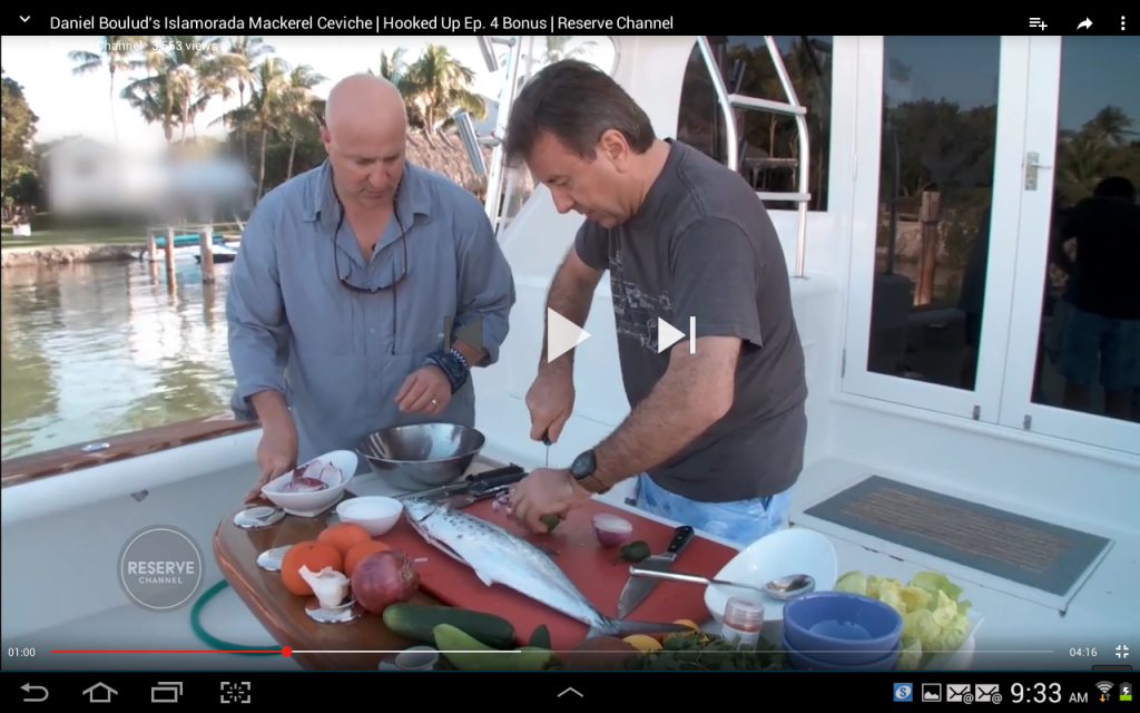

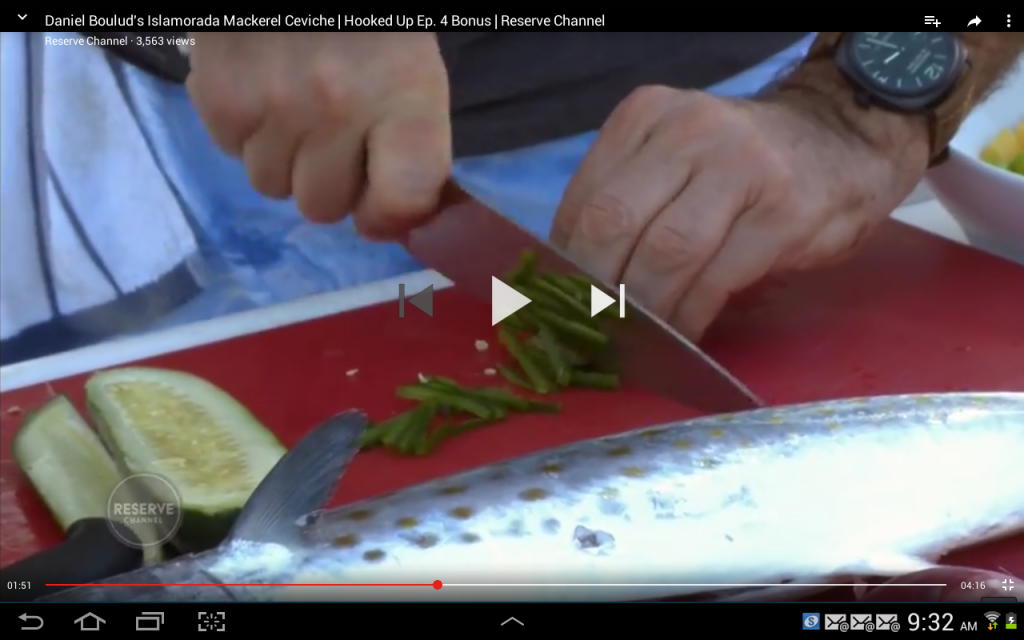

  4. image.png The way a chef holds a knife is entirely personal. There is no correct way. That's part of how they choose a blade; by its comfort in their hand. Here are a couple of guys and how they hold their knives to cut. I'm not sure even a 130mm handle would be enough for them.
  5. marc4pt0

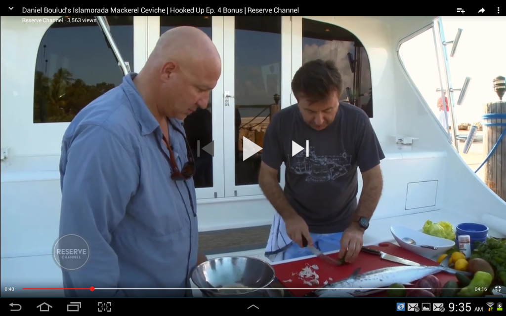

    Different knives different ways to hold them. Seeing the pic above is a perfect example of this. Both chefs are using smaller slicing style knives to slice. Sometimes I place my finger along the spine when in the same scenario. But give chef Daniel a gyuto to work with and you'll see him use a pinch grip:
    And then you'll see him switch his grip style at least twice for different tasks during this same video.
  6. marc4pt0
    Here's a link to the above mentioned video:
  7. It's actually not the style of knife that dictates how he holds it. It's the cutting motion. When he does a rocker chopping motion, he holds the knife in the pinch grip. However, when he does a Pull slice or chop with the scimiter, he uses the scalpel grip with the index finger on the spine.
    I just saw the other stills. Exactly my point. Different grips for different tasks and motions. Therefore different handle lengths for optimum comfort and control.

  14. I would be curious what makes you think it's the motion dictating his grip style here? I'm not saying you're wrong...I'm just curious. In my opinion, it would more be the heel height of the knife. Hard to pinch grip a blade that's going to take off a section of your index finger if your hand moves to get comfortable.
    Definitely agree here.

  16. Just commenting on what is shown in the video. What would make my point (which we don't have here) is him using the chef knife in a pull slicing motion and how he holds a wider blade, but uses it like a narrower slicer. However, a skilled chef wants to slice something, he reaches for the narrower slicer reflexively if it is handy and keeps his fingers positioned away from the cutting edge. If he wants to rocker chop, he reaches for the chef knife reflexively and holds it in a pinch grip if that's his comfort/training.
