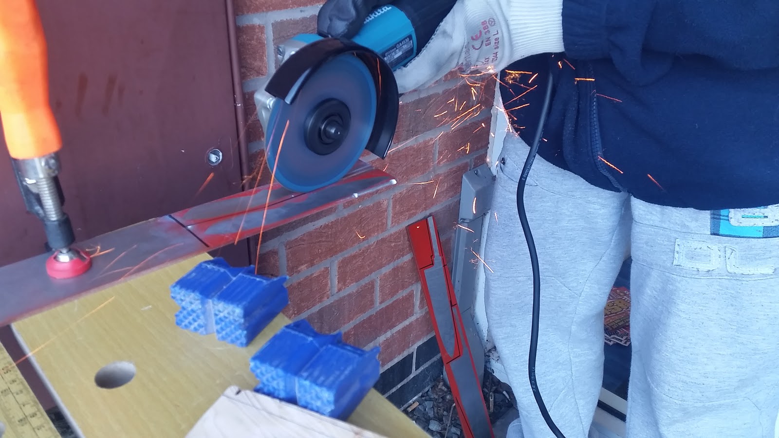

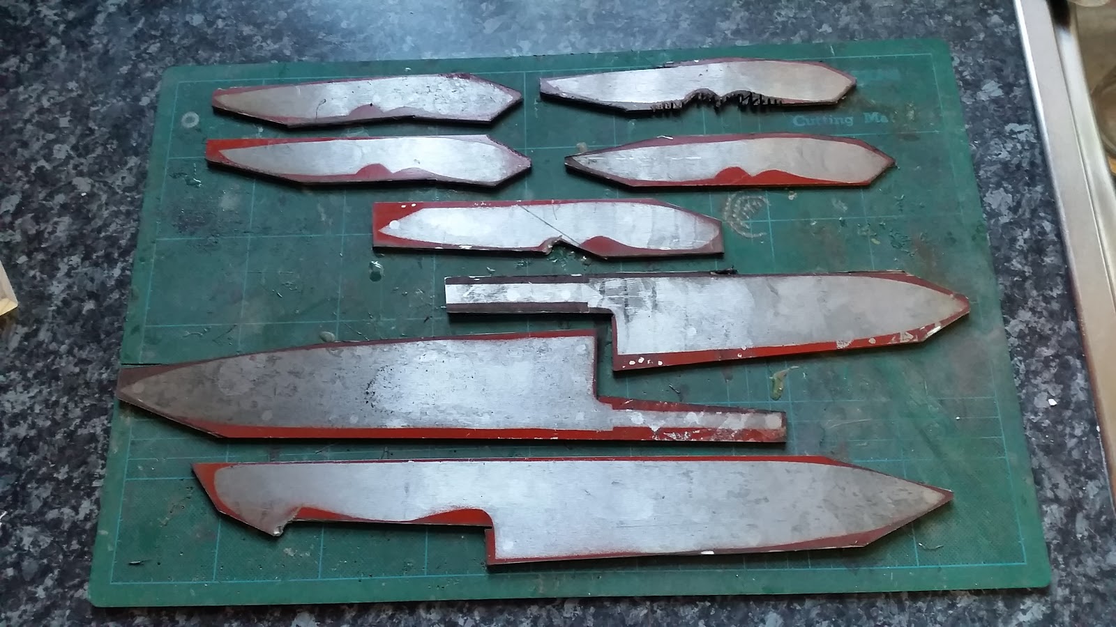

    No mate. I bought some steel, cut out everything and then started working. Some pictures:
    Cutting out in front of my block:
