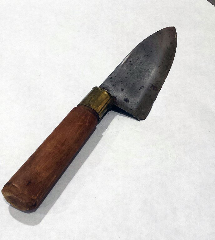

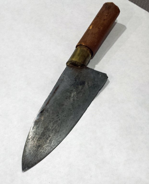

    This little guy showed up in the mail a couple of days ago. A young man had posted about it at the B&B and explained how it was at least his grandmothers if not his great grandmothers. I of course offered to give it a lick.
    He wanted the ability to use the knife without loosing all of its "heritage" or character.
    There is very little left of the Ura but I think I can get the chips out except for the heel.
    Any info on the maker or suggestions for where to start?

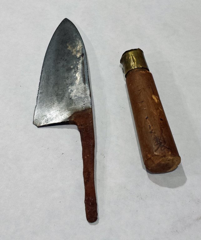

  3. Lefty
    For the blade, you can soak it in Break Free CLP, but the tang makes me a bit nervous. How deep is the rust on that part?
    For the handle, I'd just reuse the old one, but push the ferrule back on, and use a good epoxy. Before doing that, I'd sand the wood down, and get rid of the huge marks, while leaving some of the old ones. Then, a nice mineral oil soak, and light sanding, with a beeswax buff, and you should be good to go.

    Bill Farrell Founding Member
    Between sandpaper and a scotchbrite belt, I think I'd go with the belt for this blade. There already appear to be grind marks going from spine to edge, so you wouldn't be altering the personality of the blade. The belt could also do a lot for the rust on the tang, though I agree with Tom that you'll eventually want to put a chemical on there of some sort.
  7. Jim
    The tang looks worse than it is, pretty solid. I will wire brush it and retake some photos after the rough sanding.
  8. MattS
    Dremel makes a little paddle brush that works great and leaves less scratching than a wire brush.

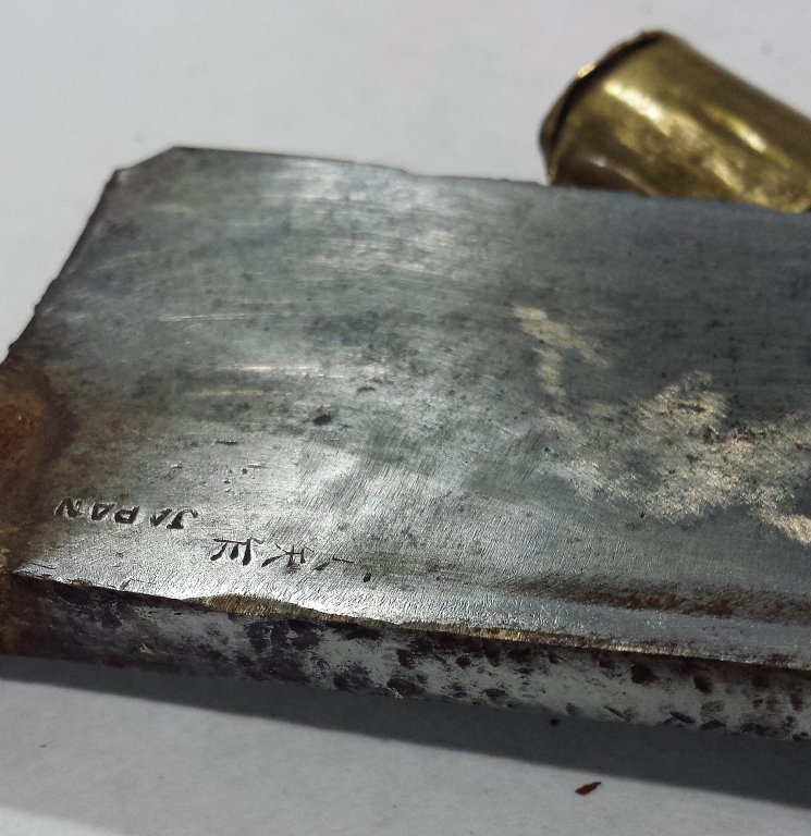

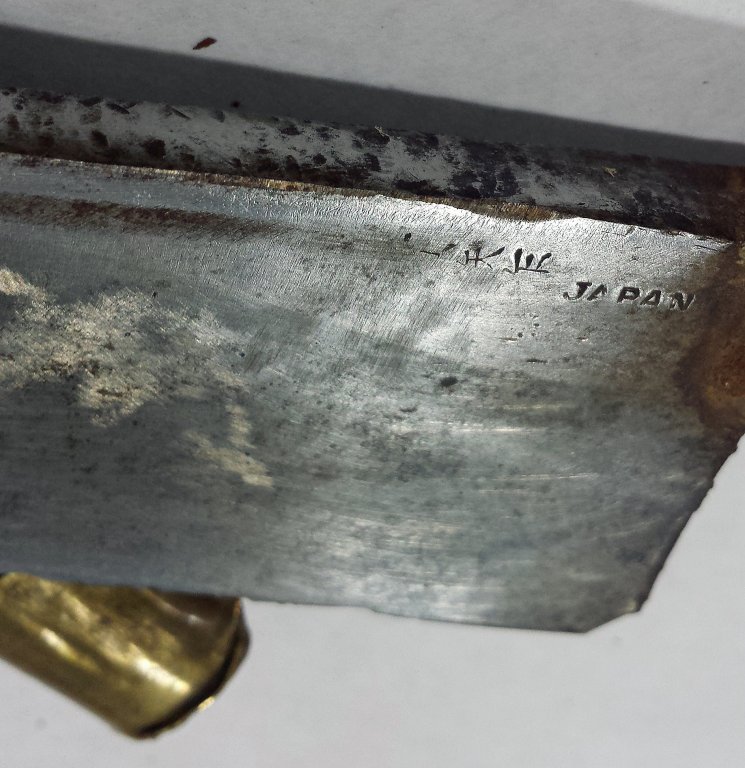

  9. kentos
    kentos Founding Member
    It's says "???" "ten" "saku", where "ten" is the character for heaven, and "saku" is the character for made/work/design.
  10. kentos
    On looking closer the left side of the second character looks like it had a stroke lapped off maybe? If so it changes the meaning of that character. It could read "ya" meaning arrow.
  11. Stumblinman
    Stumblinman Founding Member
    Is that kanji down the side of the handle ?
  12. Jim
    Yes, very hard to make out.
    Thanks Kent for the translation attempt.
  13. Jim
    I have the brass sleeve off the handle and have the handle glued up to stabilize the cracks I found under it.
