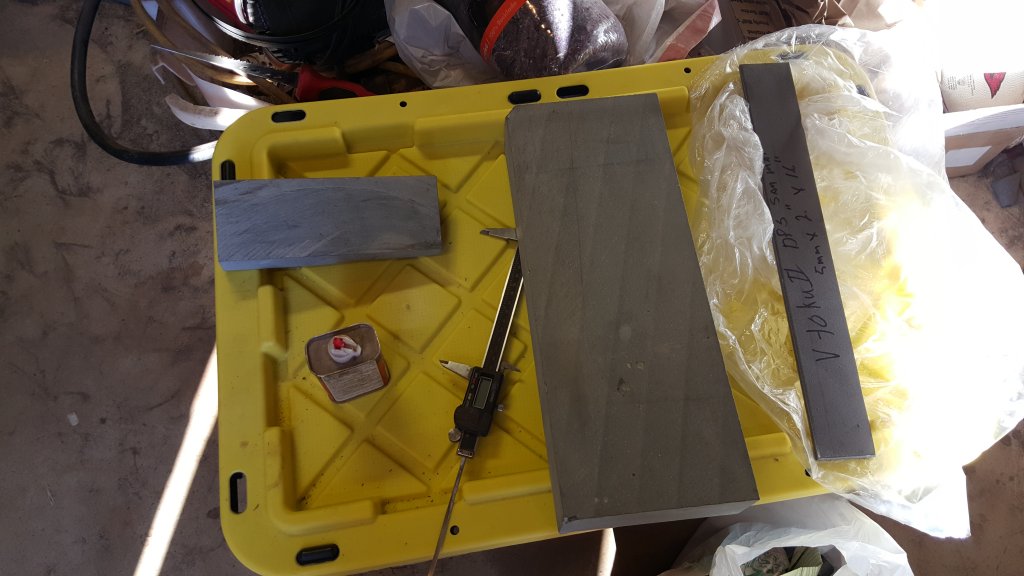

    As delivered on the right.

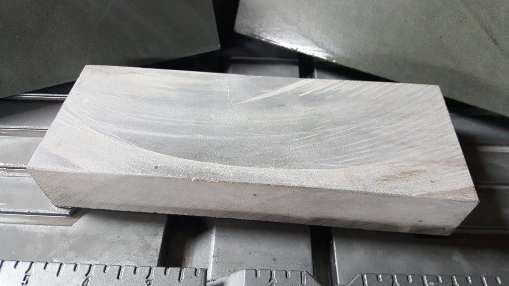

    Cut into roughly 8" x 2.25" x 1" slabs.

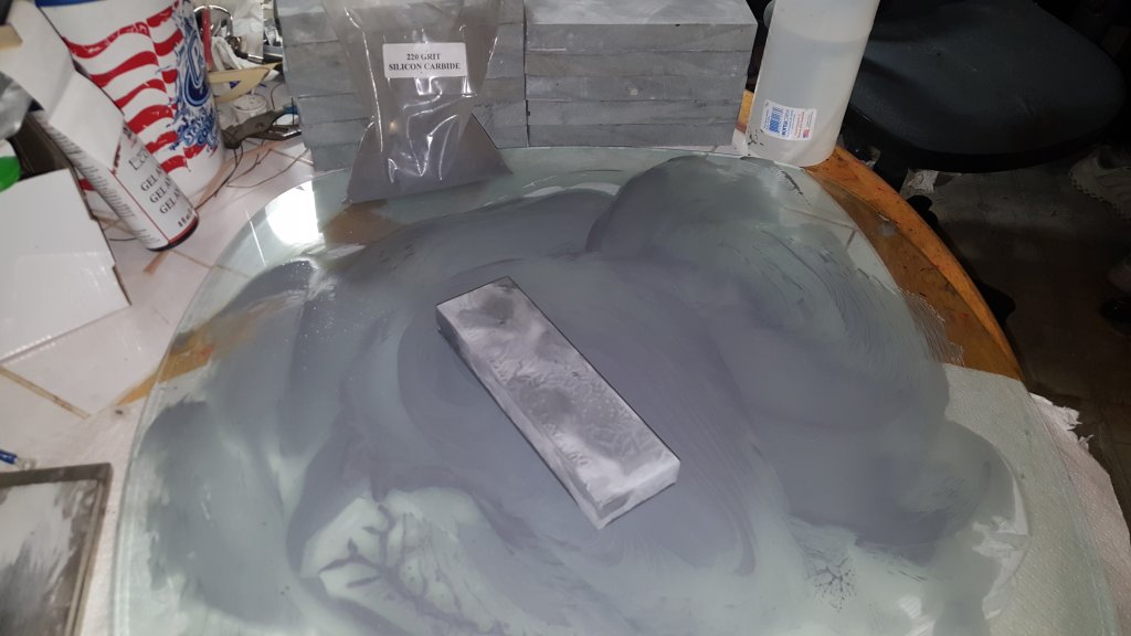

    Where they start pre-finishing.

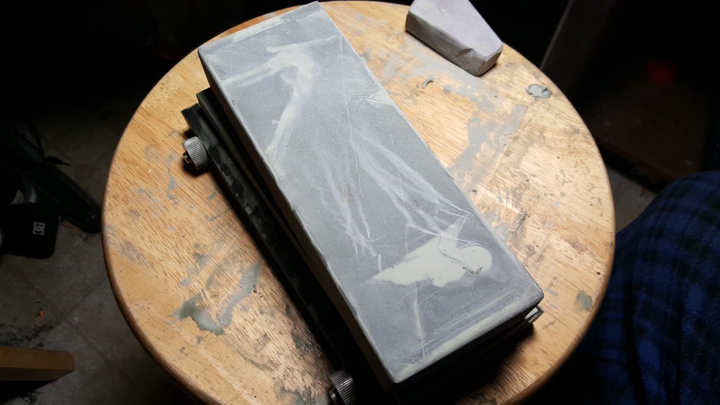

    A finished out stone.
    Now, the things never need flattening, ever lol. But I do like to 'freshen' the surface with another stone on occasion, and when I do I tend to just leave the slurry (which is NOT from this stone lol) as you can see there. Mostly it's because I'm lazy and it has no noticeable effect on the edge, either positive or negative.

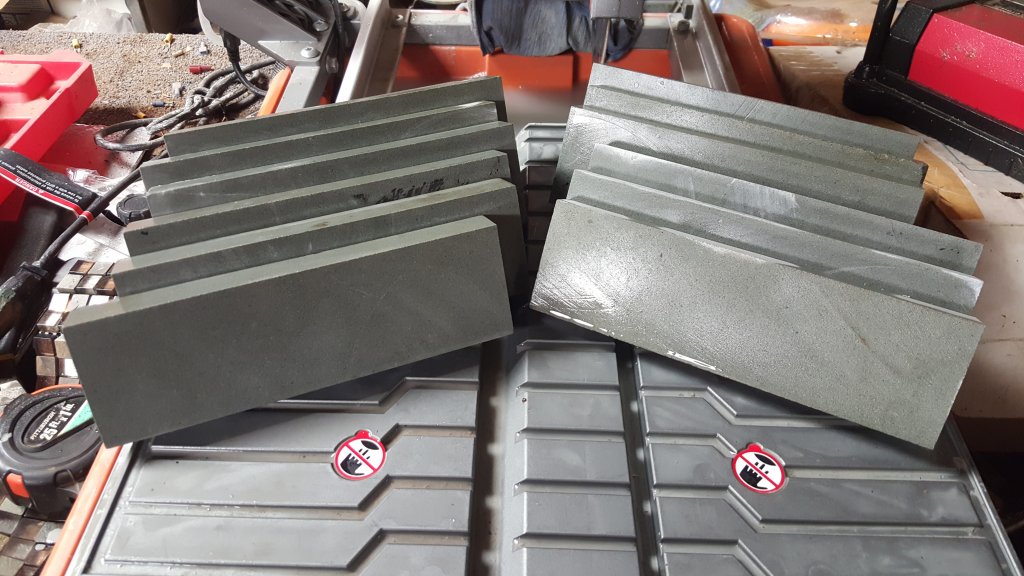

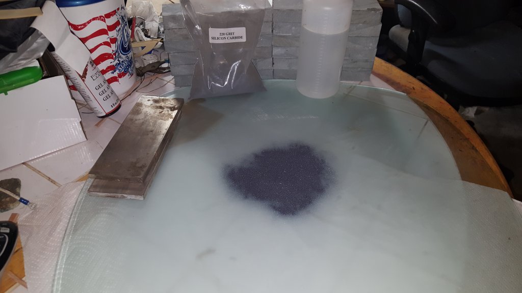

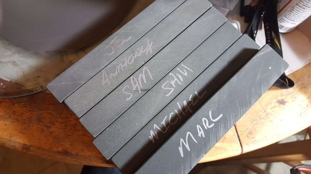

    All the stones I've gotten flattened and conditioned since yesterday, lol. Messy, messy work!
