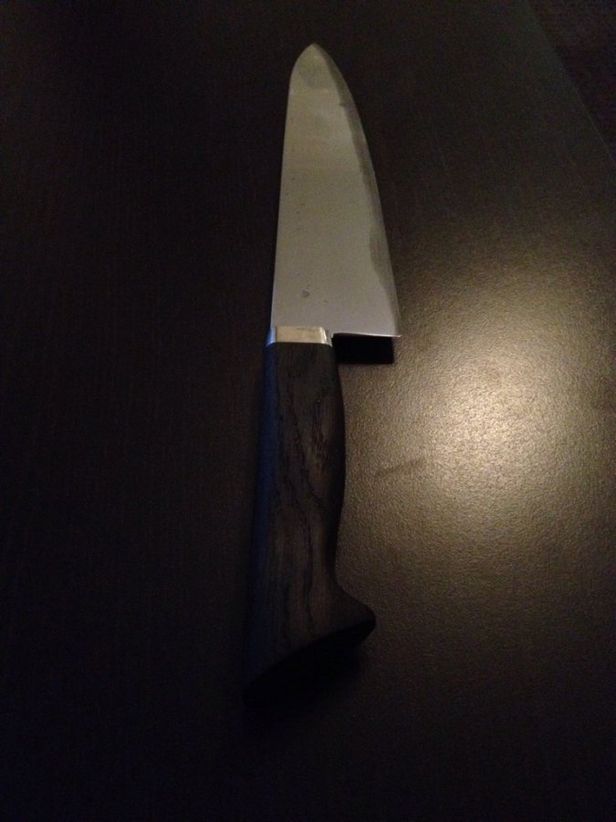

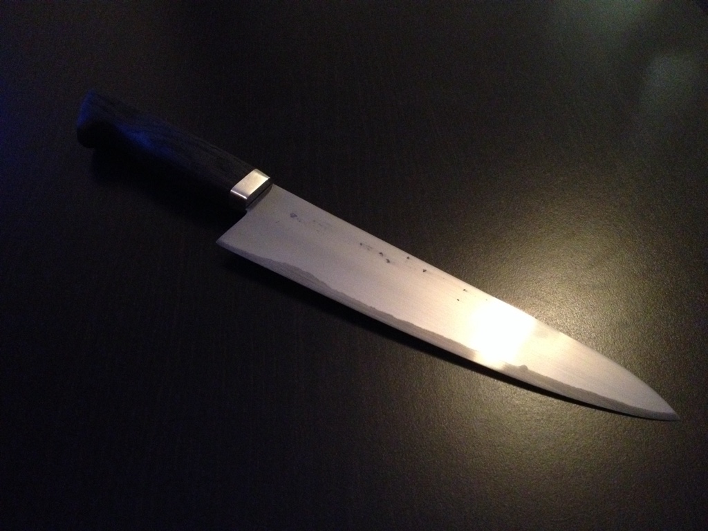

    I have never been a fan of rehandles or knife modifications and tried to stay away from them, firstly I knew the effort going into them would be as much as making a knife from scratch, secondly most good potential knives were already converted and readily available... Until I decided to buy a tadafusa 210 stainless clad gyuto in blue 2 ( my favourite steel after 52100)
    For what I have paid it was great but it came as expected , very sharp spine , choil , grind meant for lefties , wayy spine , very cheap handle that was mounted on an angle and not so good cutting ability which was the most concerning one .

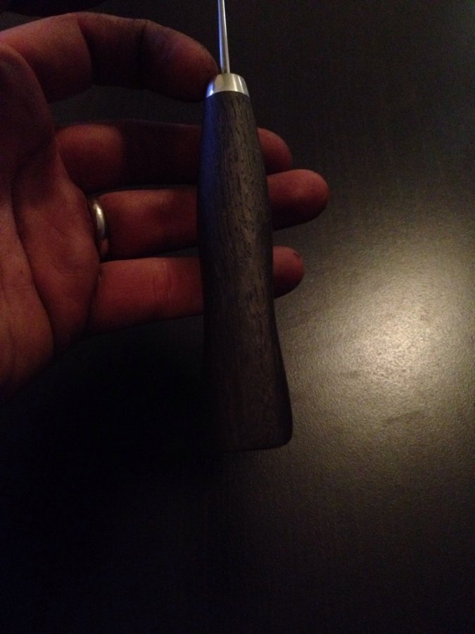

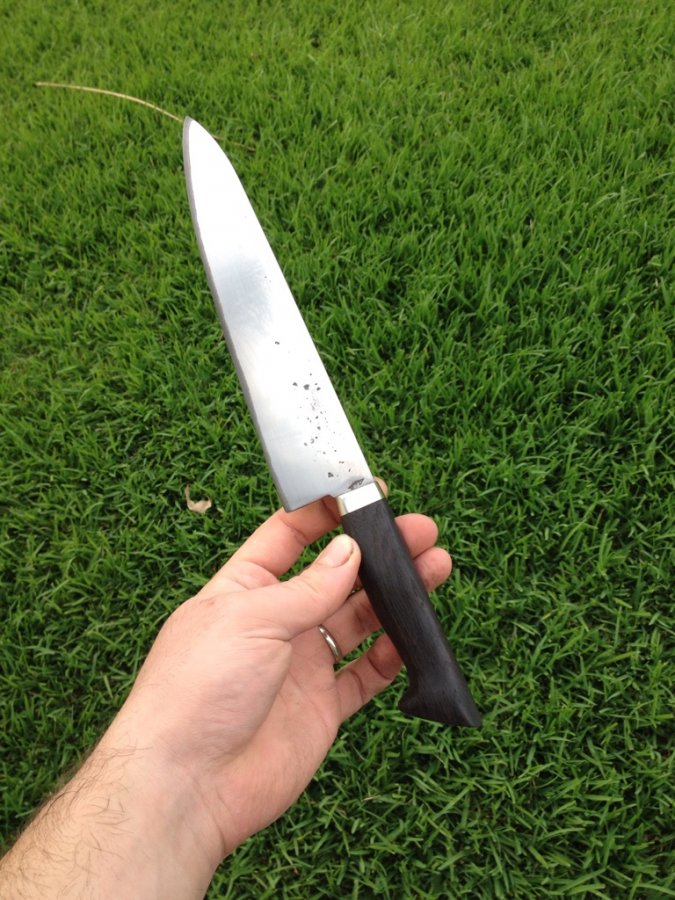

    I have decided to modify it to my taste converting from wa to one of my hidden tang handles . Handle material is 2000yo bog oak and nickel bolster .

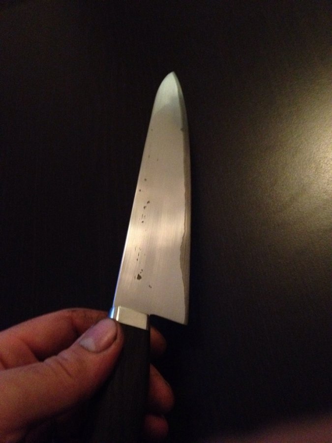

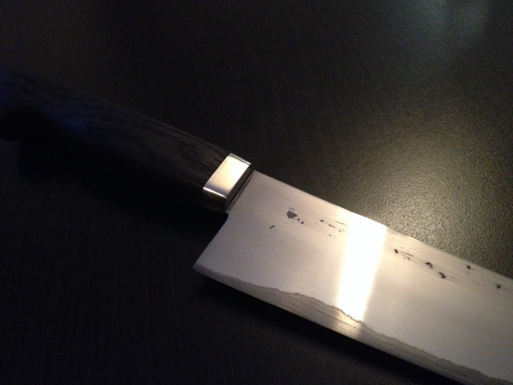

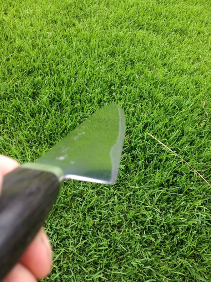

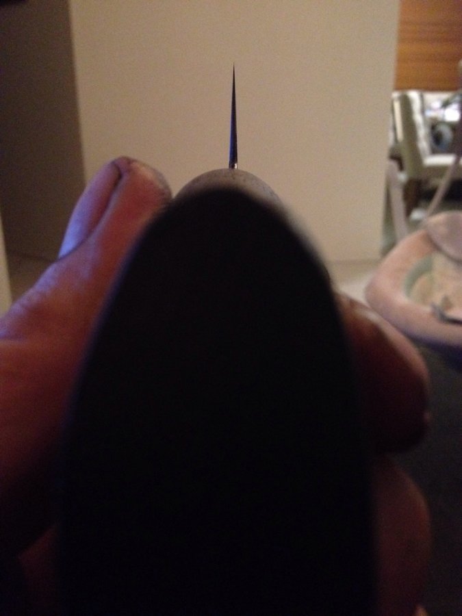

    I have reground the blade giving a proper bevel on the right side and hand finished the blade up to 1500grit sandpaper. Flattened the spine , reprofiled the knife , Rounded spine and choil . Finally gave a quick etch to create a better contrast with core steel to stainless cladding .
    Finally took it to stones and did my usual cutting tests which it performed better than some knives few times it's worth Overall I am very happy with knife and the way it cuts and feels .
    However this is not a service I will be offering , as I said if had spend another 2 hours I would have done a knife same size from scratch . Thanks for looking , this one will be heading to auction , feel free to ask any questions you may have

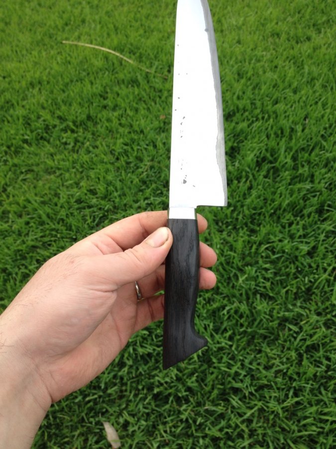

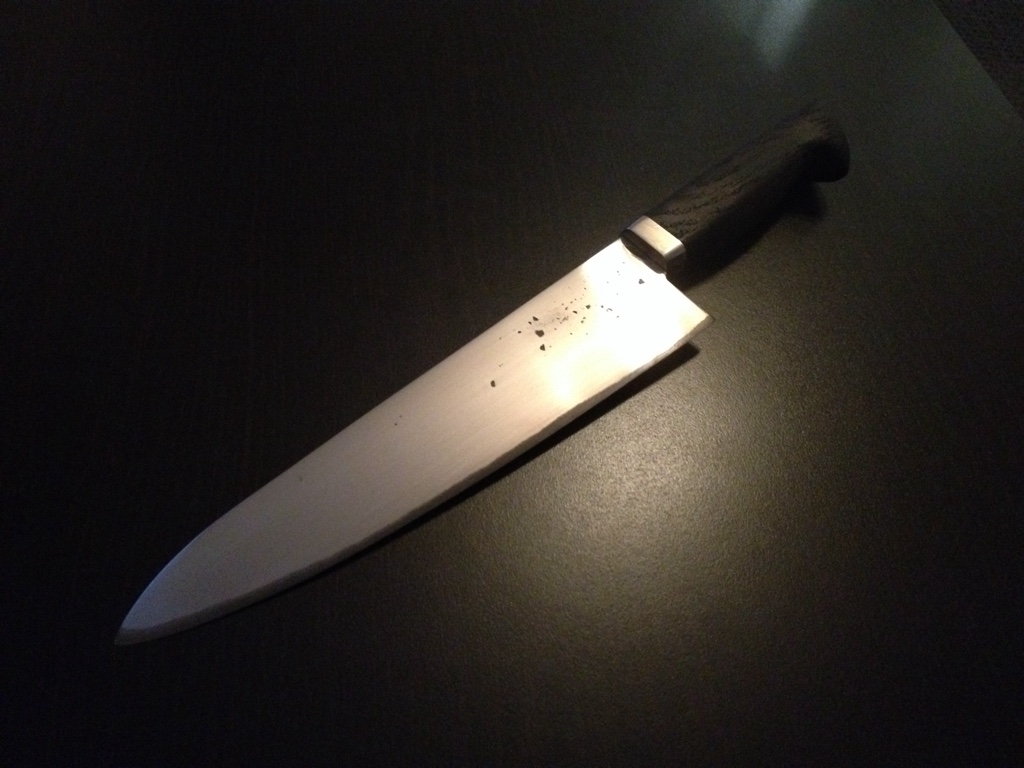

    More pics
  18. The handle materials really suit the blade Mert
  19. chefcomesback
    Thanks Alex , the cutting performance is quite impressive I have to add it
