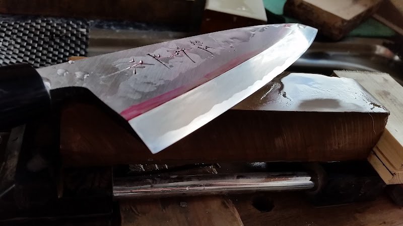

    Let's keep going. Last Friday I worked a little bit more on the blade road. Fingers on shinogi line like before and pressure only on move forward .
    Then I started sharpening the edge. This time my fingers were placed over the edge (as close to the edge as possible) and my pressure was directed backwards.
    You should also remember about using the whole stone. I have a problems with using some points on the stone. You can draw the net with pencil on the stone. This will show you places on the stone which are not used.
    Now everything look like this. I think that it is quite even. I also removed unwanted cutting edge.
    You can clearly see the burr.
    I didn't want to sharpen or polish this knife today. There will be time for that later on. I just wanted to see how this steel behave on the stones.

    After sharpening the blade road and the edge you must connect these two angles. To do that place your fingers between shinogi line and the edge and use pressure only on move forward. Also with every move lift knife a little bit to round whole bevel. If you do that properly your will get hamaguriba edge.
    At that point I finished sharpening and polishing on Red Aoto. It is not the time to properly sharpen and polish the blade. To make the finish even I used Red Aoto mud. Do not waste mud from your stones. When you flattening them collect mud and put it to jar or some container. You will be able to use it later on.
    One can use champagne cork or ultra hard felt to polish.
    And this is effect. It took me 2 minutes. You can spend more time to remove all vertical scratched and create horizontal ones. I will work on the bevel even more so I decide to leave it as it is.
