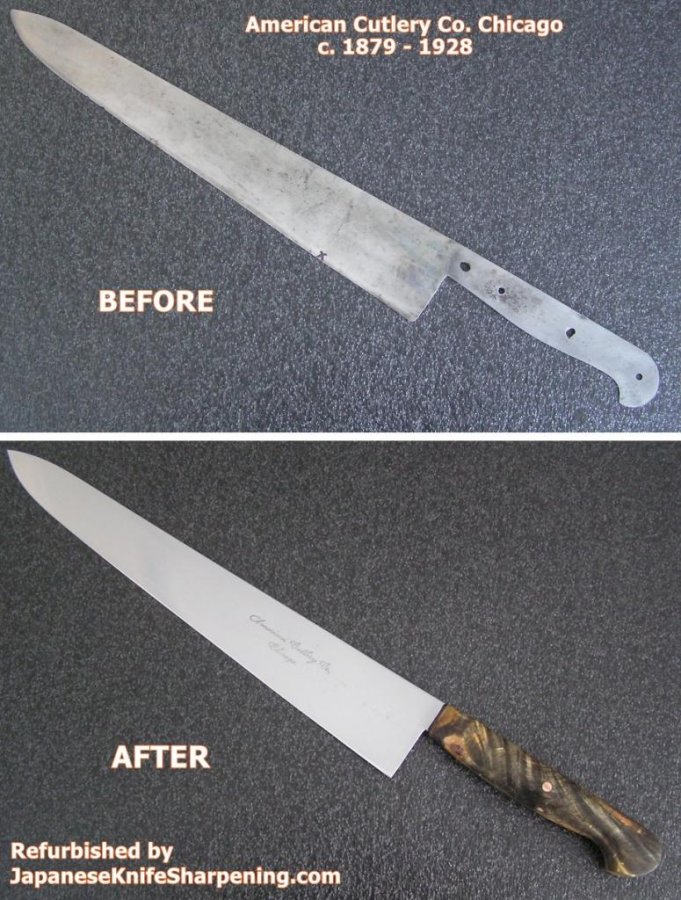

    Speaks for itself.
  10. Yes #6 it certainly does!
    I had problems getting the cracks in the scales to show up, taking photos with the cell phone. So, dusted with a little Wondra.
    In the middle photo, there is a large blob of flour. That is a burn in the scale. Ten years or so ago "persons unknown" laid the knife down on top of the stove during Thanksgiving dinner. We have a small older commercial stove. The entire top is a cast iron grate, which gets hot. Really hot especially if the oven is on. I suspect that burn and the heat is what caused the plastic to fail.
    The bottom photo shows the worst part of the wear to the blade.
