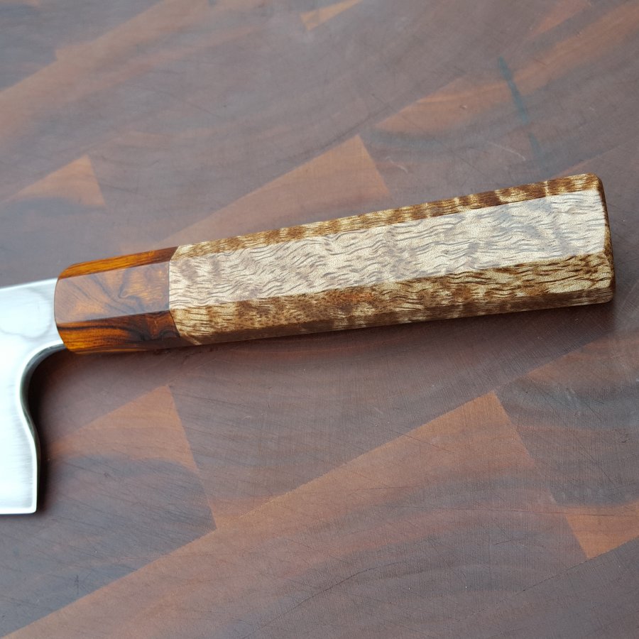

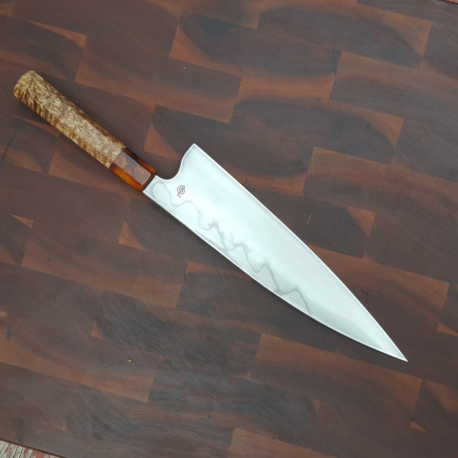

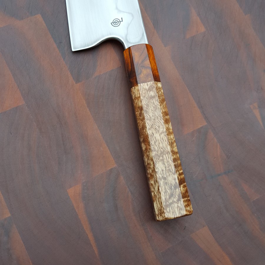

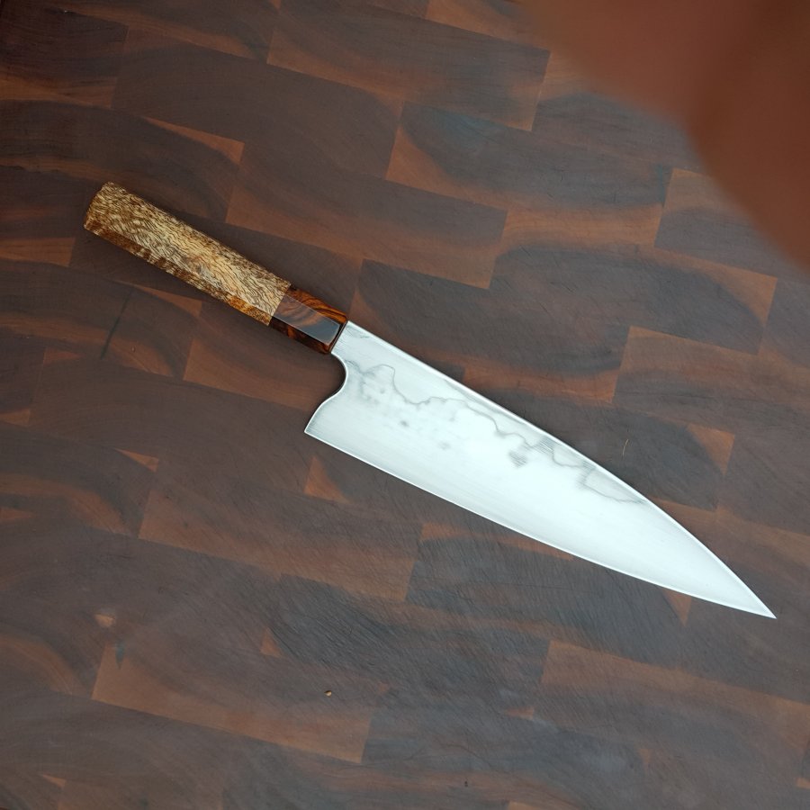

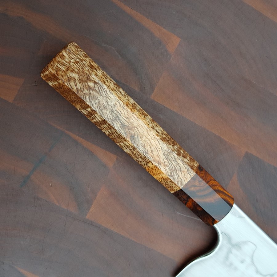

W2 @250mm wearing Curly Mango and Ironwood
