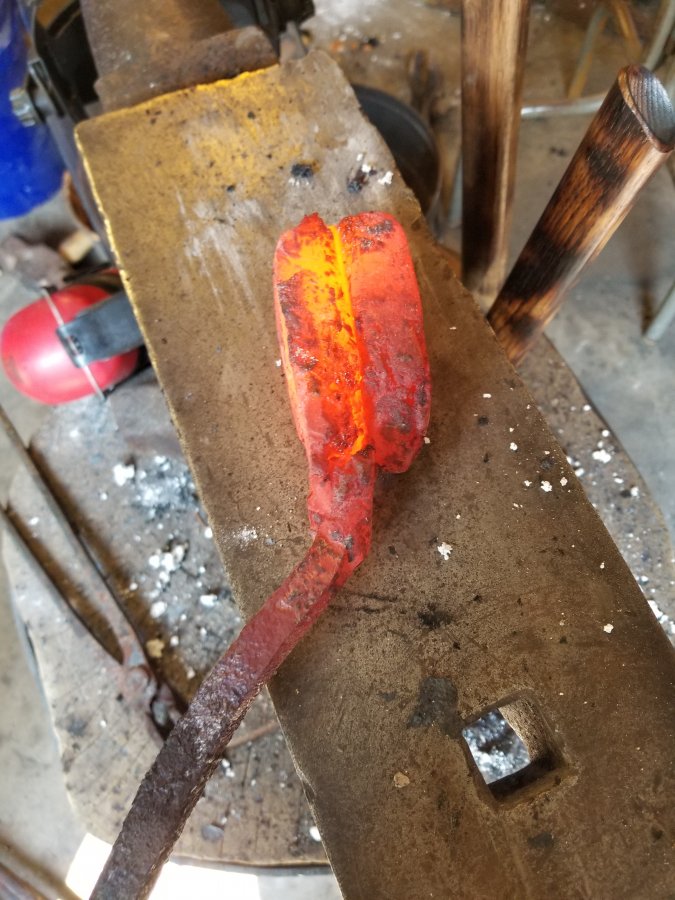

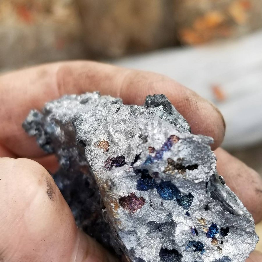

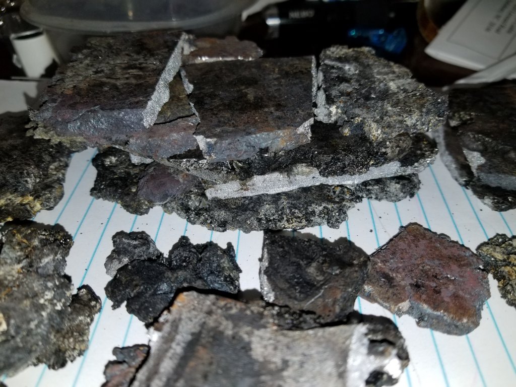

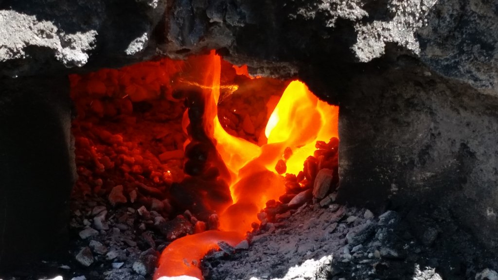

    I am a part time bladesmith (husband and father of 3 children ages 5 and under) practicing in many areas of steel creation. I am a bladesmith, but i am also an adept in iron smelting with smelt master Mark Green. 5 years of smelting iron ore we have mined into iron or steel. Some 60 full smelts under my belt. Most product goes to my good friend for his traditional sword production, but i have earned quite a bit for jacket material in future sanmai.

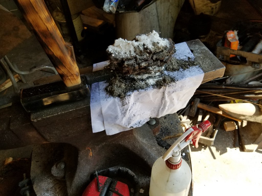

    I am also adept in the process of steel making most commonly used by Japanese Swordsmiths called Orishigane. The remelting of clean iron or low carbon steel into ultra high carbon steel that must be wrought to homogenize carbon content and remove impurities from the steel. I make steels in the 1.3-1.9% C range. I have been working this type of steel into plates and then billets for future nihonto inspired blades and even kitchen knives.
    IMG_20170630_215437_106.jpg IMG_20170628_192632_766.jpg 20170910_145917.jpg 20170923_114119.jpg 20170923_123534.jpg 20170923_124201.jpg

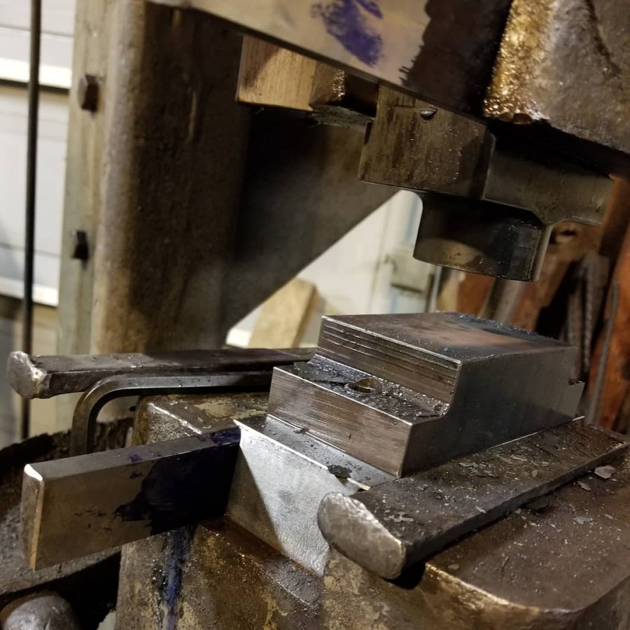

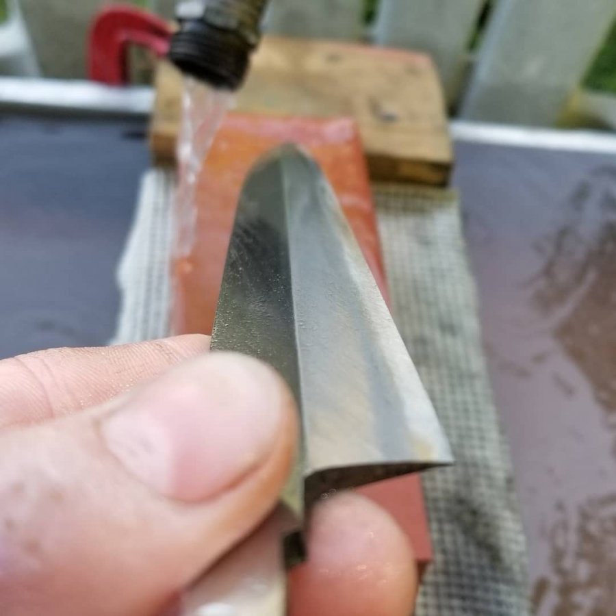

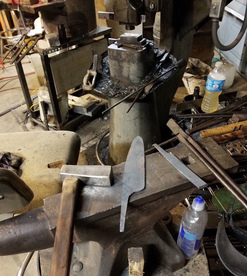

    I have some sanmai Gyuto using core steel i have made from Orishigane. Probably in the 1.2% range after 5 folds. If it survives it will be available.
    Kitchen knives using sanmai construction is my main study. I have spent years lear ing traditional steel making methods, but have also spent several years practicing the craft of sanmai construction using low carbon jacket material under my powerhammer that has been set up to mimic the shops and spring hammers you see being used in Japan.

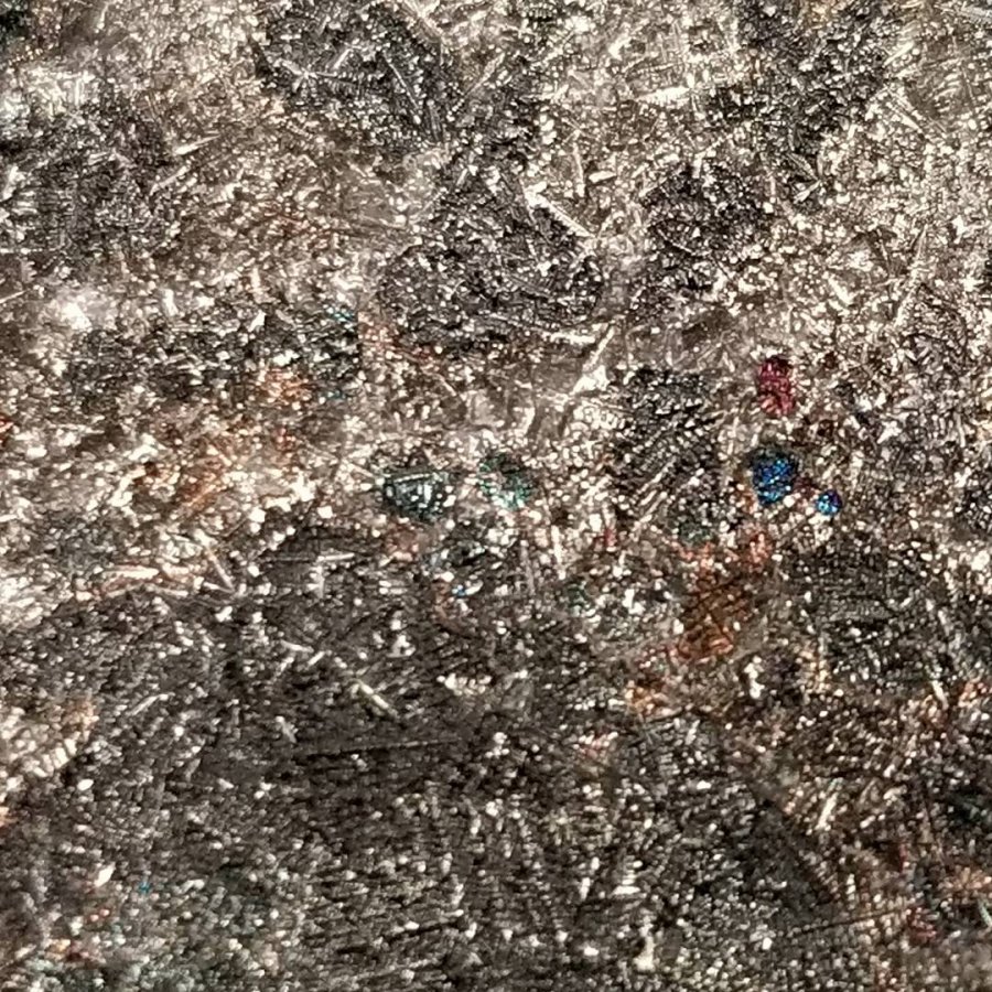

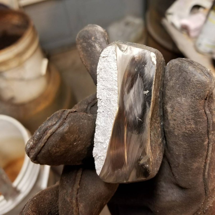

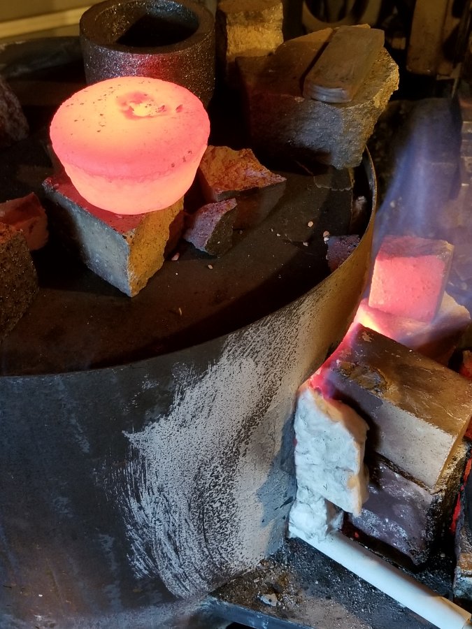

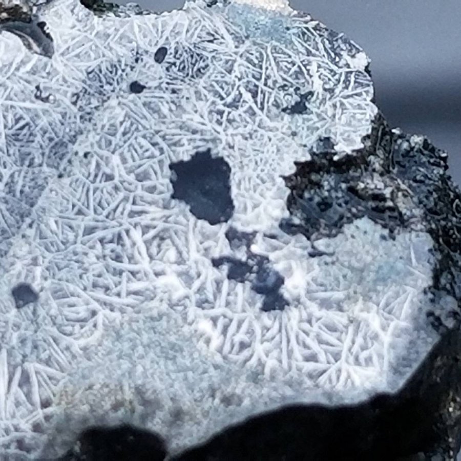

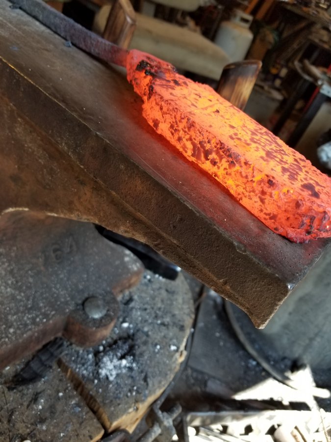

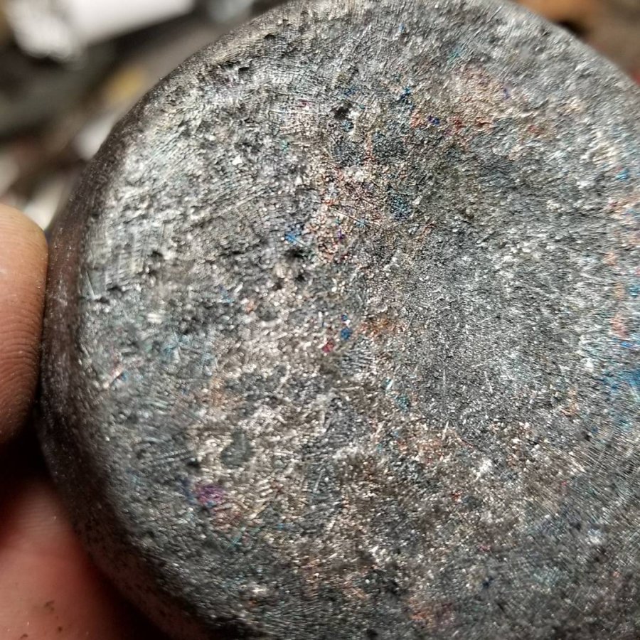

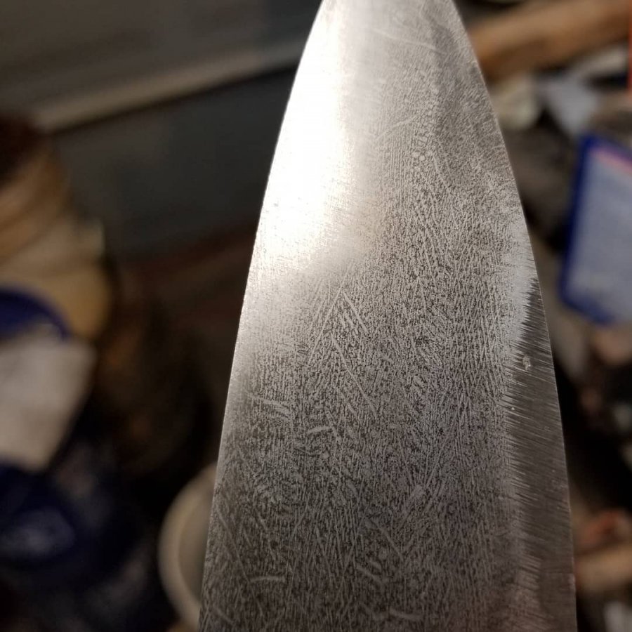

    As of recent in the past year, i have starting pushing into crucible steel/wootz creation. I make ultra high carbon crucible steel and now have that as an available steel source for "different" monosteel kitchen knives. The last picture is of a "dendritic" blade as opposed to a watered wootz blade. In time however and you will see water pattern coming from my shop.

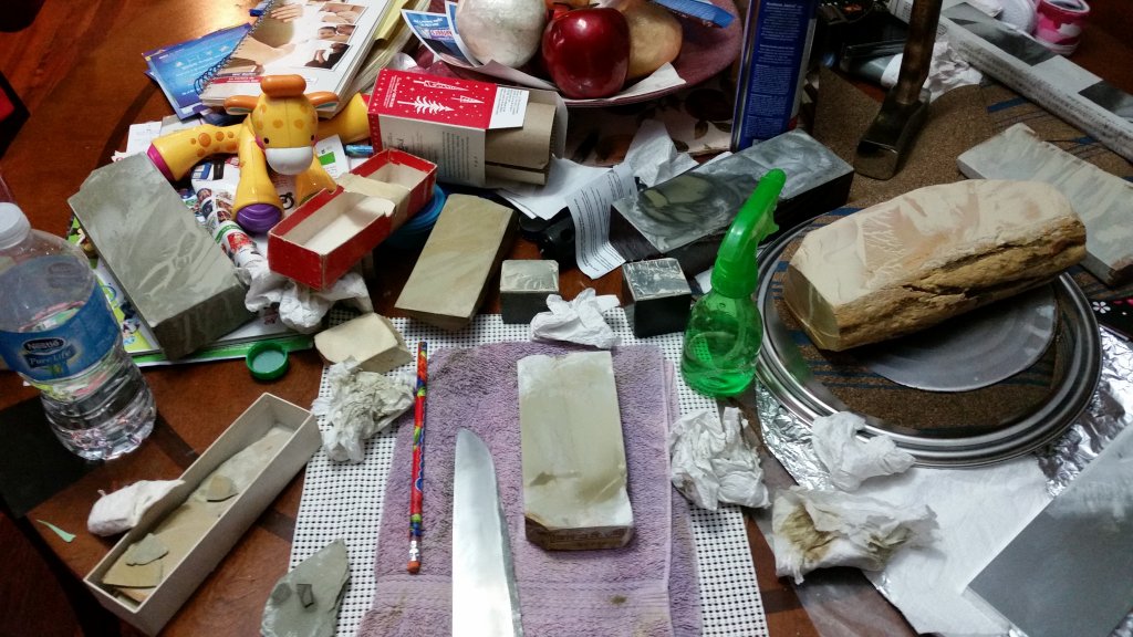

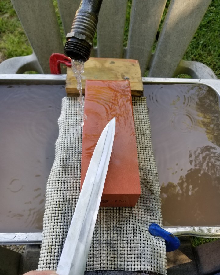

    Another area that i enjoy in this craft is polishing and sharpening on Jnats. I have about 16 or 17 jnat bench stones of various quality that i have spent a reasonable amount of time getting to know through different sequences looking for a good kasumi polish.

    I have a dendritic crucible steel gyuto in the works, but i really need to do some testing before selling it. The temper can be finicky and allegedly more chippy than a watered pattern. We will see. Its like 1.6-1.7% Carbon. Around 20-25% iron carbide.

    What is the difference between dendritic and wootz, both are crucible?
  17. Both are crucible. Dendritic just means the carbides did not dissolve and get re-arranged in the watered pattern you see in wootz. Both are nice to look at, but getting a watered pattern is the goal typically.
    This last puck i had managed to turn into a knife simply did not convert to a watered pattern.
