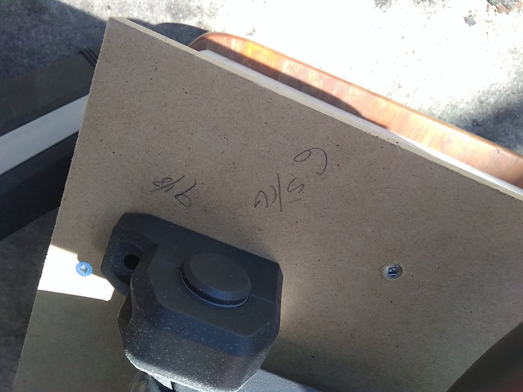

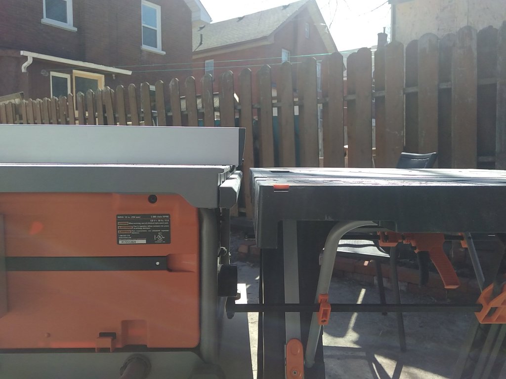

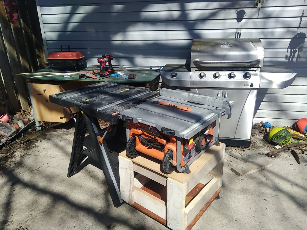

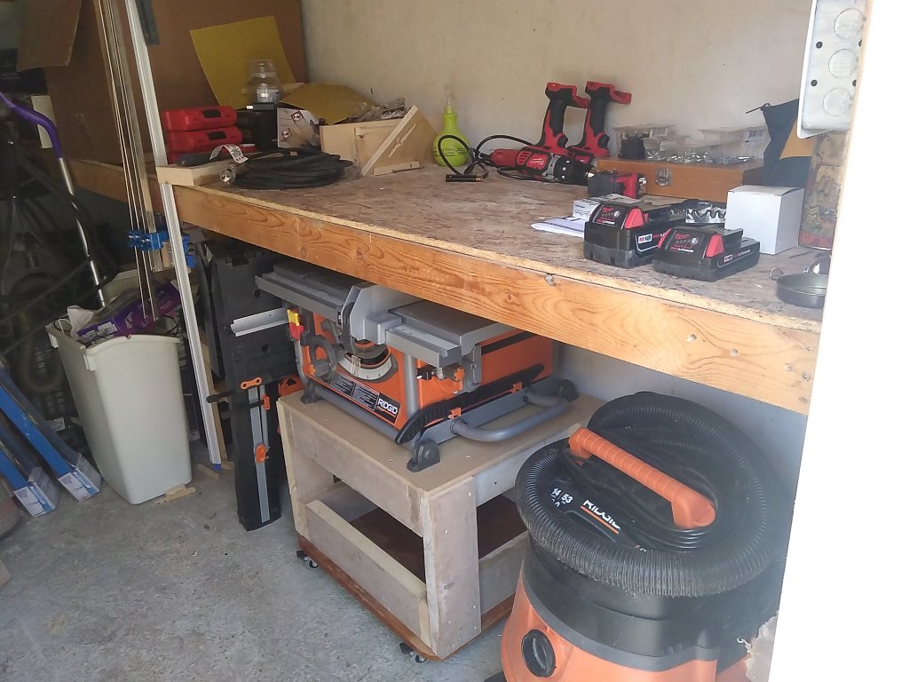

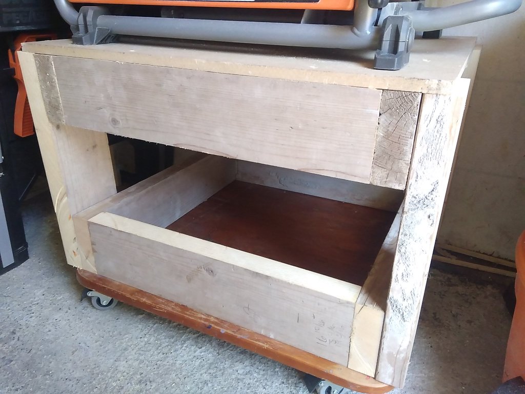

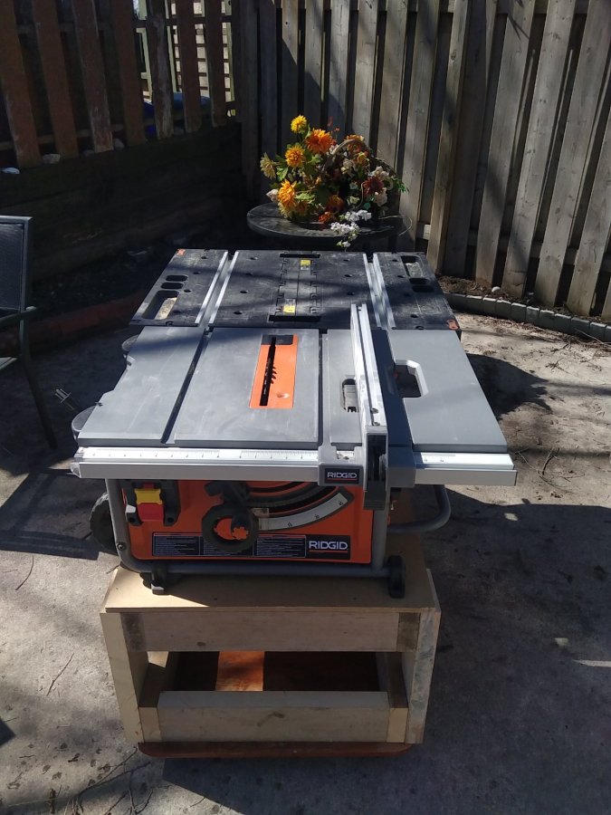

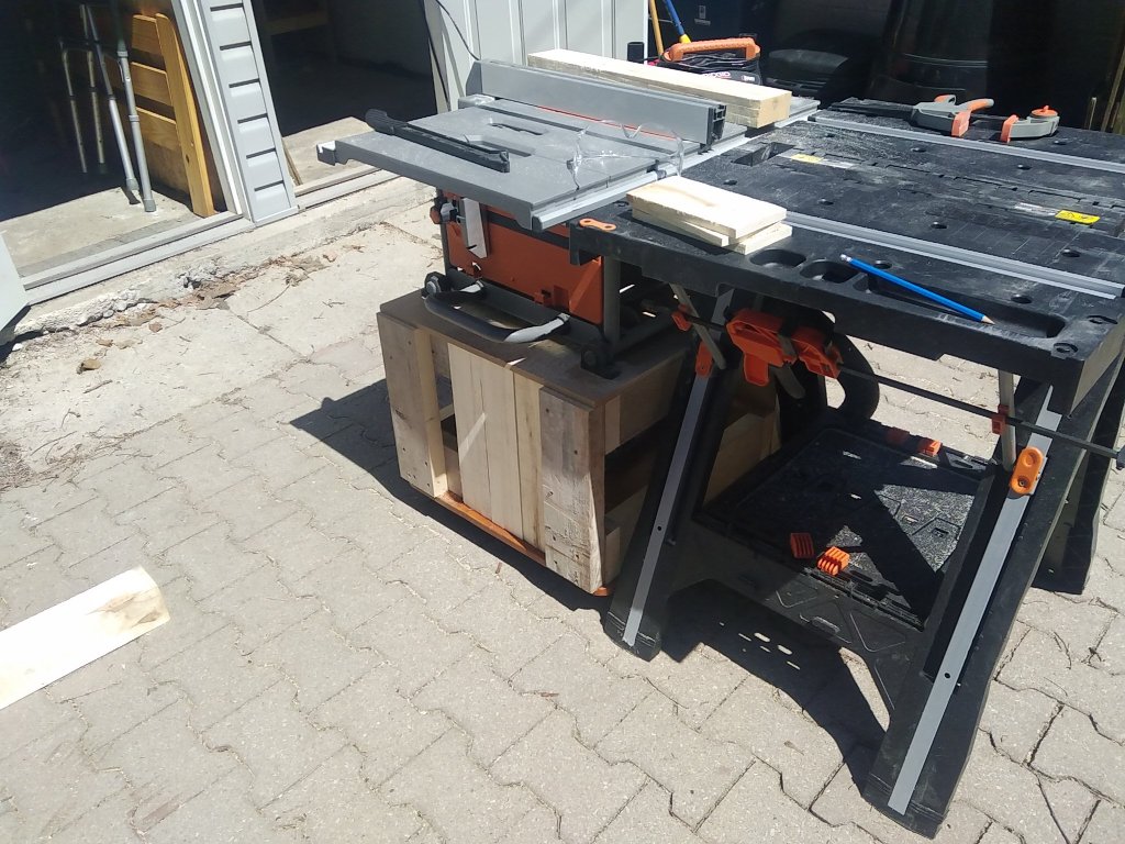

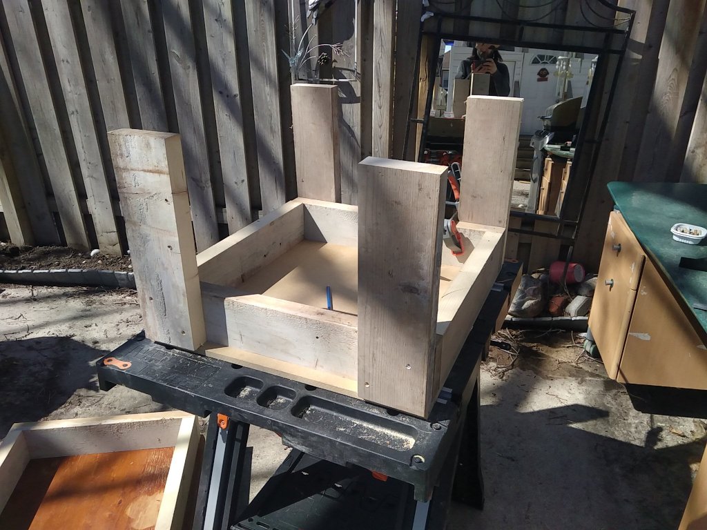

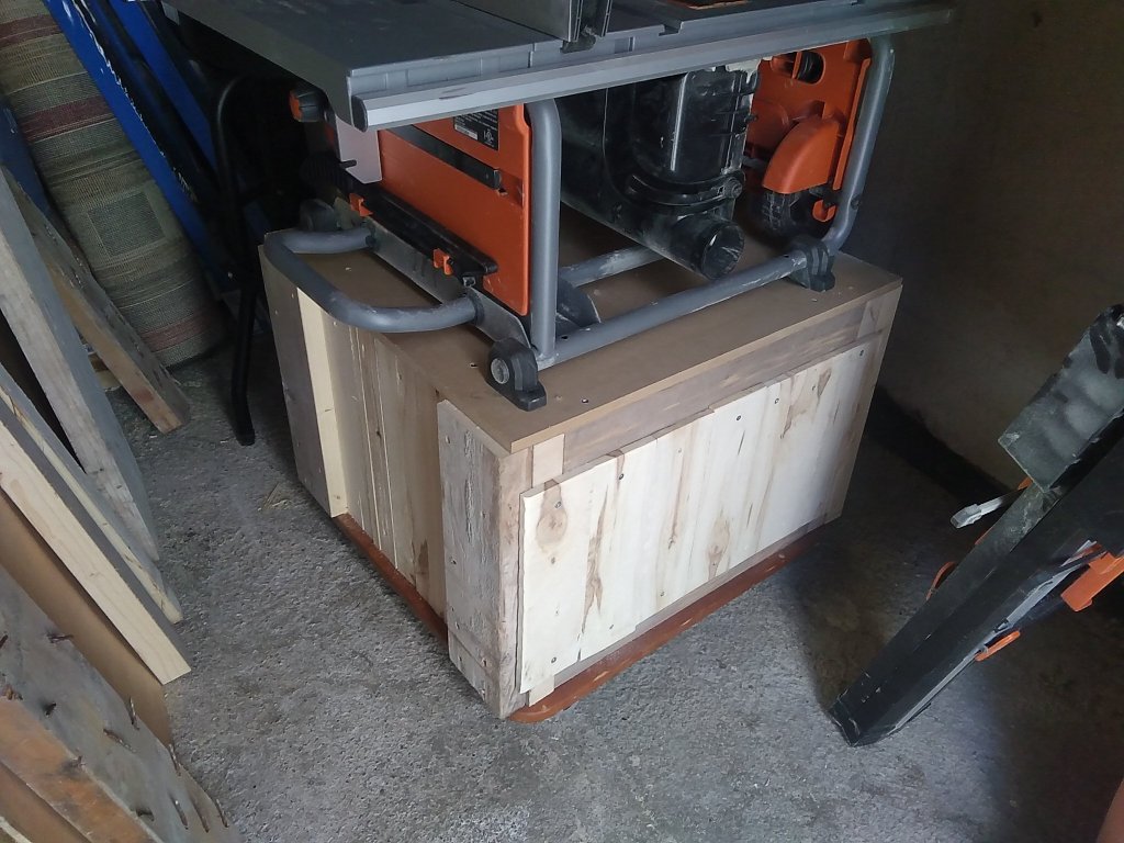

    Mounted the bottom frame to the base,after I realised my flat surface I made the frames on wasn't flat I took the top frame to the table saw and cut 1/8 all the way around to make it flat and cut and mounted the top. Dry fit that all and stacked it to measure how long I needed the legs, cut them from the last ripped blade and put it all together. I was on unlevel ground and the one spot I measure from had me off about 1/4 inch high, but that's okay. I can adjust if it doesnt work later, but now I have a stand and an outfeed table to use. It also fits away under my work bench when not using. IMG_20180421_144647113.jpg IMG_20180421_144907562.jpg IMG_20180421_150916227.jpg IMG_20180421_152536011.jpg IMG_20180421_152730085.jpg IMG_20180421_152740946.jpg IMG_20180421_154512512.jpg

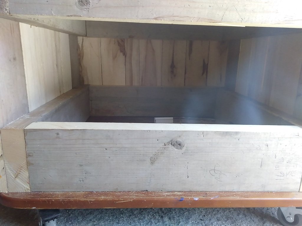

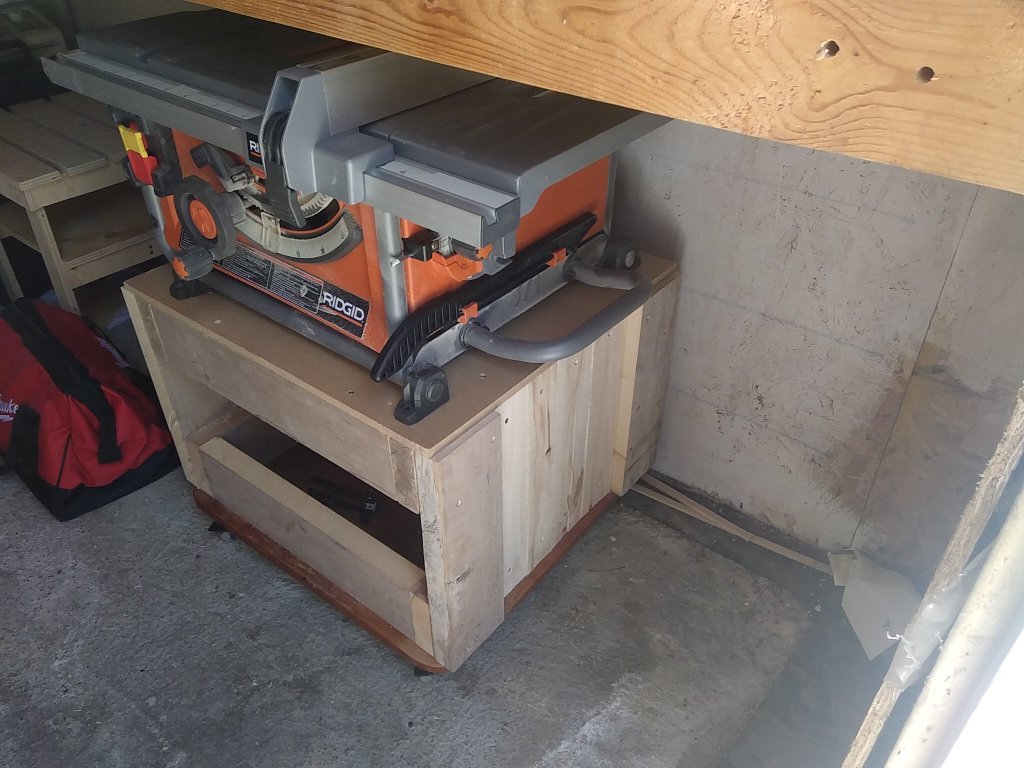

  5. James
    I'm pretty impressed with myself. I still have some things I want to do to this, but for now it's fully functional for me.

  6. James
    Got board today so I closed in three of the four sides after making some panels from a couple of 4x4s. Plan to take the top off so the dust can free fall. Than I can build a drawer I can pull out to clean out the dust in the bottom.
