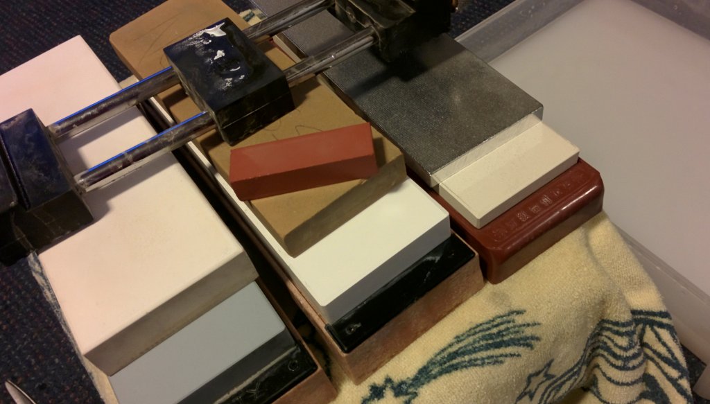

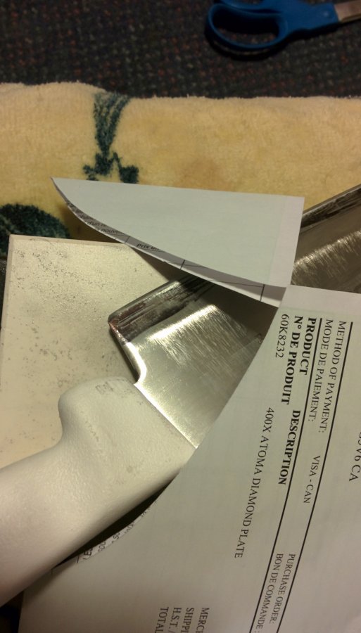

    Lets get Busy, atoma showed up
    And after some soaking, while not even close to Daves edge... but close to the factory edge on a few of my knives
    Its sharp enough to pass through paper cleanly Long the edge, althought there is one spot mid curve into the tip that isnt quite what the rest is at.
    Still not at a good enough level to touch my knives, but its a start that told me I can do this.

  15. Mrmnms
    Nice stone set up James. Looks like you can graduate to some other knives from the looks of the edge you put on that one . Well done.
