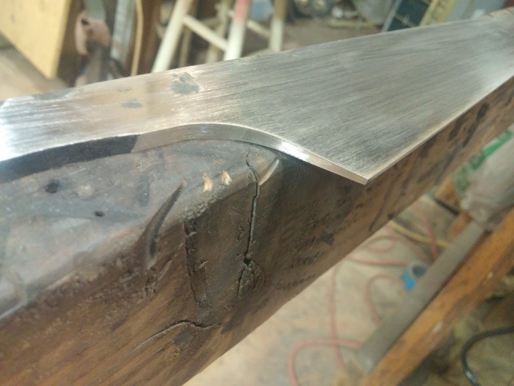

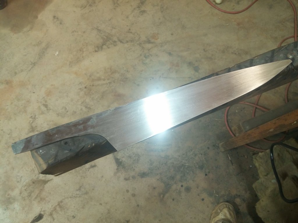

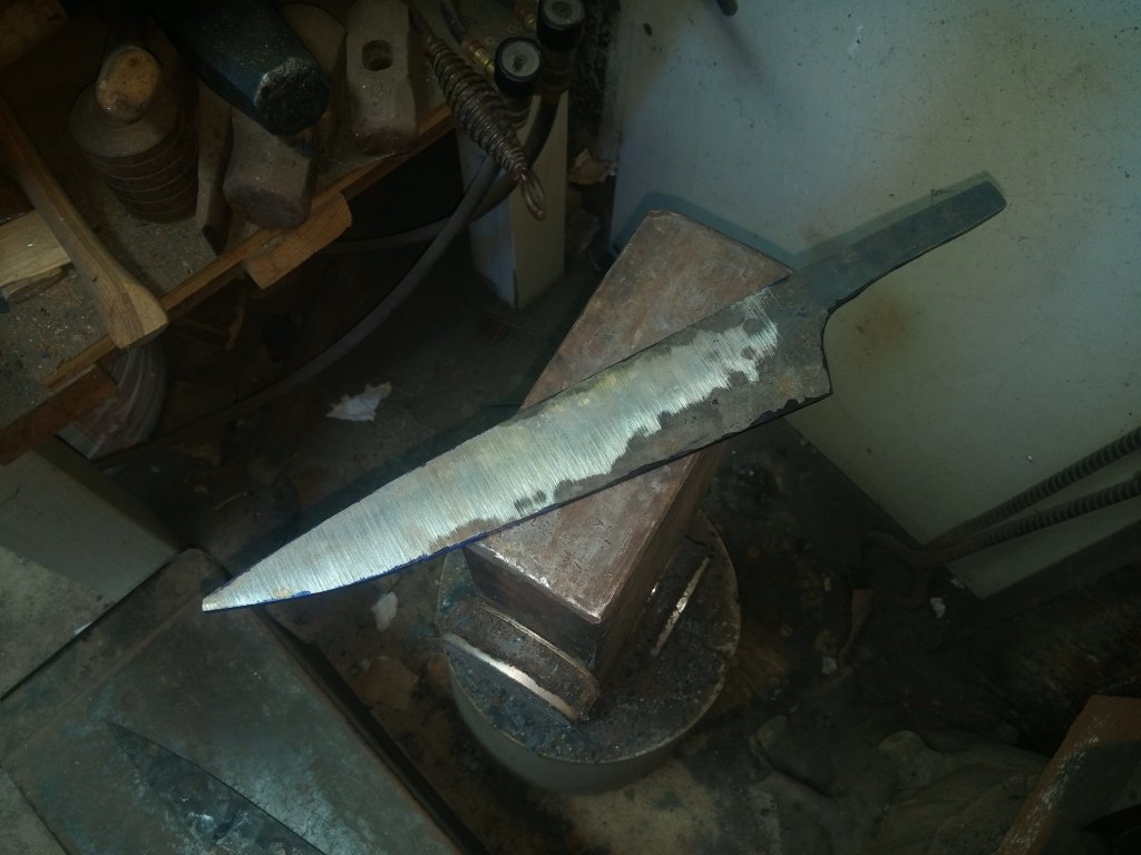

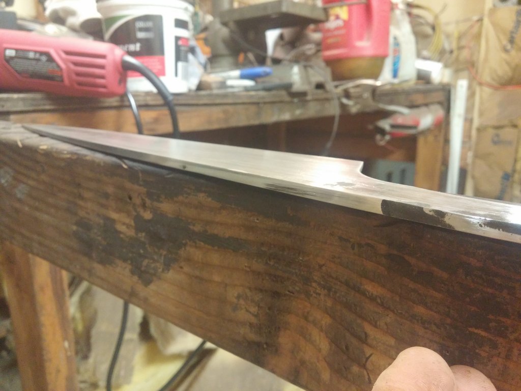

    Forged and partially ground.
    Ground to 120 grit and ready for heat treat.
    As you can see, this thing is a bit of a beast (that word keeps popping up!) lol. 4.8mm on the spine over the heel. I'll be doing the heat treat tonight. Marc has asked for a lot of 'cloudy' activity under the hamon (like Warren's knife)...so we're going to see what we can do. Things like that usually aren't under my control...but I've got some ideas that might work in my favor :).
  3. Love this one. Beefy and beastly. Looking forward to the finished article.
  4. Definitely beefy! Understand however...it will still be a thin knife! It will have great balance though. I'm planning to blend the best traits of my lasers with the forward heft and 'drop' through food feel of a workhorse. We'll see how it goes ;).
  5. Also, I forgot to add. Current specs are 255x55. I'll tailor the final specs down to 245-250mm or so, with as much of the height retained as I can.

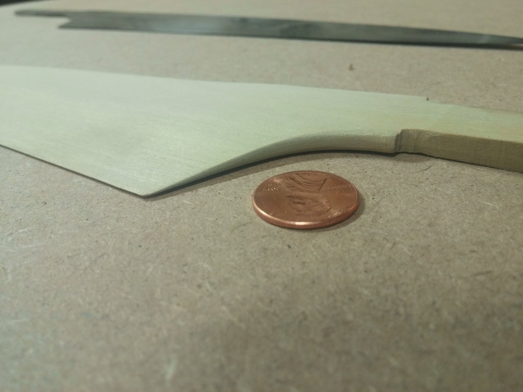

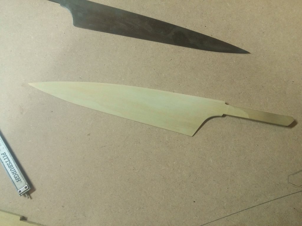

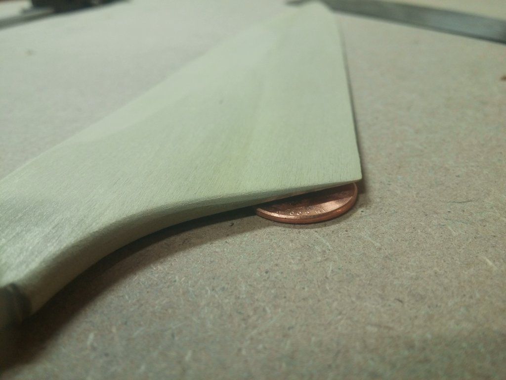

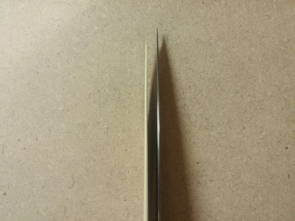

    Anyhow! I'll be updating this thread soon with pictures of a blade in progress...but for now I'll tease you all with some pictures of the basswood prototype I ground out for him:
    20150625_213623.jpg 20150625_213623.jpg 20150625_213753.jpg 20150625_213827.jpg 20150625_213958.jpg
    The wooden model is 150% to scale, as you can see in the last picture here comparing the tip section with a real blade. It's the same prototype I used to make @Anton and @V1P's shorter extra heavy cousins :D.
