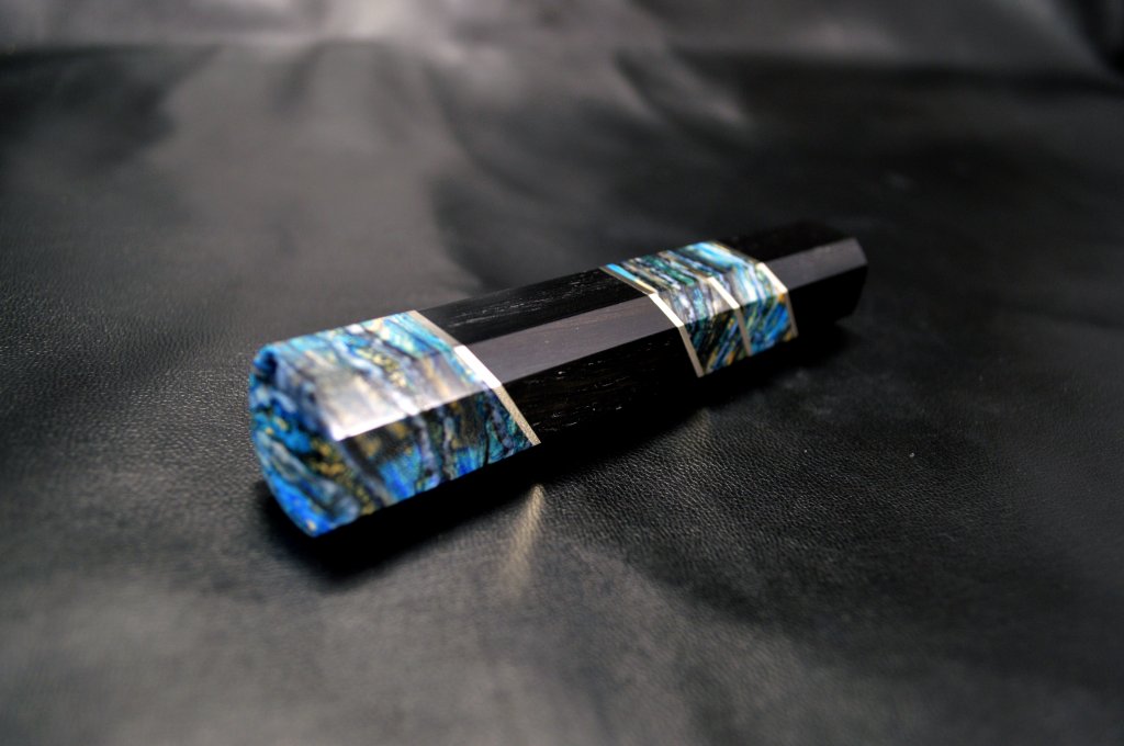

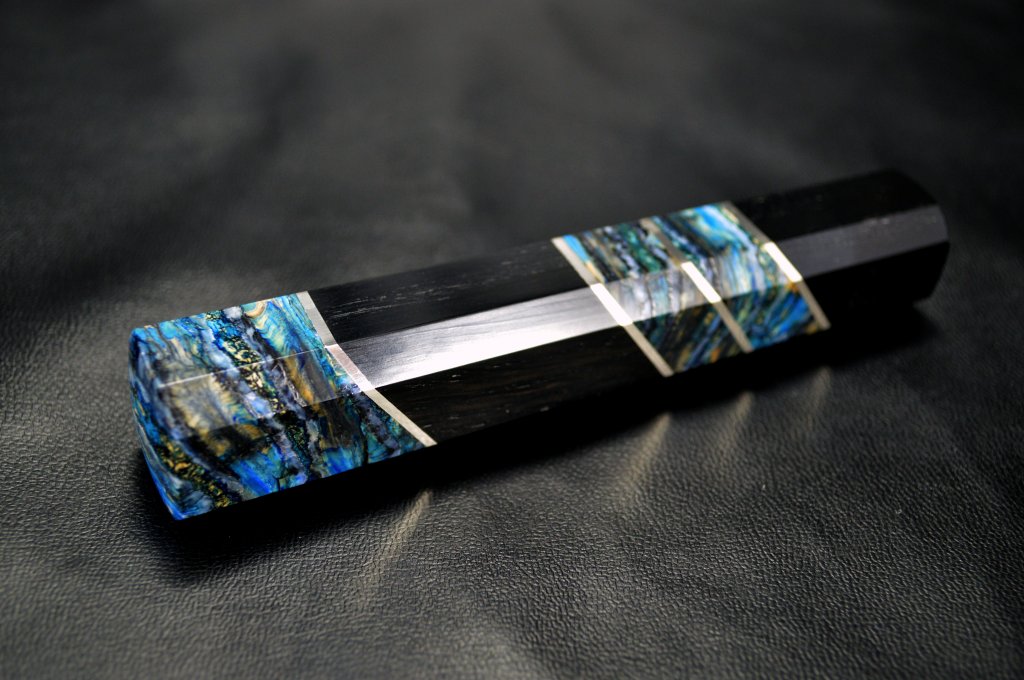

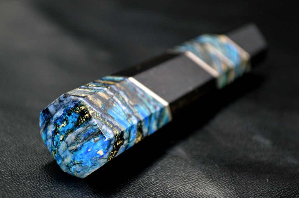

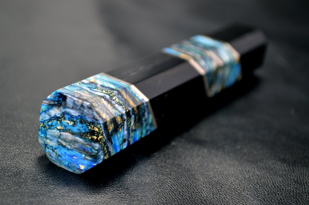

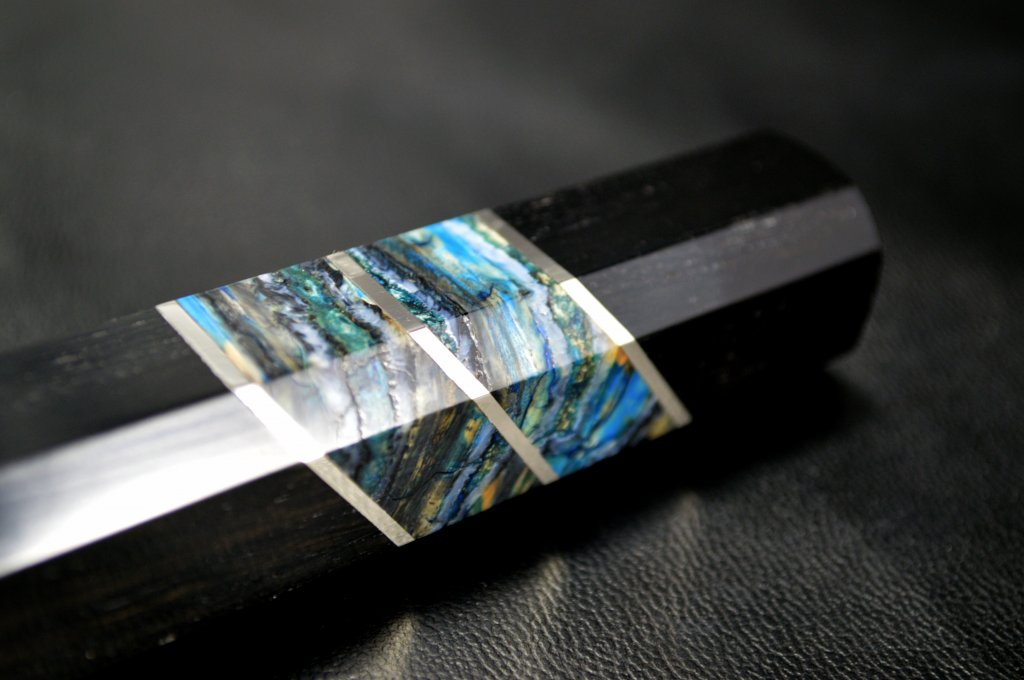

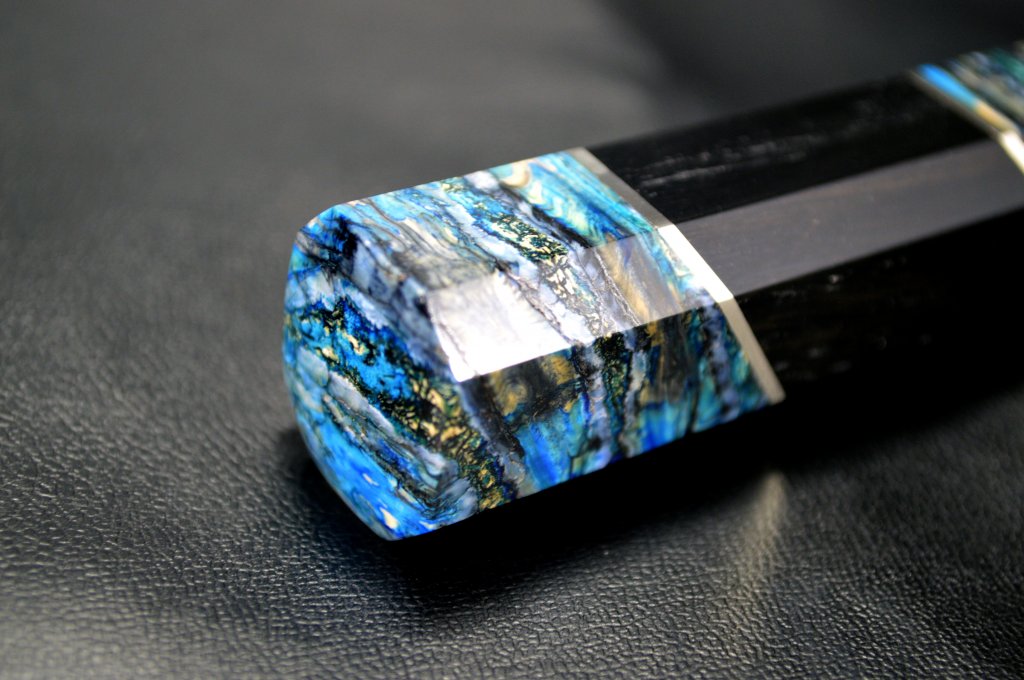

    Here's a bunch of others I took in the medium sized box last night. I'm going to be sad when this handle is gone, lol!
    DSC_5074.jpg DSC_5075.jpg DSC_5076.jpg DSC_5077.jpg DSC_5078.jpg DSC_5081.jpg
    I can see looking at them here that sometimes things I wanted IN focus, were out. This is where I would change the aperture setting if I were in manual mode yes? To help increase depth of field? I know how close you are to the subject has a large impact (even more than aperture from what I've read?) on depth of field as well....but I think that getting used to this lens AND trying to push it to one extreme of its capabilities isn't the most efficient way to learn this stuff, lol.
    Out of the pictures I took of the handle last night, these were the ones worth correcting for color etc. Many were too blown out on the facets to be usable.

    Very nice. One word of advice beyond the photography: I regularly have handles that I inspect closely and find them perfectly fine when I look at them with my reading glasses on. On a blown-up detail photo I will see all kinds of little imperfections that I did not notice before. It's always about finding a balance between perfection and what you can stand behind. If you want to make every handle perfect based on the photos, you will work on them forever... Just my 2 cts.
    That said, the ray skin is a nice idea, I am still struggling with the backgrounds. the most neutral was a grey cardboard, but it is also quite boring. On the other hand, you don't want the background to distract. I tried black fabric and black velvet - the velvet being nice but it drives me nuts that you see every little dust particle in the photos. Still gotta play more with that...
    Just read your post: Larger aperture numbers = more depth. But because you want to keep the ISO as low s possible, this also means longer exposure times. This is where the tripod becomes important. I usually try to set things up and then use the 2-sec timer to shoot, avoids camera movement.

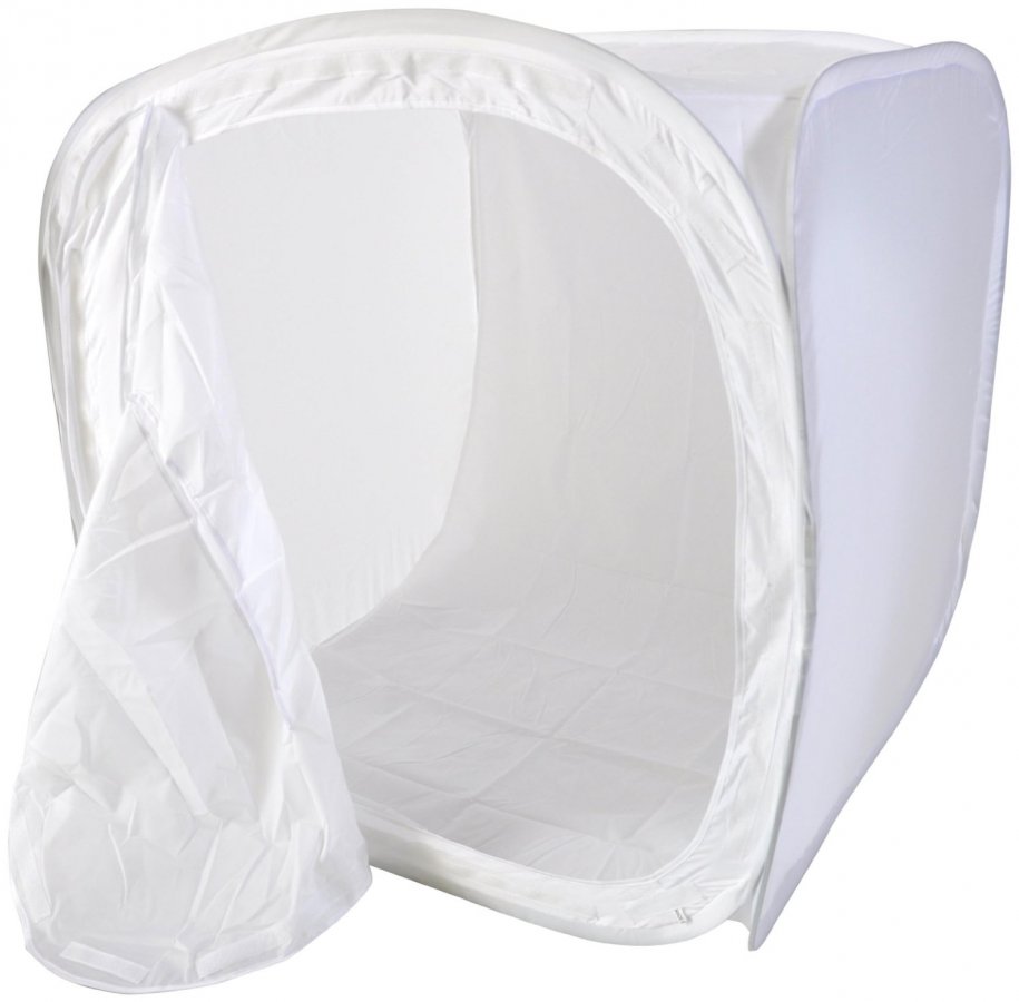

    I actually have a 60" collapsible tent (pictured below) I got in the mail yesterday lol. It's so big its actually useless with anything short of halogen flood lamps. Not to mention it came with a hole in the side so it's getting returned anyhow. I'll probably order a 30" version of the same tent, and pick up a few more lights if necessary.
    For scale, understand that I can stand in it and not have to crouch much. I bought the bigger one partly because I wanted to be able to photograph swords as well...but it's just plain too freakin big. It's literally twice as tall, wide, and deep as the box I posted above.
    I really need to get more used to using the tripod...but I have to move everything around so much right now that it'd take 45 minutes for one picture if I tried it that way. In addition, a lot of my pictures are from angles and AT angles to the work that I wouldn't even know how to start achieving with a tripod.
    I agree about the cramped thing, which is another reason why I thought the bigger one would be better lol. Almost like an enclosed studio unto itself, that I could arrange spotlights, absorbers, and reflectors INSIDE of to gain my desired effect, all while having nice constant even lighting from the outside. Unfortunately though I don't have the space for a 5'x5'x5' tent any more than I have room for an open studio lol. It's definitely something I'll have to figure out though. I mean, outside of general photography and all...what is paying for this is pictures of my knives.
  9. You are killing me with those pictures of that handle Cris. God does it look beautiful.

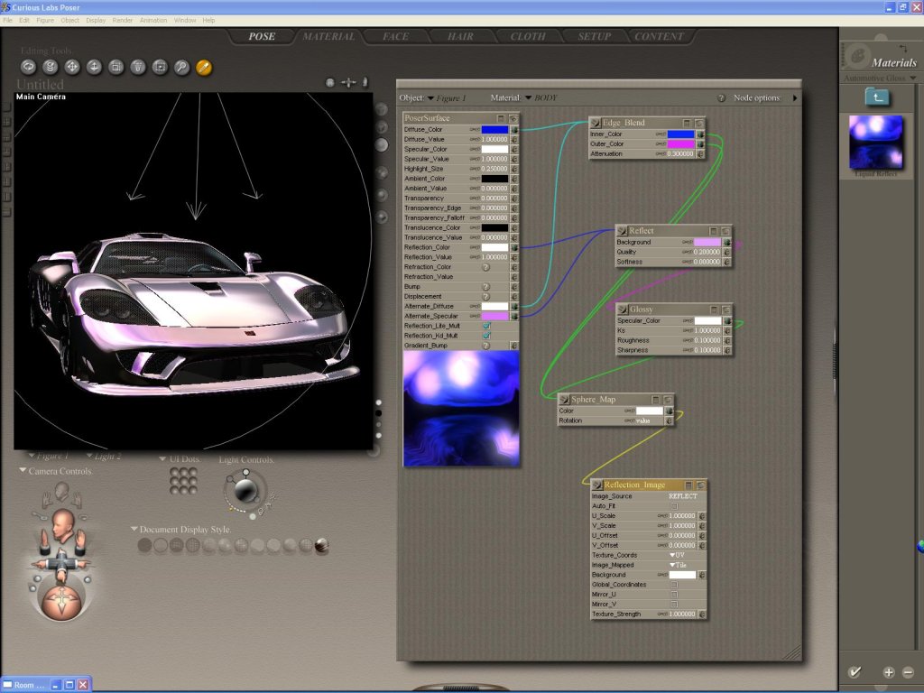

    On a semi related note...I thought I'd share a bit of my artwork really quickly lol. Oddly enough the programs I used were a lot like taking pictures in some ways. Maya, 3Ds Max, and Poser all give a 'studio' with real lighting to use, and changing the lights pretty much changed everything. All of the post editing in Photoshop has really helped me here as well lol.
    First the pictures:
    I'm No Angel...Really.JPG SamauriePortraitInAction.JPG Thakono Impressive.JPG Ulrichh.JPG
    Then a look at the 'studio'...or at least one room of it. Lighting is EVERYTHING in those programs.
    Anyhow, fun stuff...and it's cool to see first hand how much of it is directly related.
