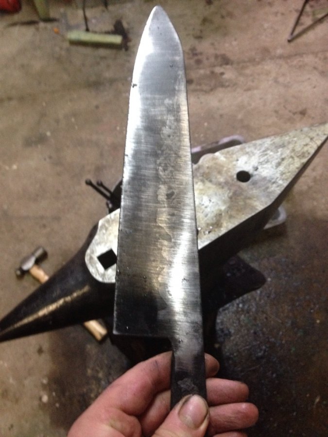

    270mm tall honyaki gyuto in hitachi blue2 , just after quench quick pass on grinder to check the hamon , so far I am happy :D

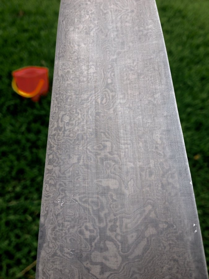

    270mm wa gyuto in random pattern , getting close, a quick dirty etch to check the pattern
  14. Can't wait to see the finished product Mert
