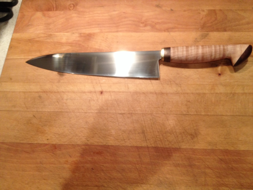

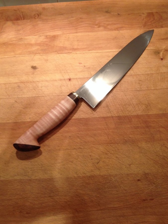

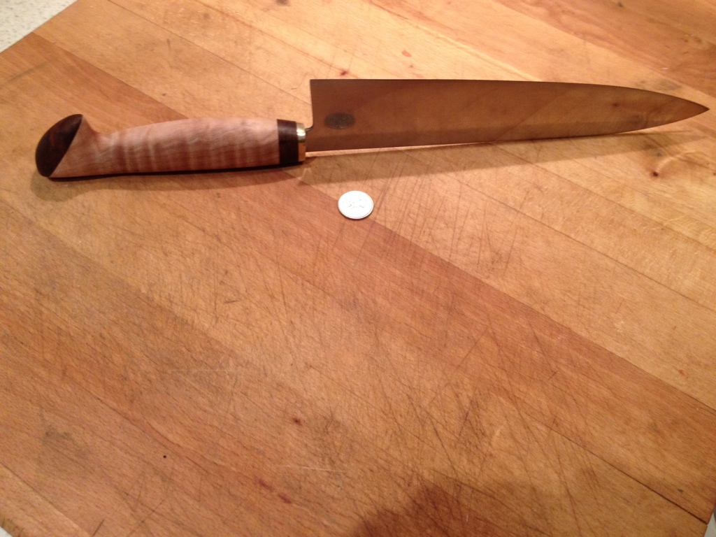

  2. chefcomesback

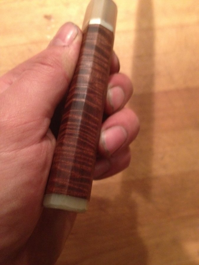

    Another gyuto 240mm with curly maple from burl source , ringed gidgee , brass tip. This one has a workhorse grind and a semi mirror polish

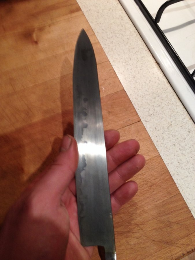

    Another line knife in works , after quick etch to see the core steel

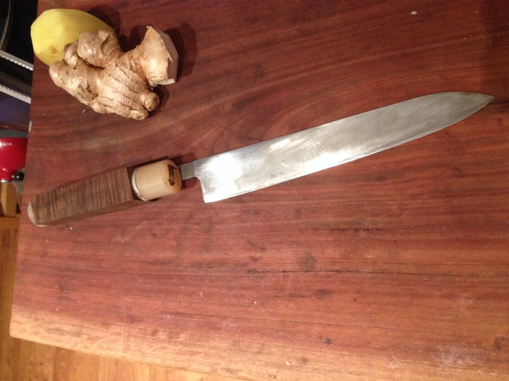

  8. chefcomesback

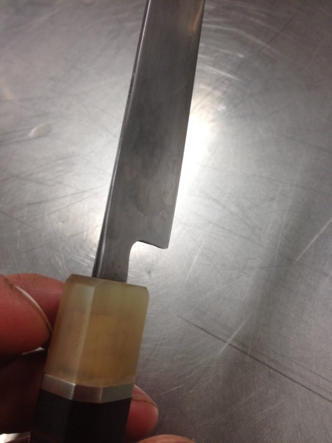

    The second line knife is taking shape , need to do some polishing , the handle will be blond buffo horn , nickel spacer , ringed gidgee and horn end cap

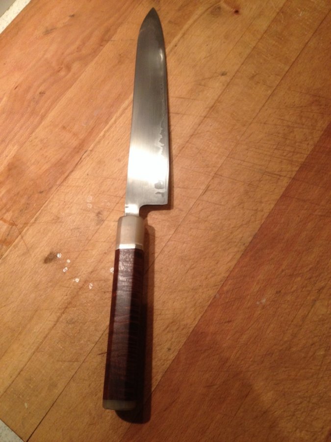

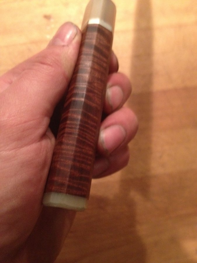

  10. chefcomesback
    Thanks Al , it's not bad effort I would say , I gotta raise my anvil , no wonder my back is killing me when I attempt to forge . Now it's finished and will go to my work rotation
    Did I say that I love ringed gidgee before ?

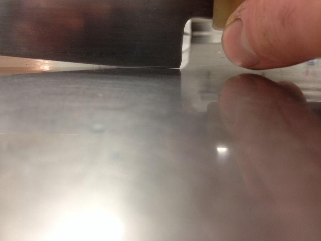

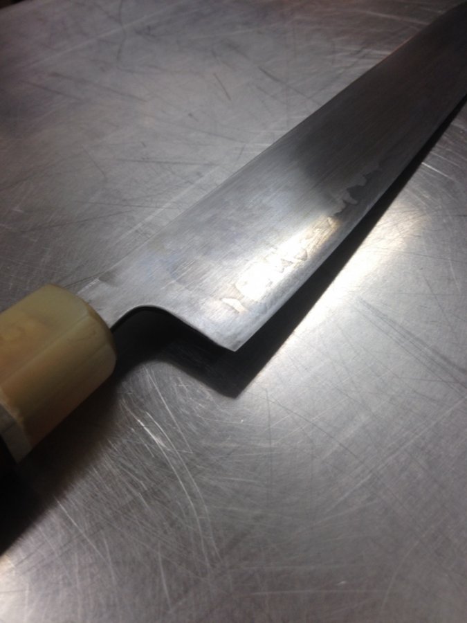

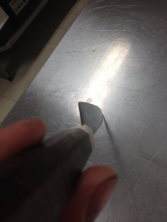

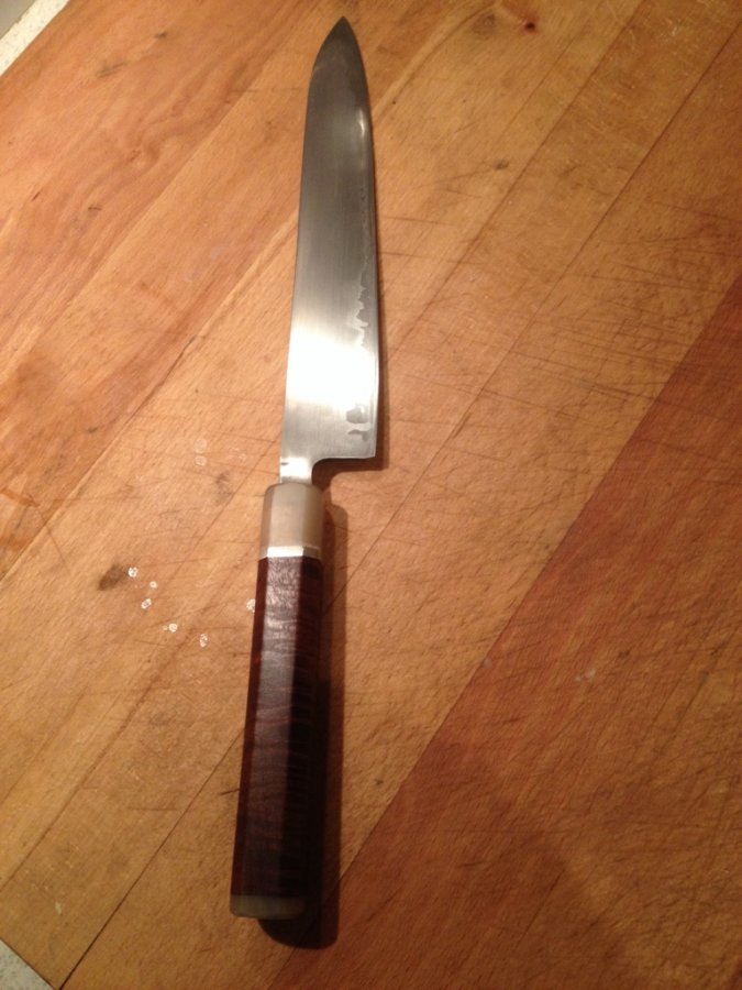

  12. Brad Gibson
    Maybe its just the picture but the new SAN MAI line knife looks like it has a really high spot near the heel. It is freaking awesome though! I love that handle work!!
  13. chefcomesback
    Thanks Brad , it appears to have a flat area before it curves towards the belly , it doesn't have any holes on the edge though , here are couple close up shots after some use

  16. Good to see the raising the anvil thing stuck! If you can find another piece of steel to put it on that's best of course, but even a base of crossed 2x4's will do it. It's just critical that it be raised. You can badly mess up your back, and even your elbows if your anvil is at the wrong height. I like mine high enough that if I bend forward slightly, I can rest my hammer head on it exactly where my wrist would place it after a comfortable stroke.
    I love this newest knife by the way...! I'm not sure what's going on with the heel either, but if its working for you...that's a good thing. I relieve my knives at the heel, but only for about 1cm, and it's only about .5mm higher than the line of the edge. The idea is for the heel not to thunk down into the cutting board with use.
    Anyway, your work is improving by leaps and bounds brother...this new one is my favorite so far for sure :).
