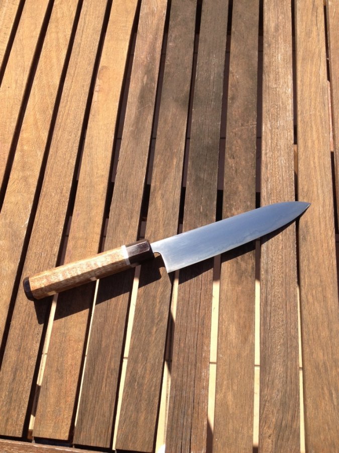

  2. chefcomesback

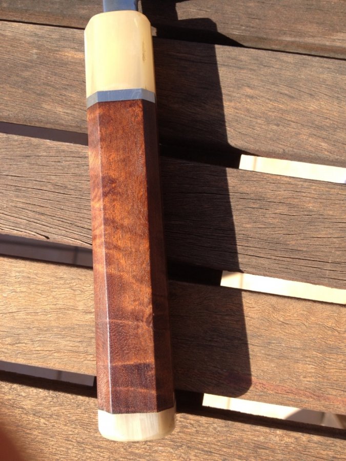

    Gave myself a day off , did some handles and some grinding
    The one on the left is African Blackwood and Hawaiian mango with nickel spacer , the one on the right is ringed gidgee , blond horn and nickel spacer

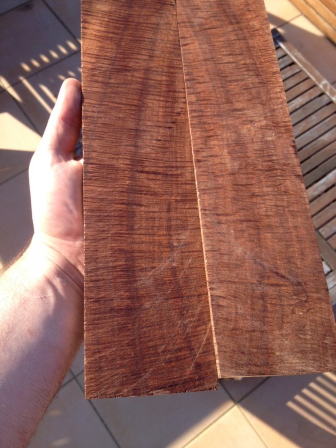

    With the next lot of ringed gidgee handled gyutos I will be offering these beautiful presentation grade material timber for saya

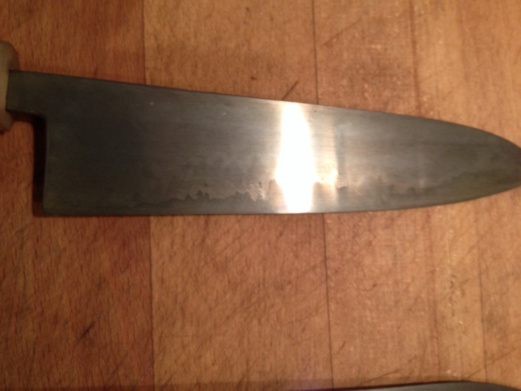

  5. chefcomesback

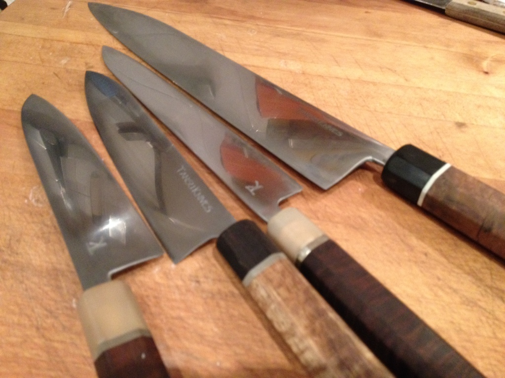

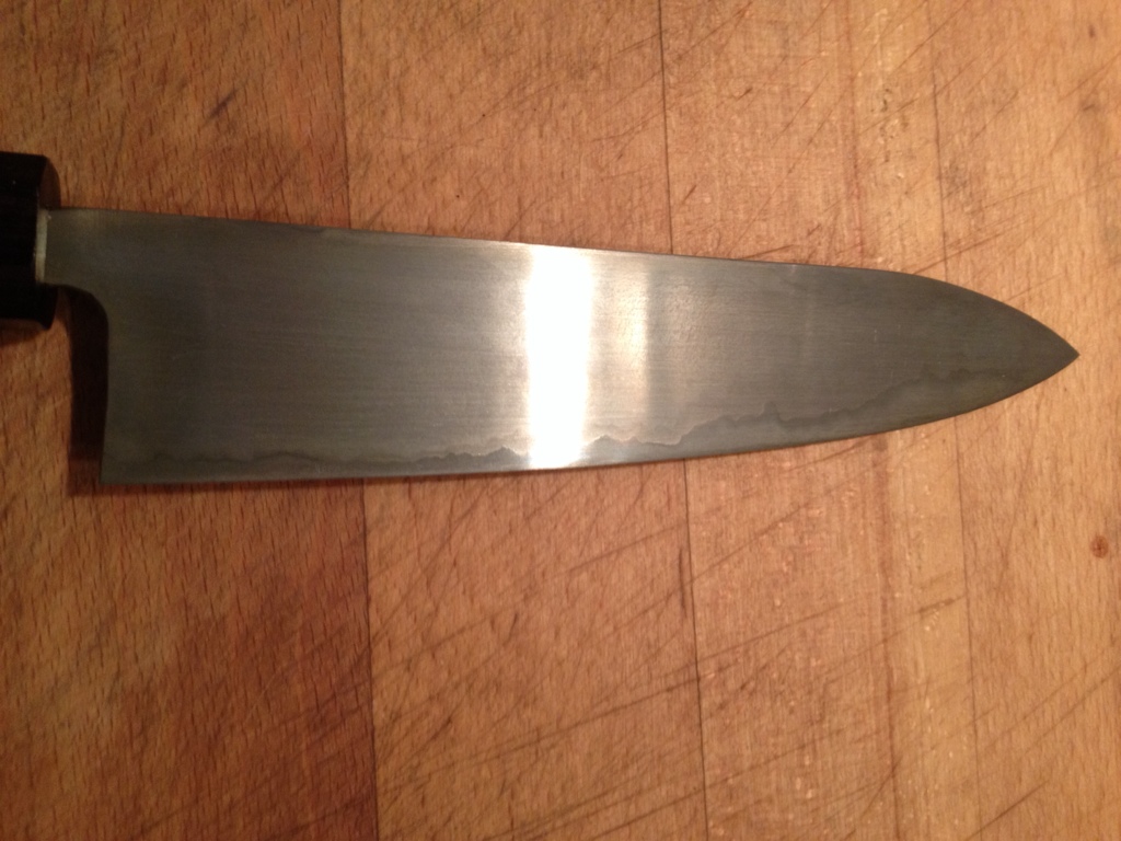

    Getting close , hand finished and etched ImageUploadedByTapatalk1415110901.739919.jpg

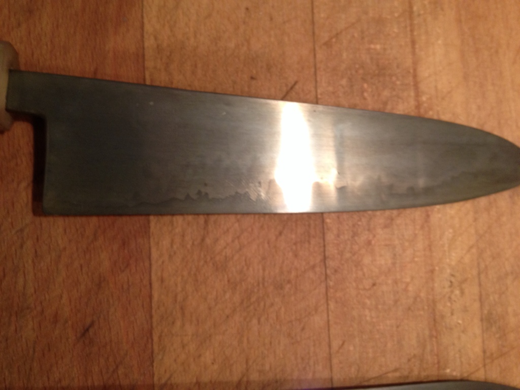

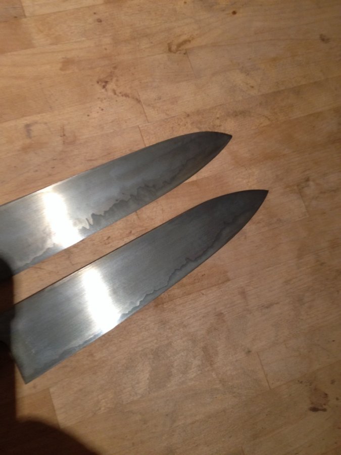

  6. Mert, how are they ground? And when will we see your promised makers mark?
  7. chefcomesback
    Anton they are really close to being symmetric , less than 2 mm at the spine but super hard and no flex . I am waiting ( rather impatiently ) for the makers mark

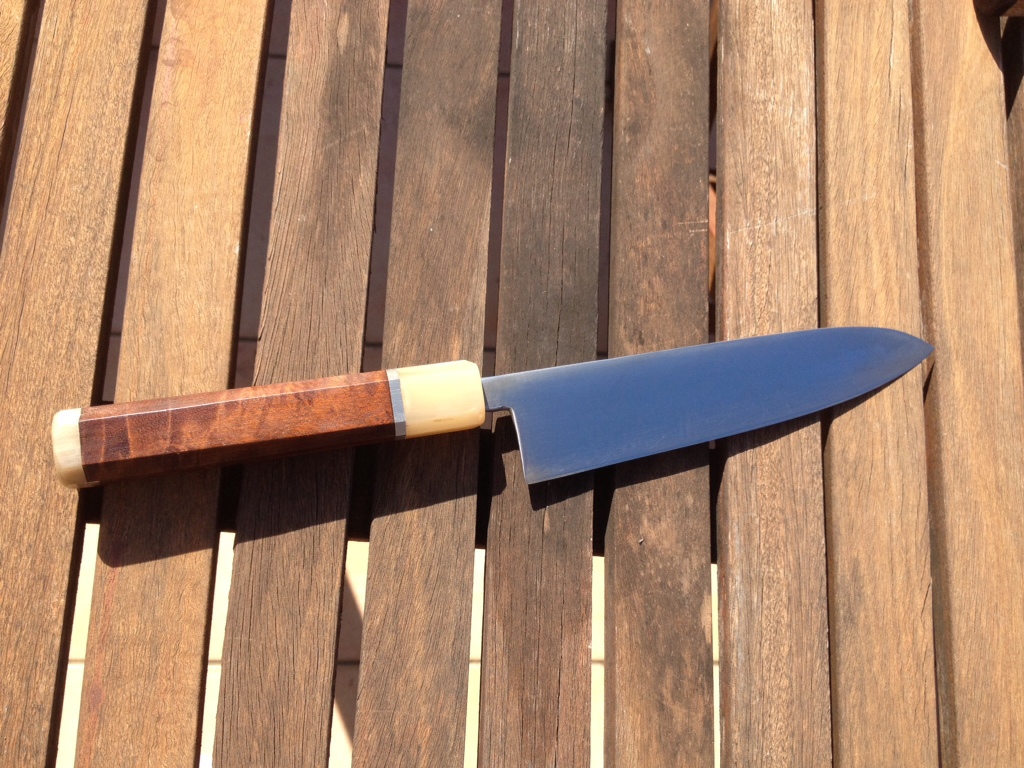

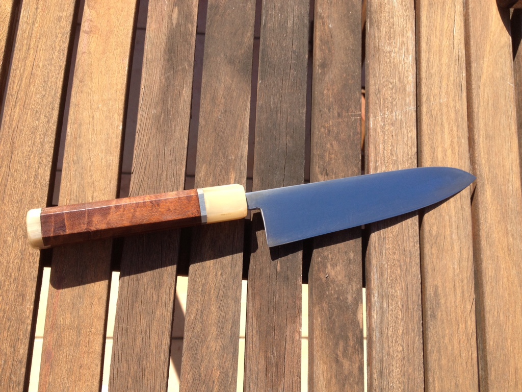

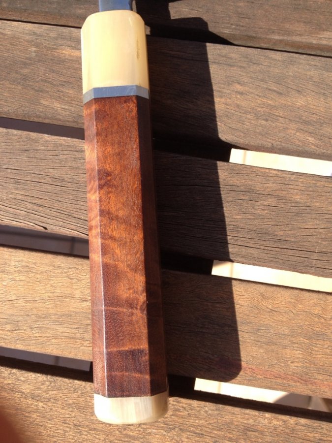

  8. chefcomesback
  9. chefcomesback

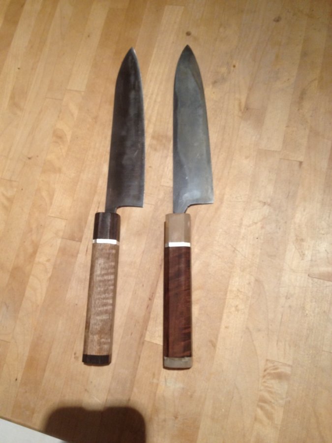

    2 170mm petit Gyuto's , hand forged from a blue#2 core billet and water quenched. First one with hawaian mango ( not maple:D ) African Blackwood handle and nickel spacer
    Second one with figured gidgee , blond buffalo horn and a nickel spacer
    I haven't fitted the handles yet , bad other than that and my makers mark they are ready
    I have realised at home I am reaching for 150mm petty more than my 270gyutos , I tried 240 and 210 gyutos but they didn't feel right , on the other hand the petty I am using is not tall enough so I made these sticking to the gyuto profile and the height to length ratios that I like

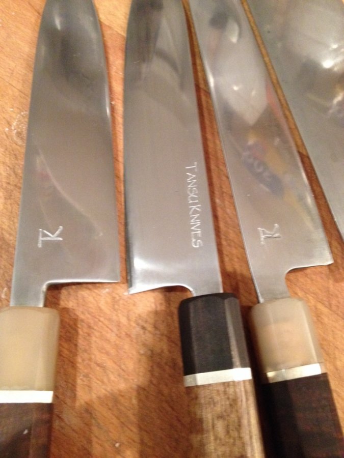

  12. Jeffery Hunter
    Those look great! I really like the mark as well.

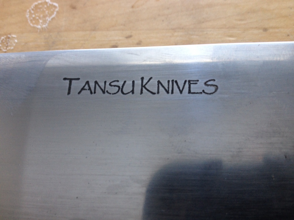

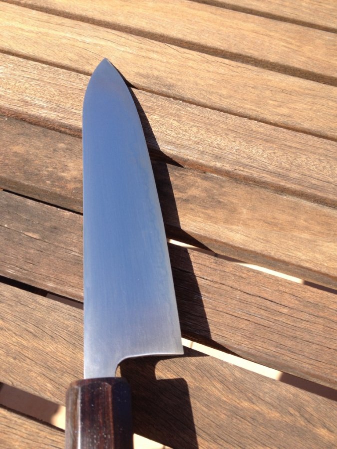

  16. chefcomesback
    About time my makers mark arrived and I had time to play with it today, why do you guys think ? Size , placement ?
  17. chefcomesback
  18. Me likes!
  19. cheflarge
    +1
