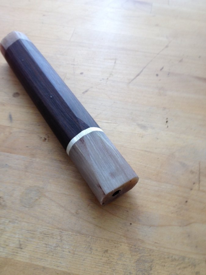

    African Blackwood from burl source , blond horn ferrule and end cap, nickel spacer . This one will be going to a 270mm workhorse wa gyuto in 52100
    Only rough ground at 50 grit at this stage

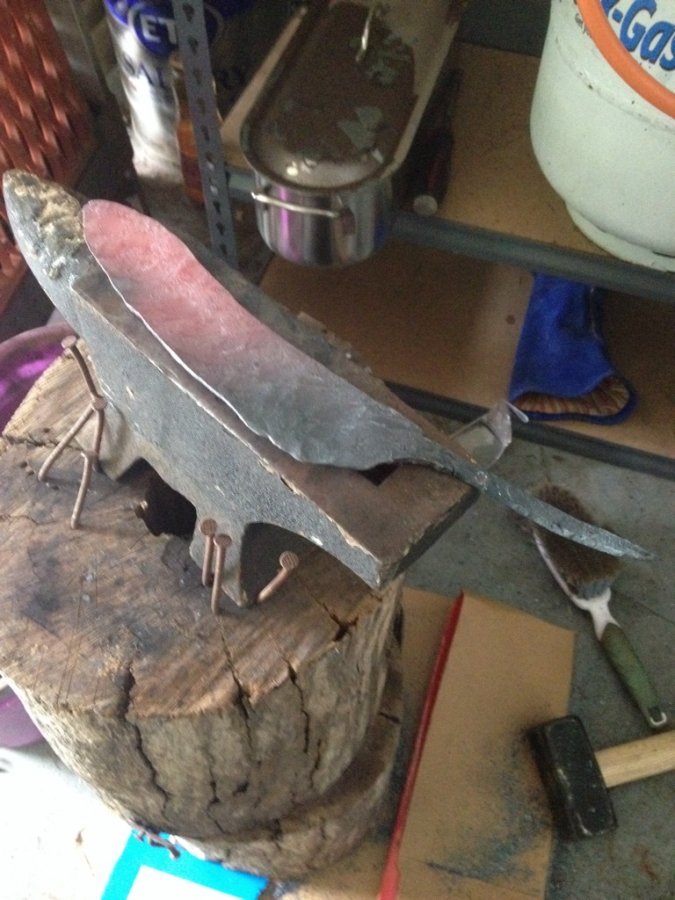

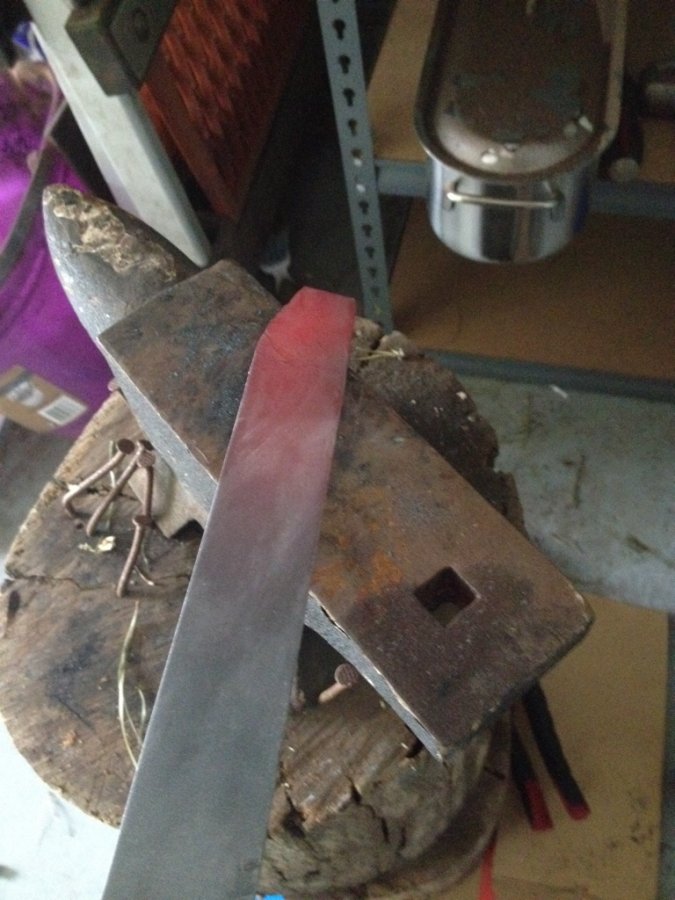

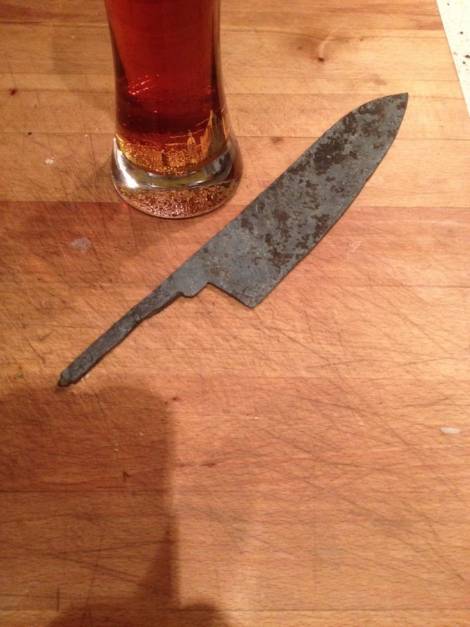

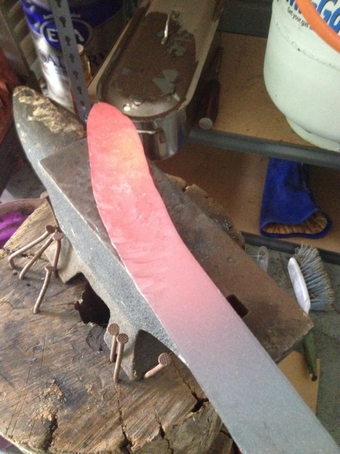

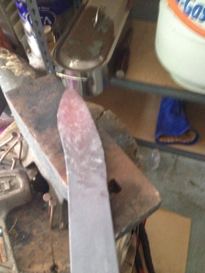

    Had more chance to practise forging today , will be forging all of my carbons from now on
    It's a hitachi blue2 laminate billet and hopefully I will get a small gyuto or funayuki out of it
    Make it pointy
    Make it wide
    Some more

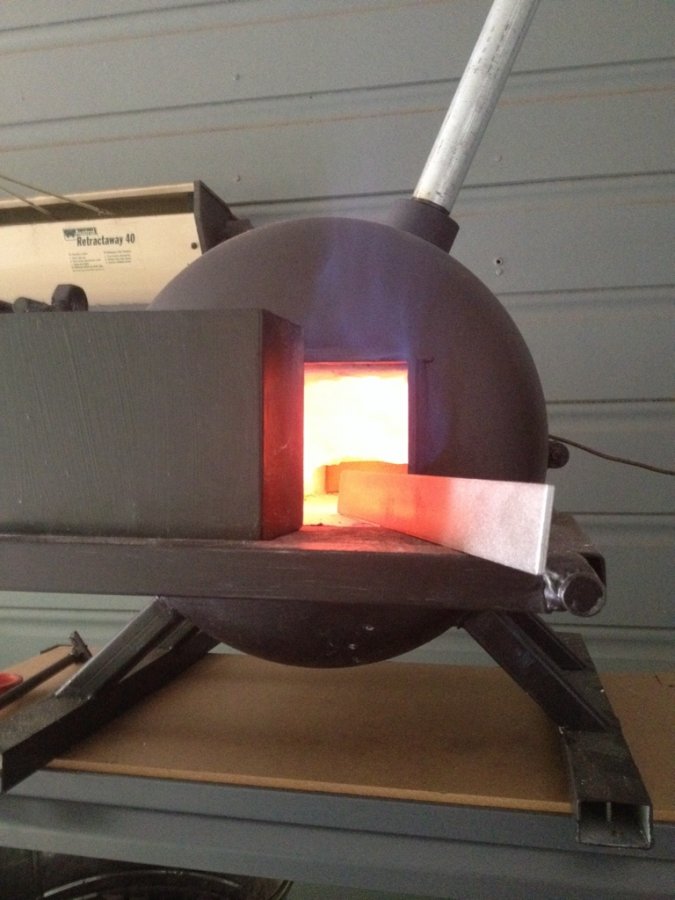

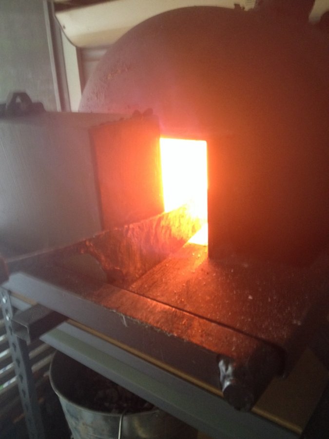

    After this I cut the billet in half , shaped the tang
    Going in for normalising
    Fixed the shape bit too
    Now it's annealing , will take more pictures once I make progress

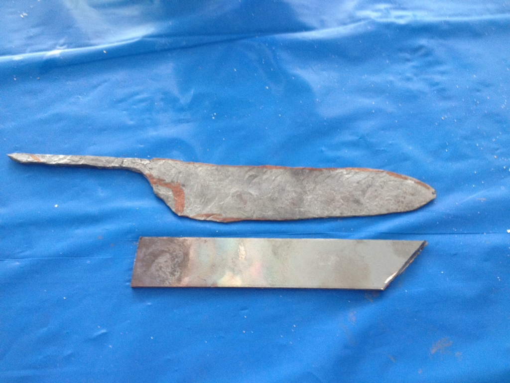

    To be honest I had no idea that I would be trying to forge a knife if someone told me a year ago , I would have bought a bigger and proper anvil, we are looking to move to a bigger house with a big workshop , hopefully I will have a decent set up then . Here it's after annealed

    With the second half of the billet I will make a 210mm line knife
  8. chefcomesback
    Managed to heat treat the first knife I forged from that billet at the break between lunch and dinner service , it came out quite nice , almost perfect straight , last time I decided to grind the unevenness out and the core steel was exposed not uniformly and the knife was bent slightly because of two steels moving at a different rate over time , this time I straightened out before tempering
    Hopefully I will get a good 180mm funayuki with a wa handle

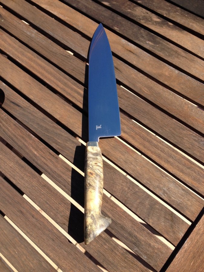

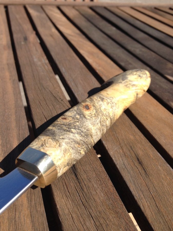

    This one is for the brewer at work , he makes some nice hefeweizen , should celebrate it being done with a bottle or two

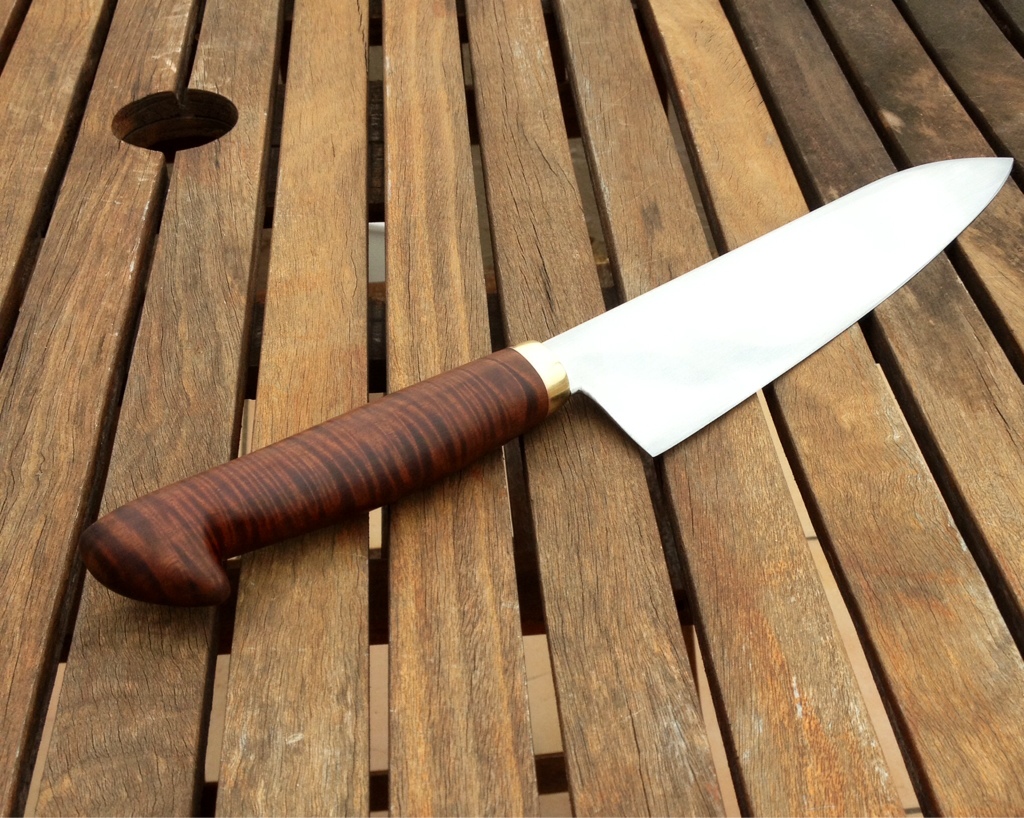

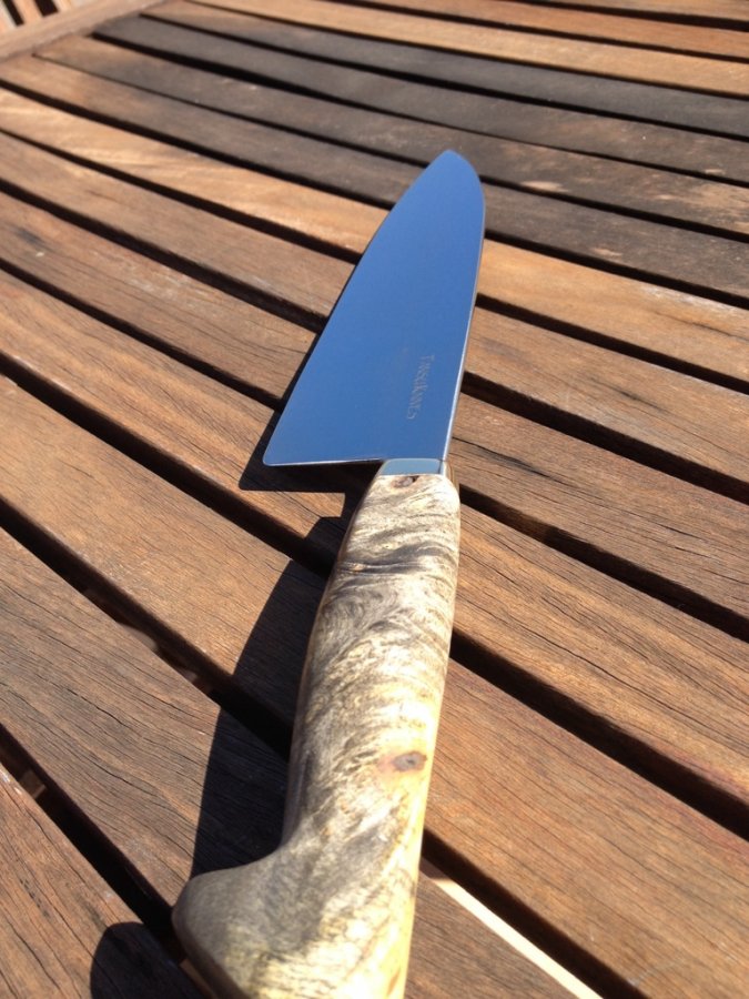

    240mm gyuto forged from 52100 with a buckeye burl from burlsource and a brass , 51mm at the heel, tad under 3mm at the spine and weighing at 201 grams

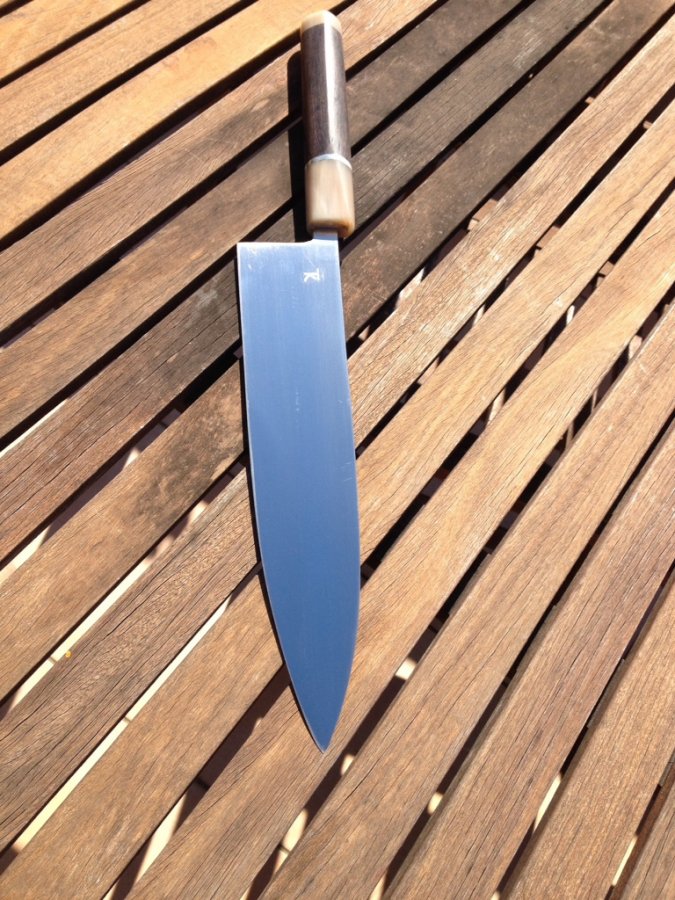

  11. chefcomesback

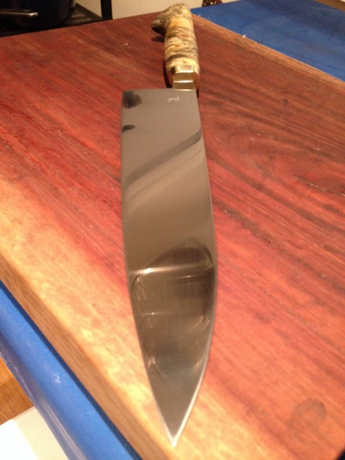

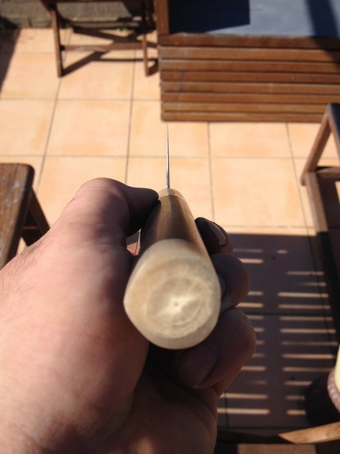

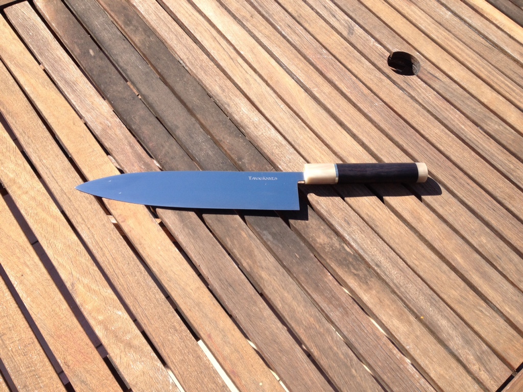

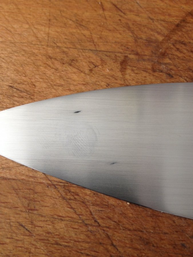

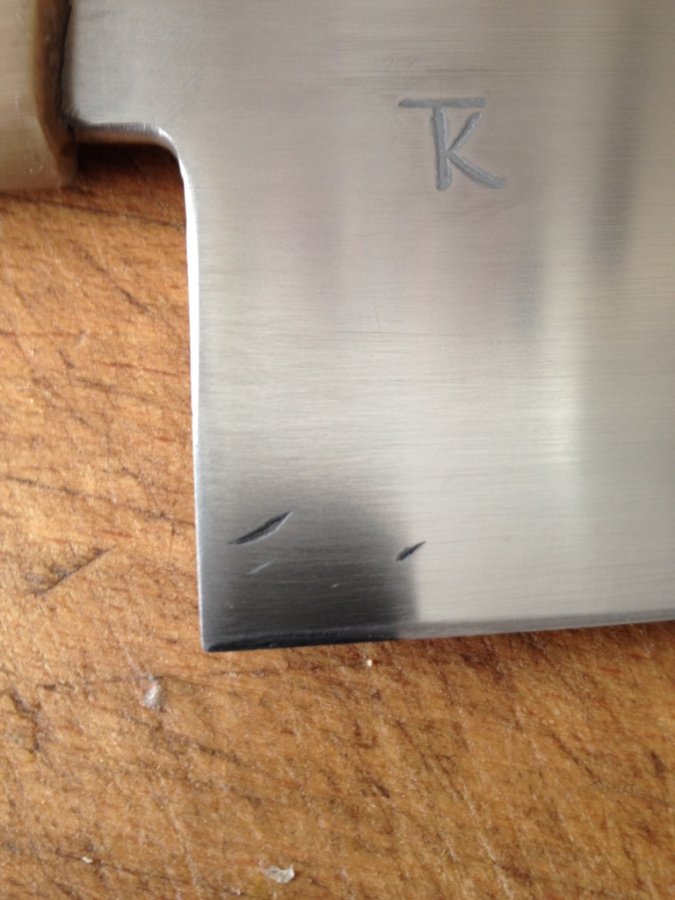

    A wa gyuto I just finished , it is hand forged from 52100 , 255mm at the edge , 53mm at the heel , 2.8mm thick at spine and weighs 231 grams , the handle is African Blackwood from burlsource , blond buffalo horn and nickel spacer . Although it's a very good cutter I am bummed about my lack of hammer control , since I couldn't get rid of some forging marks out

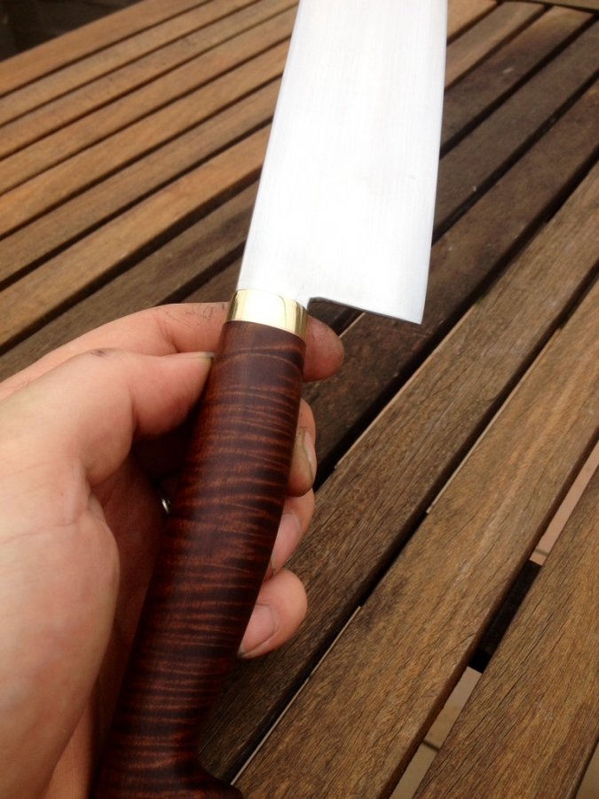

    Neat stuff. Your handles seem to ride very high; have you tried something with a lower tang position and a machi for mounting a bit more level with the spine? Just curious.
  13. chefcomesback
    Newer ones will be more levelled with the handles , these were profiled and heat treated a while ago , ideally I want the handles look more levelled like this one ImageUploadedByTapatalk1423396633.078017.jpg ImageUploadedByTapatalk1423396668.361951.jpg
    I have couple left before I switch to this style altogether
  14. XooMG
    Quite cool with the newer style. Several folks have told me to watch developments from you, and I think I can see why.
  15. cheflarge
    + 1 to what Warren said........ Darn sexy knives there, sir! :cool:
  16. Toothpick
    Yup I think they add a bit of character. Lovely knives!
  17. MotoMike
    I like the newer handle alignment and those forging marks wouldn't bother me at all. beautiful knives.
