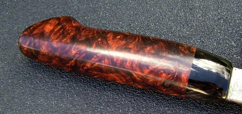

    Here's something you don't see everyday, well never actually, it's a new style Takeda gyuto that's been converted to a western handle. [​IMG]
    The wood used is untreated (unstabilized) rosewood burl paired with black buffalo horn. This is a rare case where I'll state that the pictures look better than real life does.
    The wood, being extremely oily, would not take and hold onto any combination of oil (and even shellac as suggested by top woodworkers - to seal it) that I tried with it (and I tried dozens) so eventually I gave up and did what most knifemakers do and just buffed and waxed it. In person the color is a lot more brown (not very red at all like what the pictures show), the surface has high and low polished sections where the oil bleeds out at different rates, and is just not as (grain) filled as I normally do. If I could have got oil to stay put then I know the color would have been amazing but it wasn't to be. [​IMG]
    You can likely tell that I'm not very happy with the results, I'm used to getting better, but I'm also not used to working with raw oily wood like this either so maybe some of the results can be contributed to myself. I think the handle is nice, is stable, and will serve the customer well however I dislike that the customer now has to deal with waxing his handle as upkeep and that the quality isn't what I usually provide. I will no longer use this wood unless stabilized (and well seasoned) and even then maybe not.
    With all that said, I do appreciate the customer tasking me with (and supplying) this wood though as it gave me a chance to try it out and see what I could do with it, I just hope that he likes it. [​IMG]

  5. MattS
    I think its beautiful. Nothing can be done with natural products to force them to act like we want, that is part of the beauty. We just have to accept them for what they are. I would be stoked with that handle.
  6. I agree. Its the issue with natural products. Hopefully in a couple of years it has stabalized and then can get a touch up and be "perfect as you wanted".
    Apart from that it looks amazing.
  7. Fr once, I do not like it that much. The quality of the work looks great, but I think this handle does not fit this knife. Purely a question of taste here. Some may like it, I do not.
  8. Dave Martell
    Thanks guys! :)
    @ zetieum, I completely get it, thanks for being honest.

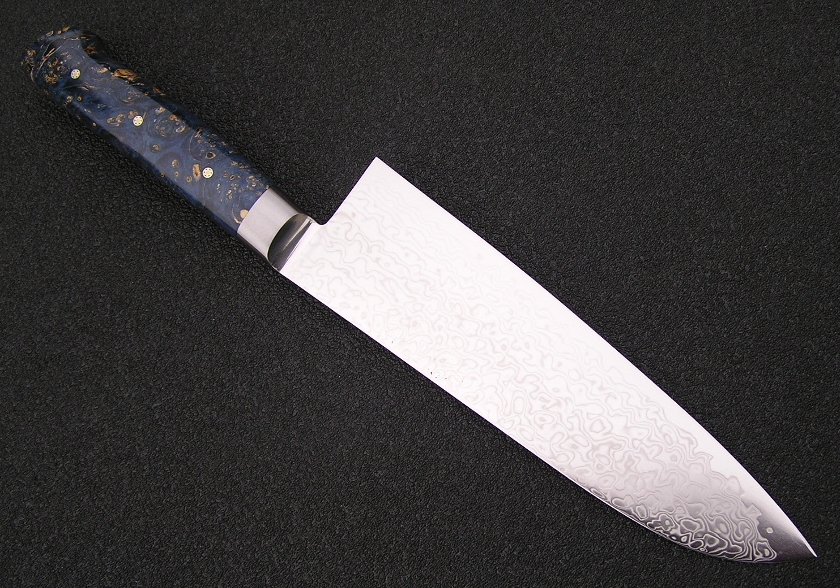

    Here's a few freshly completed rehandles.... [​IMG]
    Hiromoto Damascus 210mm gyuto in blue/green dyed box elder burl
    Hiromoto G3 240mm gyuto in green dyed box elder burl
    Akifusa 190mm gyuto in natural box elder burl

  10. cheflarge
    Frickin' stunning, Dave!!! :D
