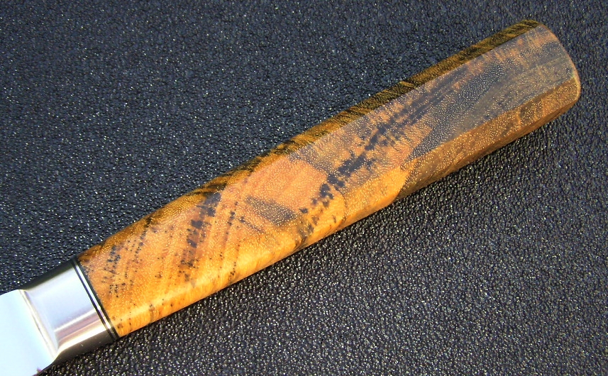

  11. Dave Martell
    Takamura western gyuto converted to a hybrid western/wa octagonal hidden tang handle! [​IMG]
    These knives may not look like anything special in regards to rehandling them but I'm here to testify that they're SUPER challenging. The bolsters are angled, not square, and the tangs are whacked. Unless you want a crap fit up you pretty much have to go to hidden tang but that brings it's challenges too as the rear of the bolsters need to be flattened - ugh! I will be charging extra for these knives in the future. [​IMG]
    I've got two more to do for this set but I finished this one through to completion to make sure that I had it dialed in. What do you think of it?
    The wood used here is stabilized Norfolk Pine.
    P1010003.JPG P1010004.JPG P1010005.JPG P1010006.JPG P1010007.JPG P1010011.JPG P1010013.JPG P1010017.JPG P1010018.JPG
