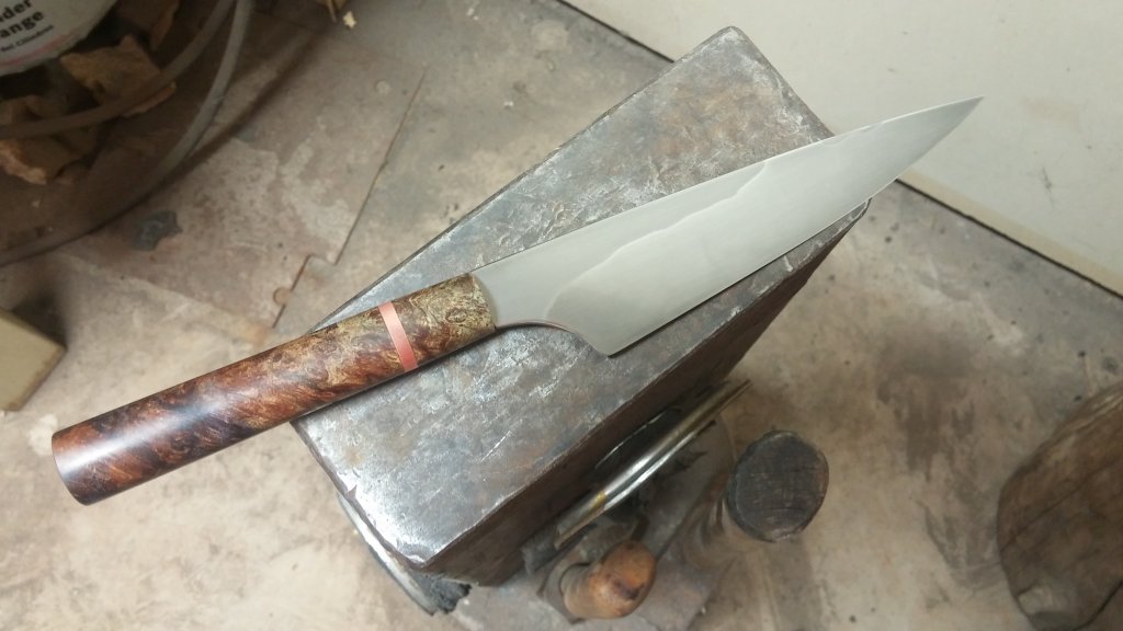

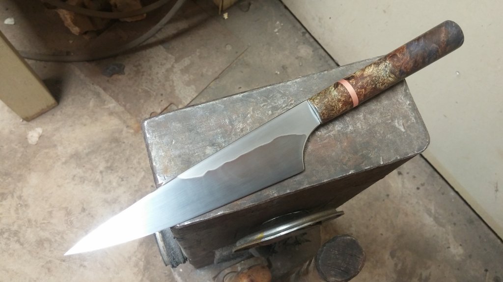

    I did nothing but change the blade's position in relation to my shop lights, and the net effect is completely different. In the first picture the darkened shop ceiling acts as an absorber. In the second, the light colored sheetrock wall acts as a reflector.
