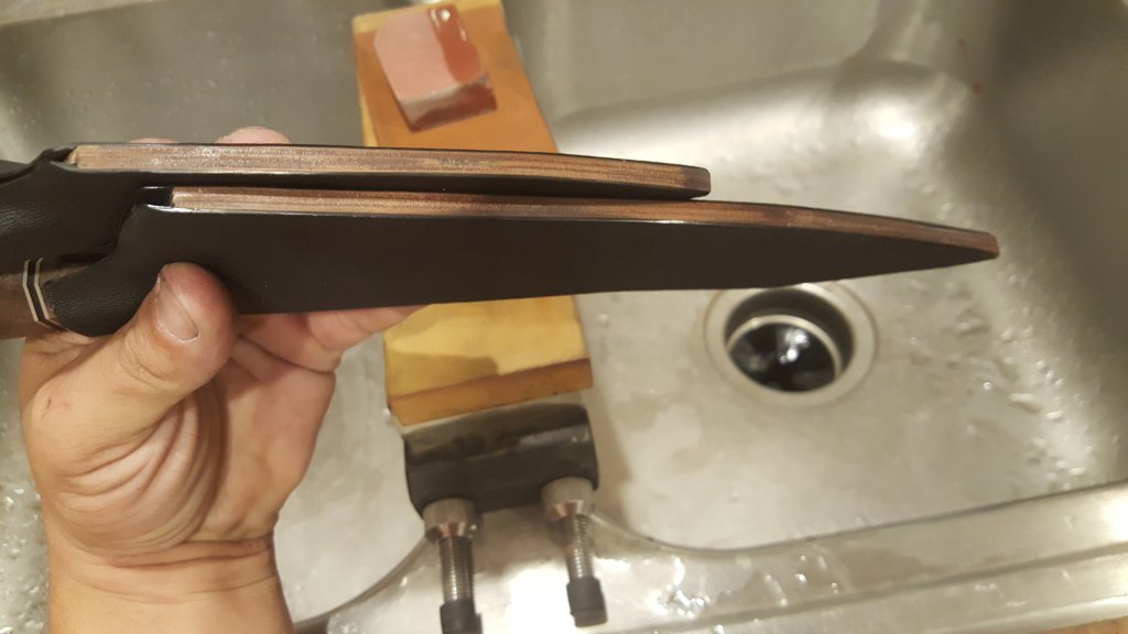

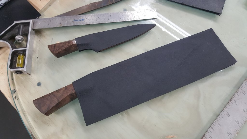

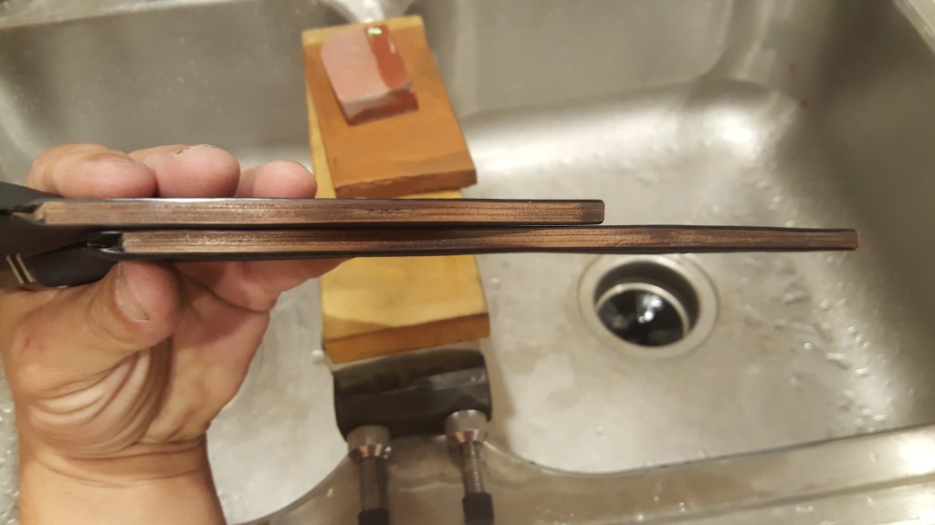

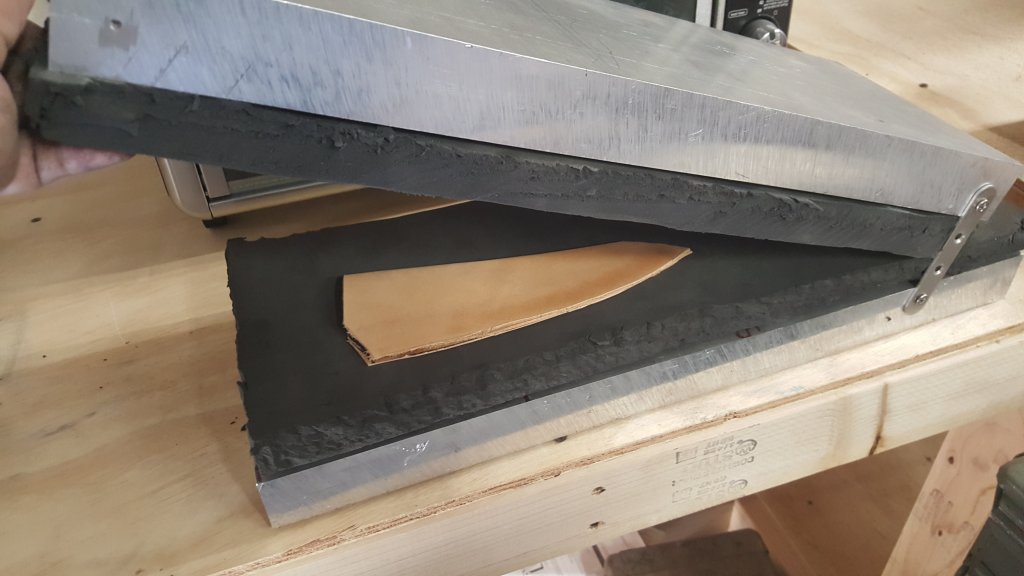

  2. Here's a couple quick pictures of the joint between the leather and kydex:
    All in all it worked out easily as nicely as I expected. The one small issue I'm not pleased with has no effect on its performance, and I'll figure out a way to get rid of it eventually. I don't think you'll find a dual layer saya for the prices I'm asking...if you can find them at all lol.

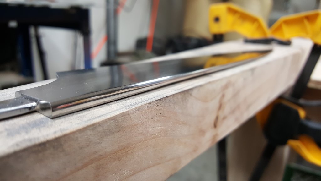

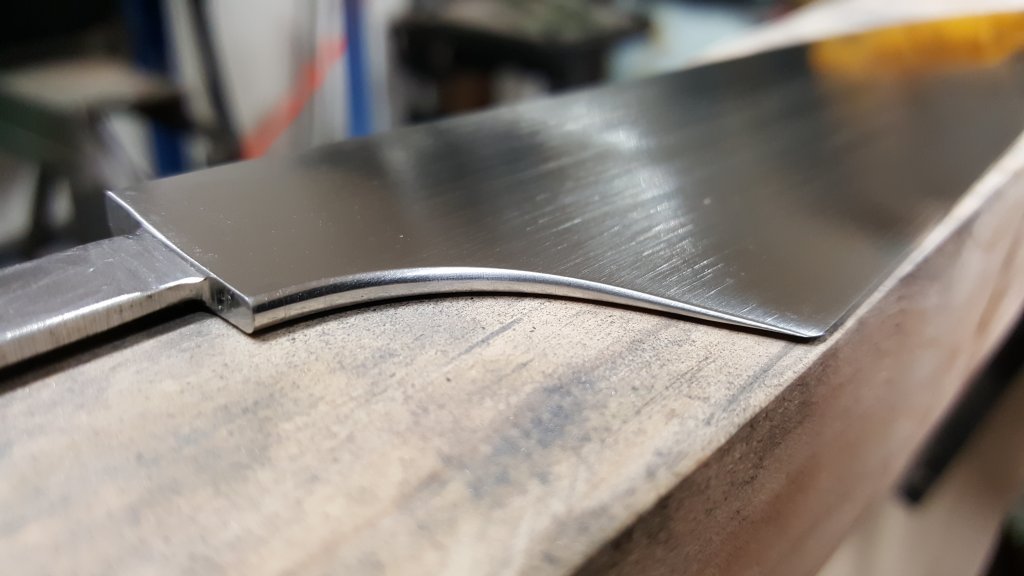

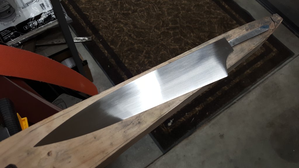

  4. 240mm XH Gyuto, in progress:
    20160424_011217.jpg 20160424_011253.jpg 20160424_011312.jpg 20160424_011329.jpg
    This one is waiting for handle wood to arrive from the customer who purchased it, and should be done some time next week.

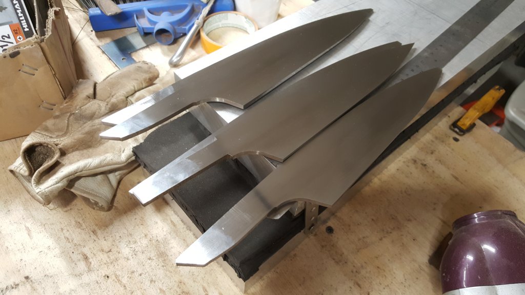

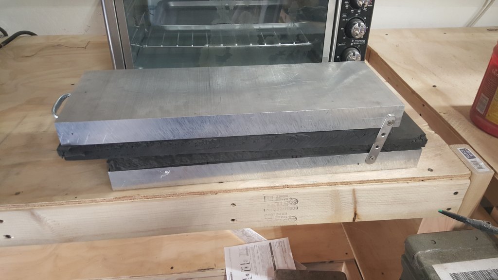

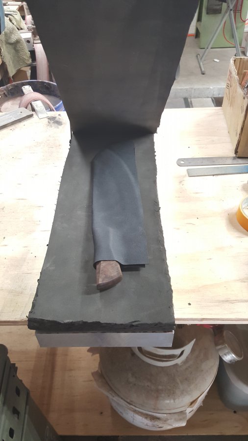

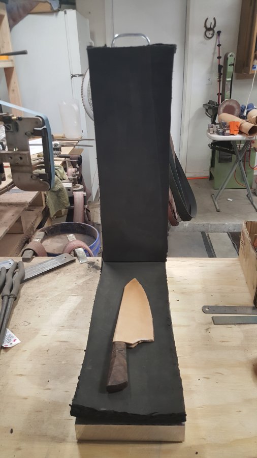

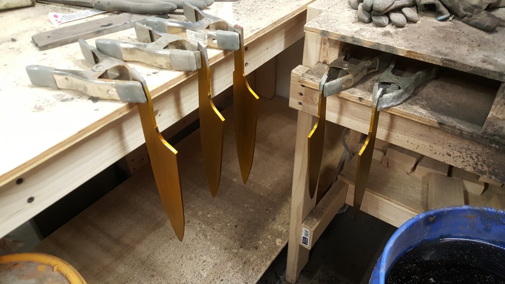

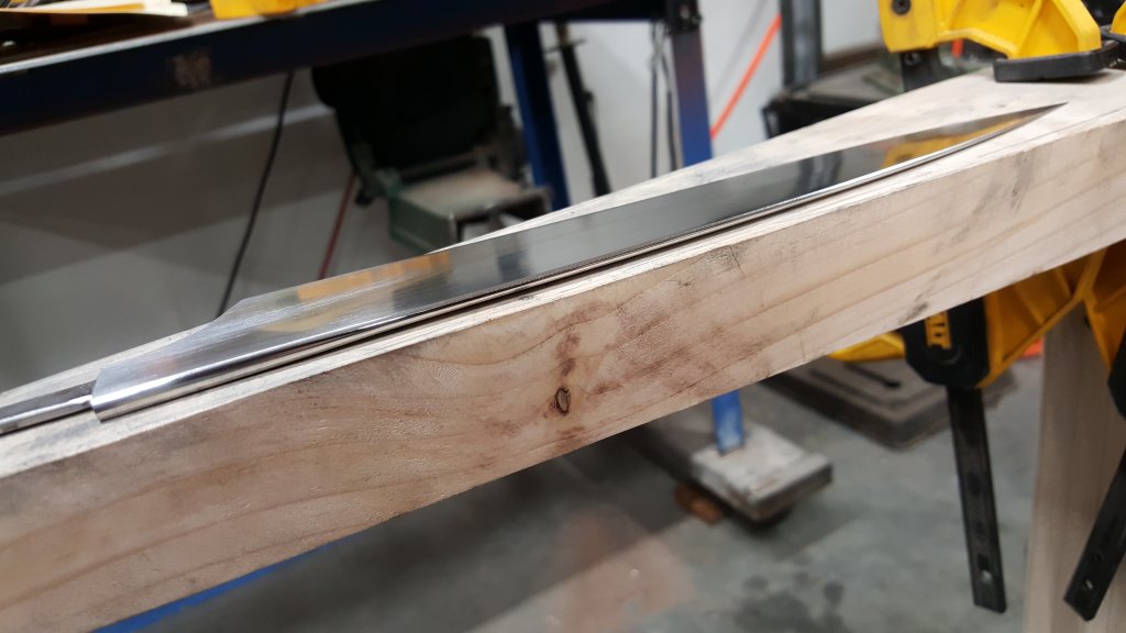

    Here's a couple pictures of today's work, prepping five 220mm XH gyuto for heat treat this week :D.
    I need to get my cryo setup put back together here at the new shop, then they'll be ready to harden!
  7. Yes sir. I find that foil isn't very conducive to successful hardening using my methods (please don't let this deter any of you if you're reading in...it works perfectly fine...just not for me). The coating does the job well enough for the end result to meet my admittedly high standards...so I run with it :D.
  8. Hi @CrisAnderson27, found something similar with the foil, as it's not the easiest thing to remove from large blades prior to quenching blades in oil.

  10. Odd, I thought I replied. I use Turco pre-treat, along with the Turco cleaner that is a mandatory part of the process. It's MUCH more costly than foil...but again, the results work better for me.

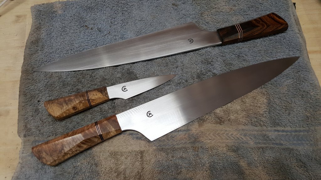

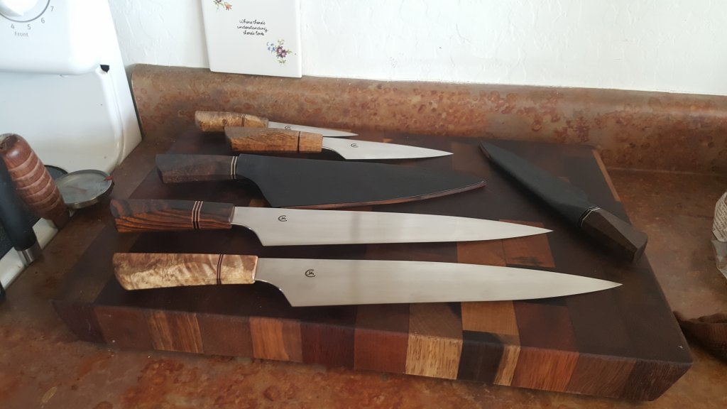

  14. WildBoar
    Beautiful!
  15. Thanks David! I couldn't be happier with the way they're turning out :).
  16. Look amazing, and I bet they cut even better than they look =)
  17. Thanks man!
    They do now, lol. I spent some time and put the edges on them today.
    Definite cutters. I prepped a bunch (ok...WAY too much) of stuff for lunch today with the two gyuto. VERY different personalities in both knives...but they absolutely do the job.
