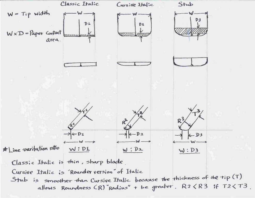

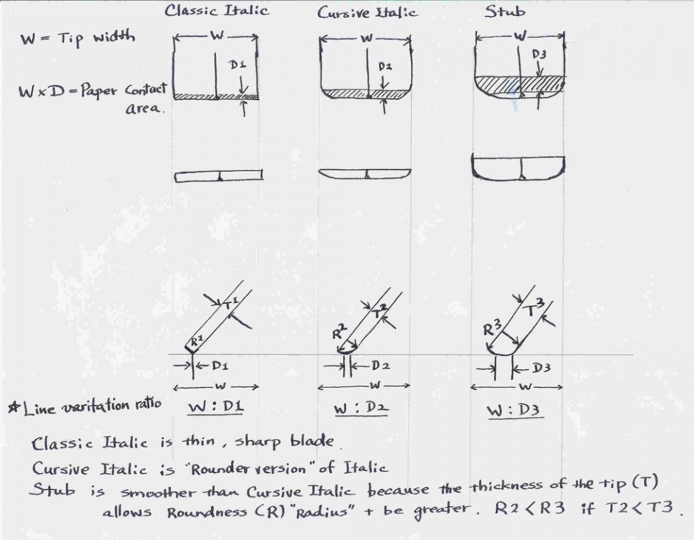

    That would be a stub, italic, oblique or any nib that is wider than it is tall. I have a 1.1 stub that I like a lot. They make different size nibs, and you can even get one custom made, or massage a stock nib to whatever you like.
  2. James
    Italic or stub, you depending on the pen you may have to have someone grind that for you. A stub is a halfway point, will give you the look while still being smooth, but not as crsip lines. A cursive italic has sharp corners if you use to much pressure or dont have the angle down the edges can catch, but it looks way more crisp in the line differences

    So this image illustrates the difference in specialty nib grinds. It's from the Franklin-Christoph website... worth a look.

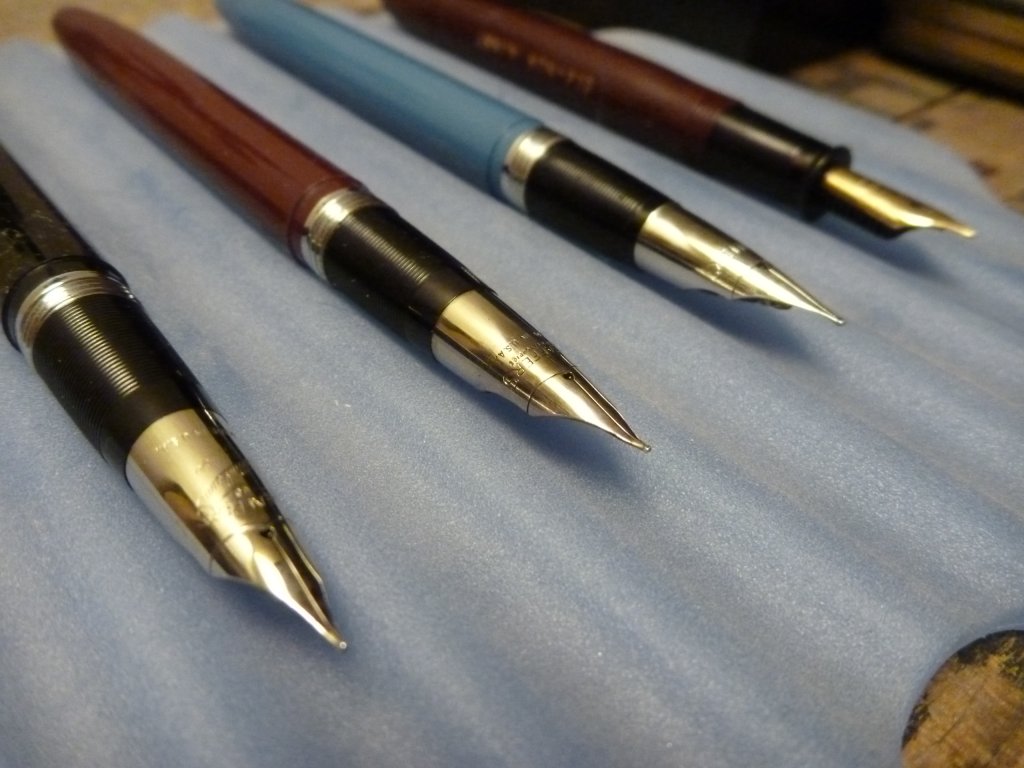

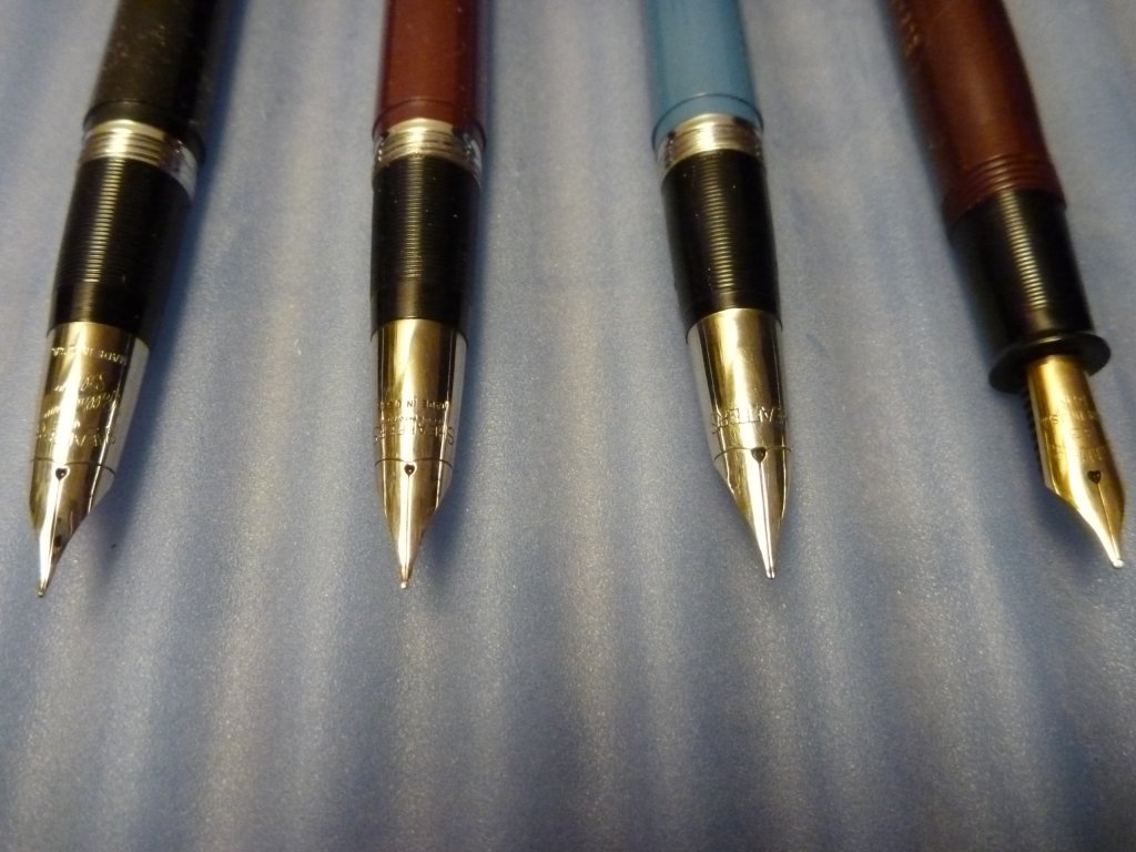

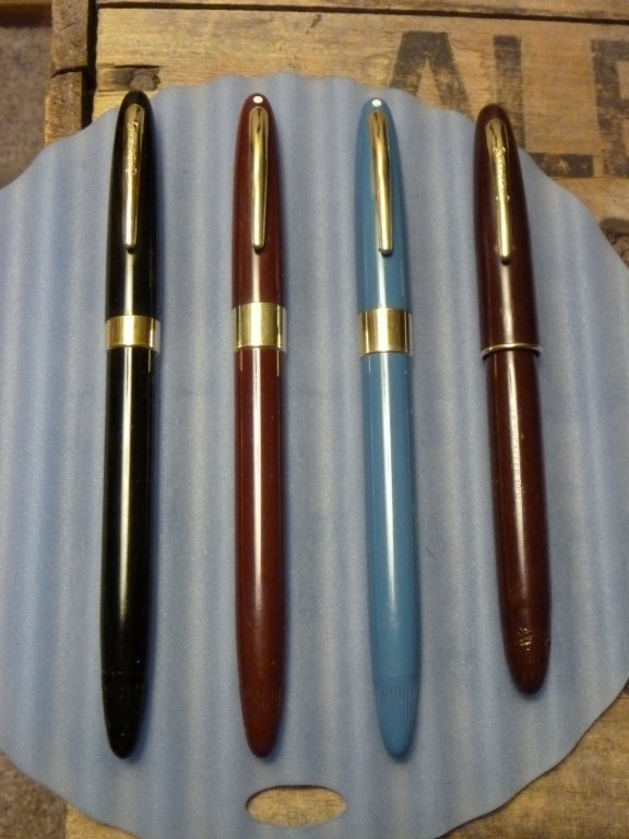

    I just got these four Sheaffers back from Danny Fudge. He did a nice job getting them back into working order, and the turnaround time was lightening fast. These are all old family pens. On was my dad's and one was my aunt's. Both of those (the burgundy pens) are engraved with their names.

    The burgundy with the triumph nib is one of those pens I've wanted to try for a while, but I was underwhelmed by the two old Scheaffers I had and lost the motivation to keep looking around.
  16. John Fout
    I loved my diamond shaped triumph nib before it started leaking... This is all pre-Pelikan days so I probably wouldn't like it now. :)
  17. Andrew
    The nib on the black snorkel is a little loud/rough. It just needs tweaking and smoothing. The other three are really nice to use as they are.
