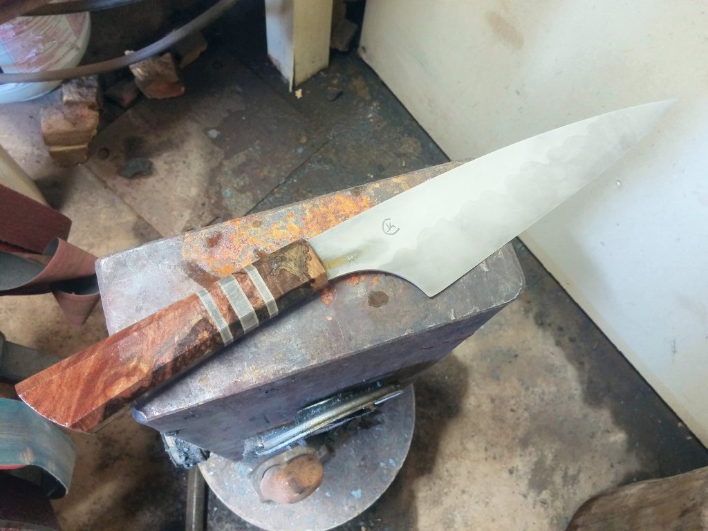

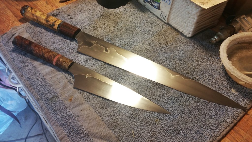

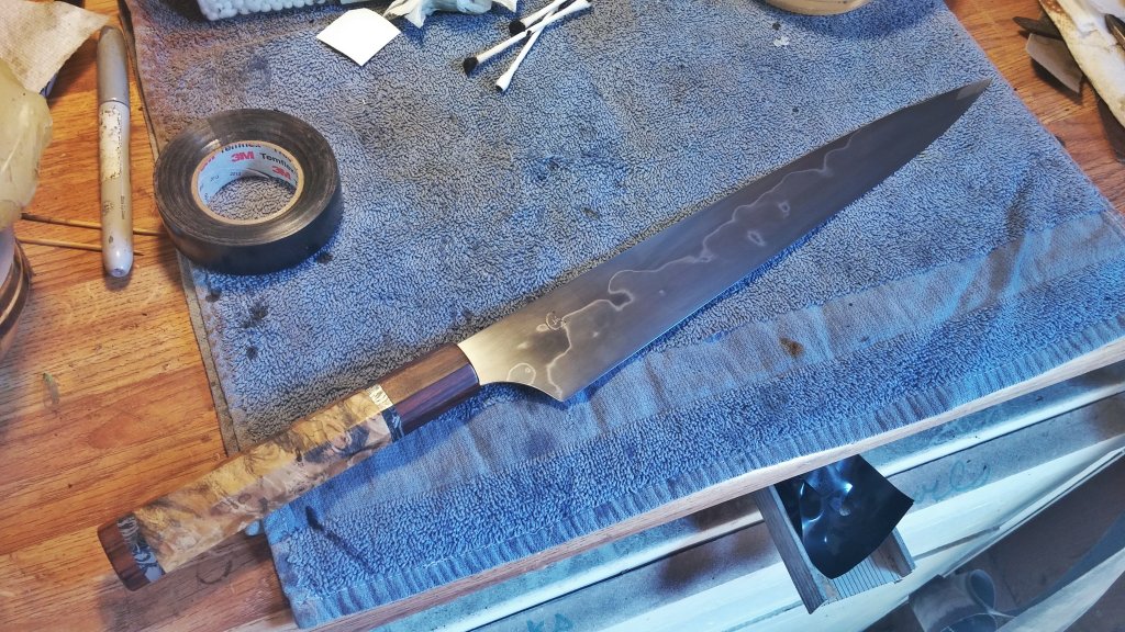

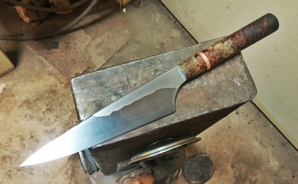

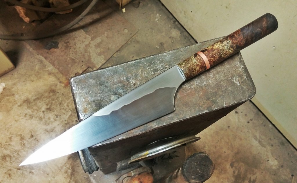

  1. Yeah, that's baking my biscuit right there, Buddy! The 'standard' hamon looks so classy!! Nice one, Cris :)
  2. Thanks man!!

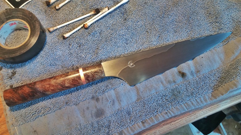

    I've got two more with similar lines being ground next week. A 150 petty and 210 gyuto :)
    The suji has one of @mkriggen's handles on it :D.
  4. mkriggen
    mkriggen Founding Member
    Bro, that is some beautiful wood in that handle! What is it, spalted maple?
    Be well,
    Mikey
  5. Thanks Mikey! Its actually dyed box elder burl :).

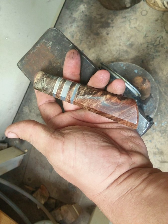

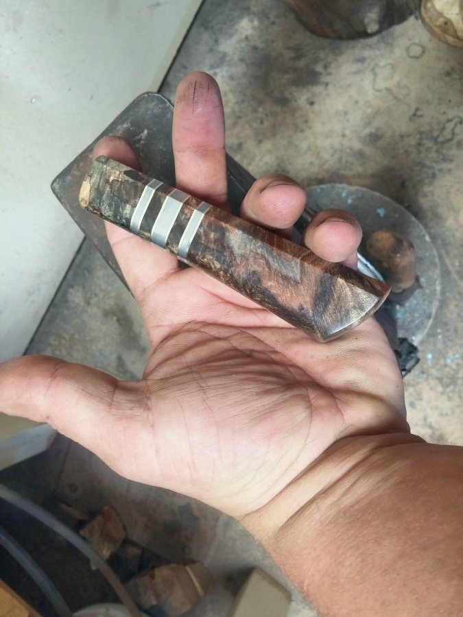

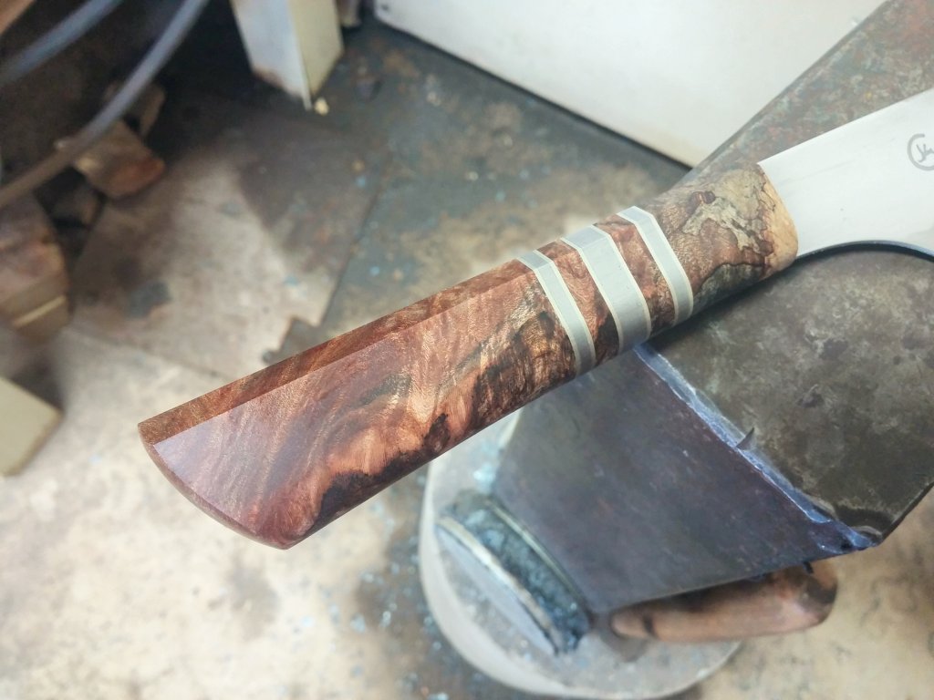

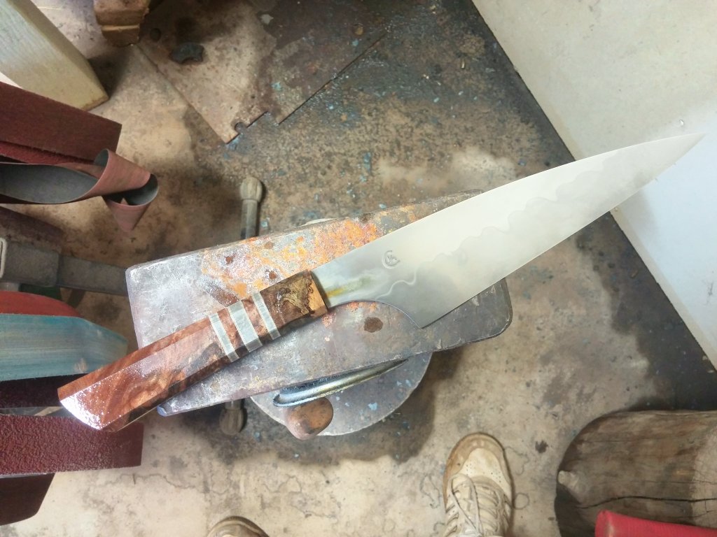

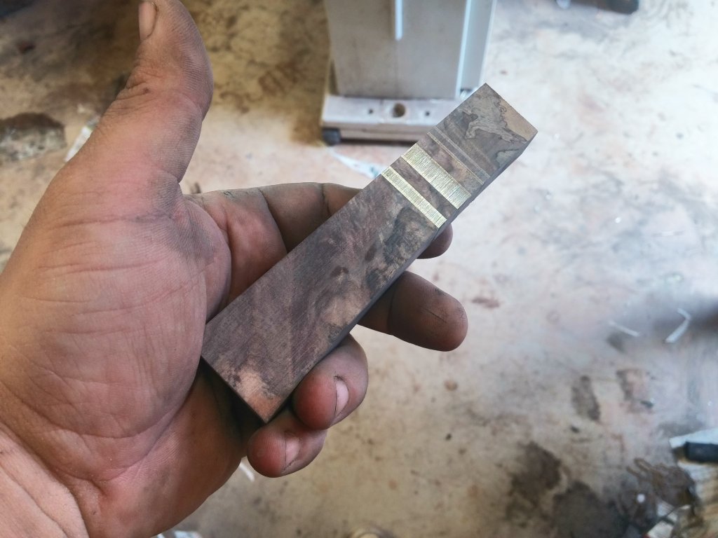

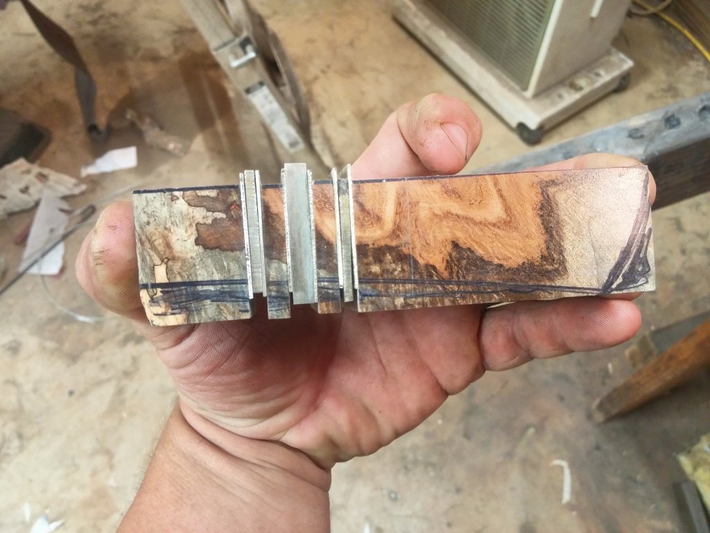

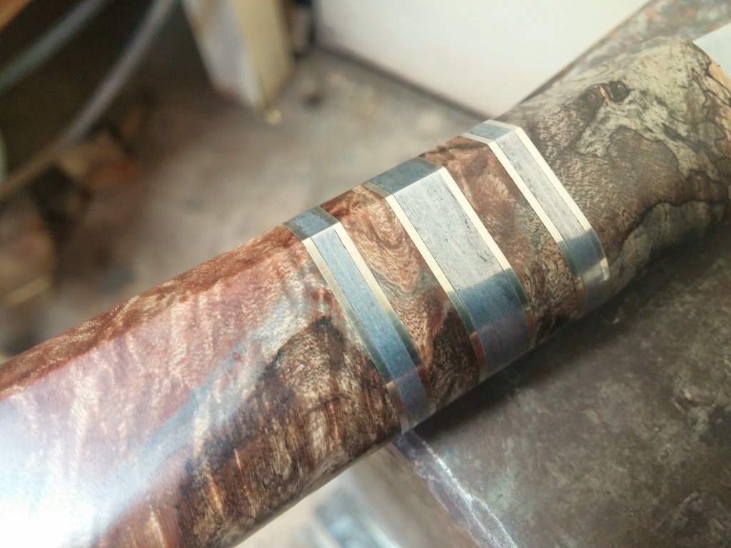

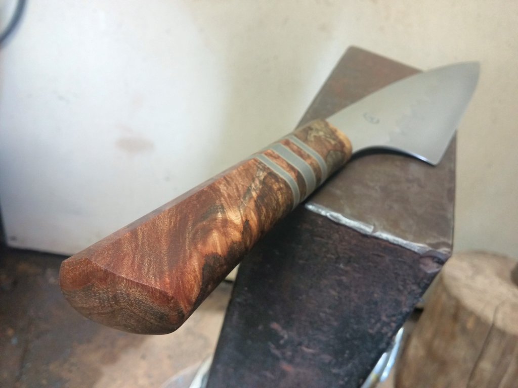

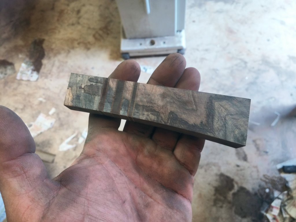

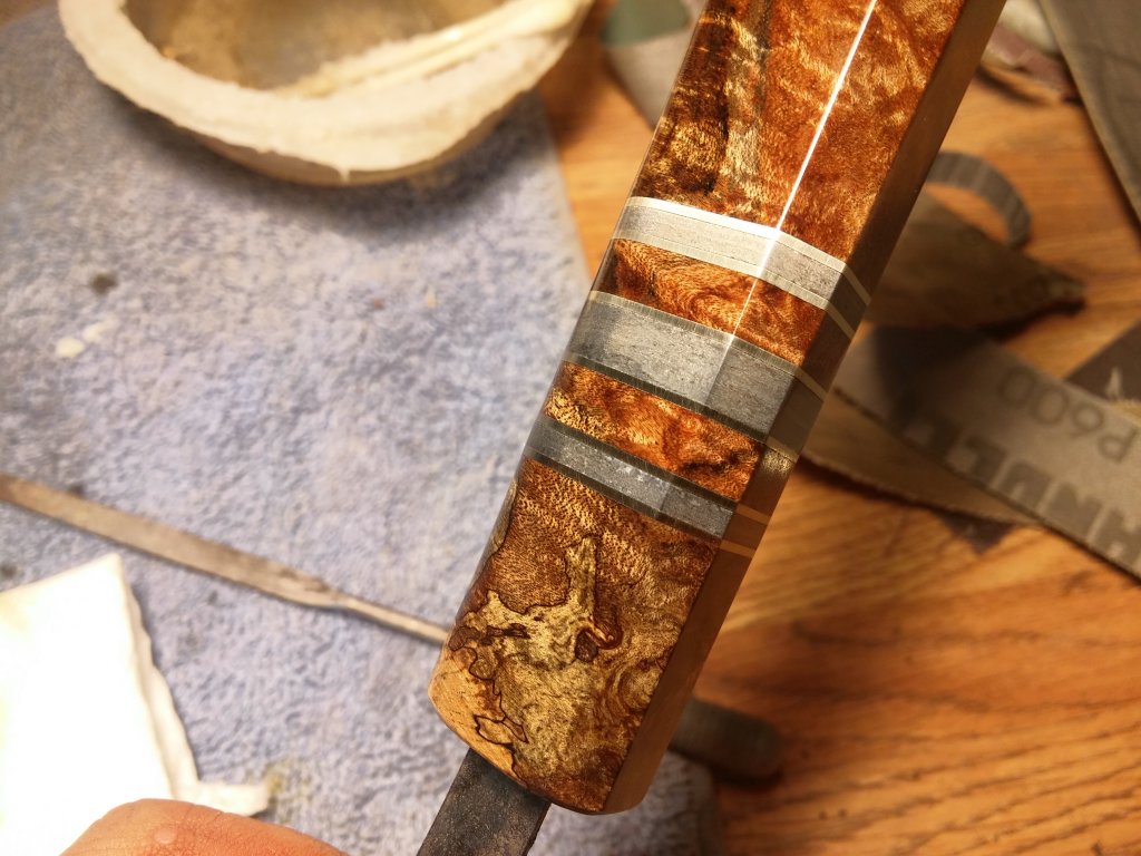

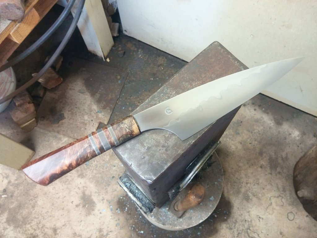

  6. New handle for ko-gyuto #1 lol:

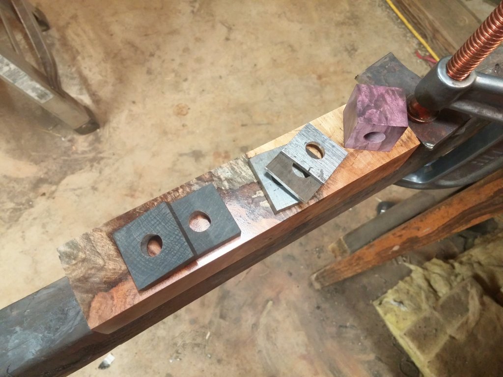

    I started with some 1800's wagon wheel wrought iron (from an 1850's conestoga no less) and forged it to suit my goal of being able to get three separate spacers in two separate thicknesses out of it.
    Here you can see the spacers flattened, cut, and drilled. You can also see the spalted Oregon maple burl from Mark at Burlsource that I planned on using for my main handle material. I considered using the purple or the bog oak as well, but scrapped them both in favor of some 16ga nickel silver to bracket the wrought iron.
    Here they are stacked, with the rough outline of the handle on the side of the blank.

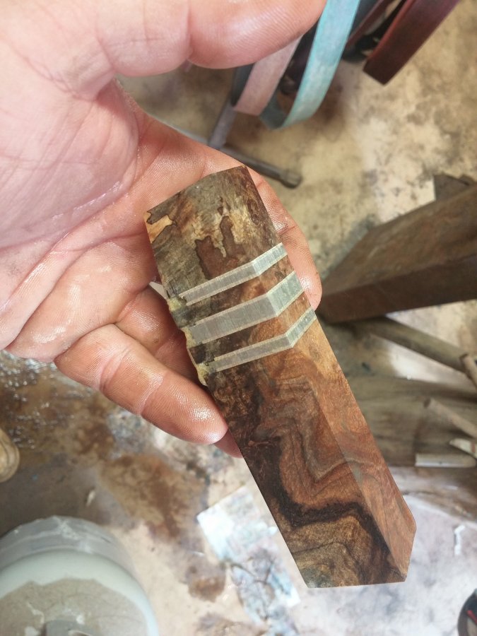

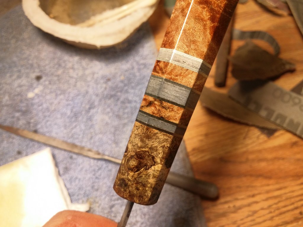

    Getting thing shaped. The first step is to get the blank square to the tang hole. You can see the contrast of the wrought bracketed inside the nickel silver already.
    No tapers as of yet. The key to making the handle work is to get everything square first. After that you can cut in whatever tapers you like.
    Here I've cut in the curve on the bottom of the handle. From here I cut the rounded butt, then my facets. The end result was really clean, and I almost left it that way.

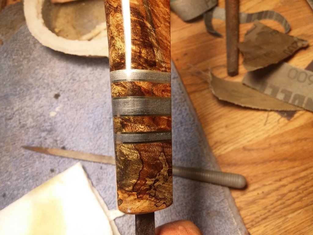

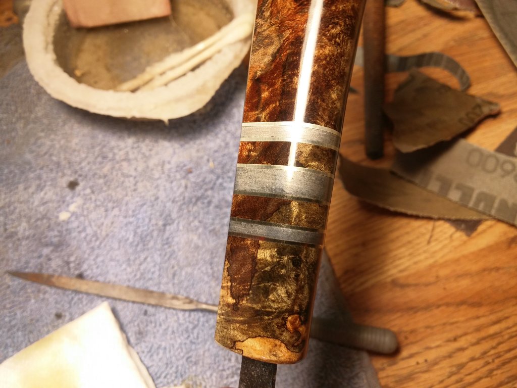

    As I said, I almost left it like this lol. In the end what decided me was balance. The removal of the extra material on the grip side of the handle would help move it forward a small amount, and on a small, ultra thin knife like this, that is a benefit you can't overlook.
    And the result. This is after all of the rough shaping. It still needs polished out and oiled...and for the iron to be etched to show the grain...but even like this I think it's beautiful.
    In hand.

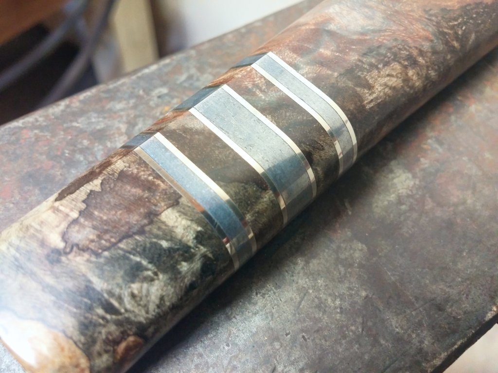

    Here you can see the grain of the wrought after about ten million etching cycles in vinegar. It turned out very much as I was envisioning...if a bit less 'contrasty'. Still...I'm not complaining at all!
    20150426_190443.jpg 20150426_190458.jpg 20150426_190508.jpg 20150426_190516.jpg
    A few more pictures of the etched wrought with the nickel silver brackets. I think this is truly my favorite handle to date :D.

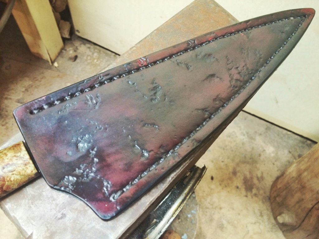

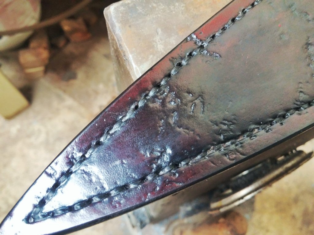

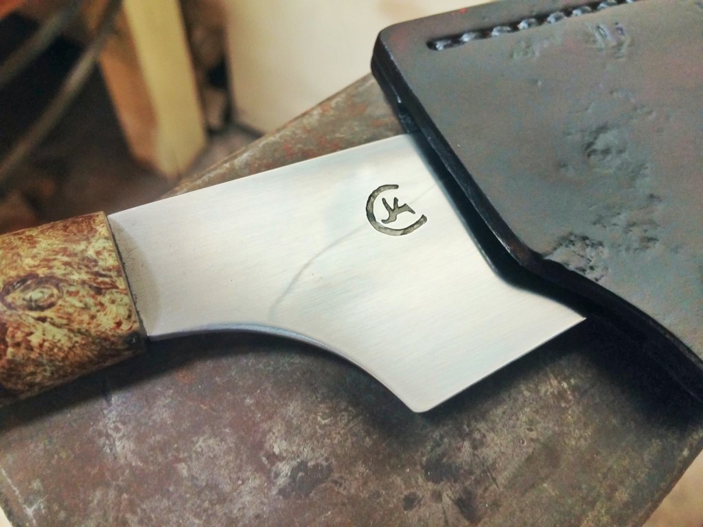

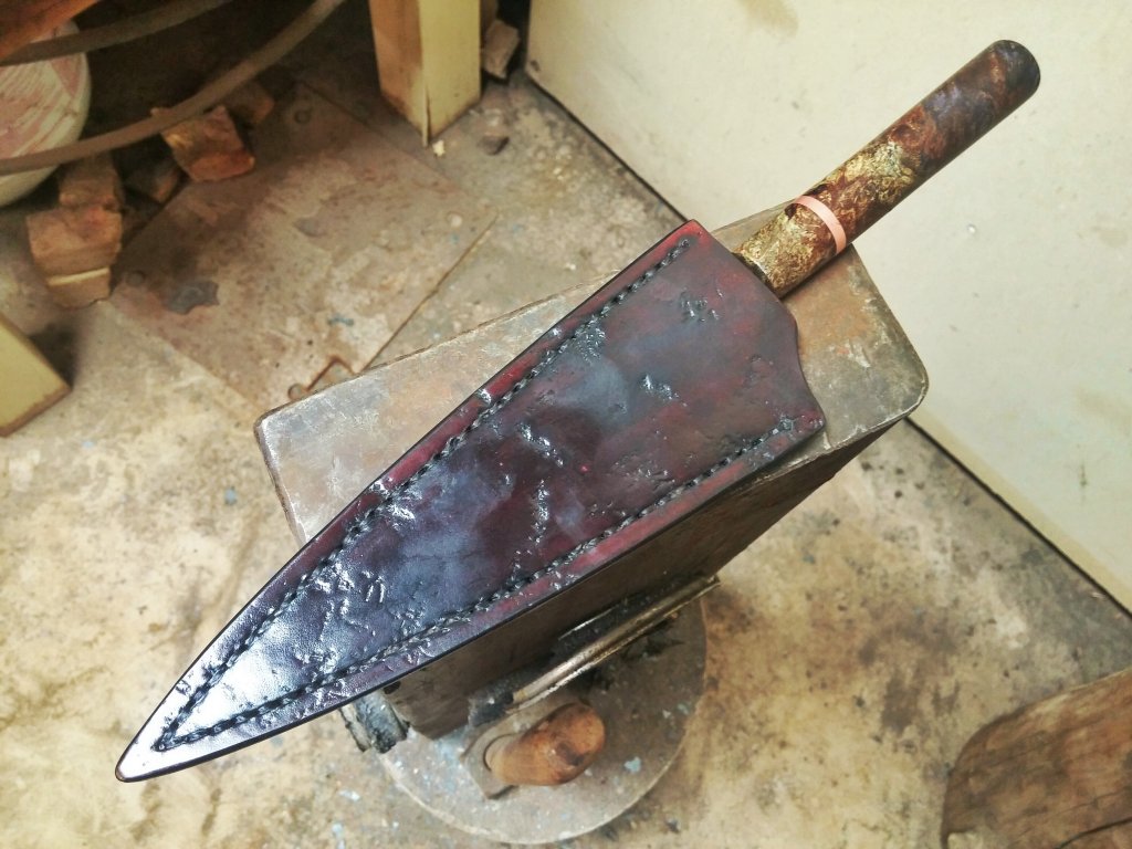

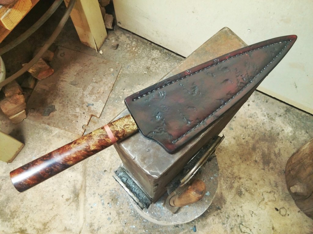

  9. Second leather saya...
    20150427_212450-01.jpeg 20150427_212513-01.jpeg 20150427_212536-01.jpeg 20150427_212543-01.jpeg 20150427_212629-01.jpeg
    I decided to go with a distressed look on this....simply as a matter of personal preference lol. This saya is obviously head and shoulders above the saya on the passaround (which is getting mailed tomorrow)...mostly because the passaround saya only has to protect the knife. This one, a customer paid for.
    Anyhow...that's what was on my bench tonight. Thanks for looking ;).
  10. Toothpick
    So have you bought an industrial sewing machine yet? or a giant hydraulic cutter?
    If so we are missing pictures...
    If not what is your method for making the leather saya?
  11. No industrial sewing machine lol...just two hands! Same for the cutter...I used electrician's snips :p. The method to make them is actually not difficult.
    Basically you cut two sides, cut a welt that fits the blade to go between them, and glue them together. Then you run a line for your stitches...and punch, drill, or otherwise make room for the needles to pass through the leather. Apply any designs you like to the leather, as well as any dyes, and stitch it up with waxed string in a saddle stitch. From there, I spoon lard into the opening, and use the blade to drive it into the saya until its thoroughly coated...and melt it in while I'm melting beeswax into the outside until it won't take any more. At this point the leather is HARD like leather armor...waterproof, and won't rust your carbon steel knives.
    Now, I've skipped a couple steps...like dressing and buffing the edges, how to tie off the stitching etc...and other small steps. But the above is the basics of it. Trust me. This is my second saya...lol. Its not difficult. The main reasons for the upcharge are the astronomical price of leather and quality tools to work it...and the time involved. This sheath took me about 4hrs to complete...from cutting the leather to buffing the wax coat...and I only charged $40 for it. That's $10/hr and that doesn't account for materials lol.
    I'm honestly considering raising prices a bit and including them with my knives. The protection during shipping is worth it alone...and having a safe place to keep the knife for storage and travel for the end user is priceless.

    Thanks on the sheath!! For the color, I first use Eco-Flo Antiquing Gel #2607-01 Black. I don't put it on evenly...just all over in globs, with at minimum thin smears covering the entire sheath. I let it dry some then rub it all off, then take it to the buffer. MOST of it actually goes away. Then I go over the entire thing with Eco-Flo Leather Dye #2600-11 Scarlet Red. This stuff is almost pink it's so red...and the sheath will look goofy. Again, let it dry, buff it, and take a look. If some spots are too red, go back over it with the black and let it soak in longer...then rebuff. Remember also that the wax saturation darkens the color up some and plan accordingly.
    I get my leather and dye from Tandy. I've been using single shoulders because they've had them on sale for $30 which is a steal considering a similar double shoulder is like $100 lol. Depending on the sheath, I'll use different thicknesses. Mostly for (my very thin) kitchen knives I'll use 6oz sides, and a 3-4oz welt. My EDC sheath is 80z sides with a 60z welt. Make sure you get vegetable tanned stuff. It'll still rust the steel if you don't treat the inside, but it's far less caustic than the chrome tanned stuff.

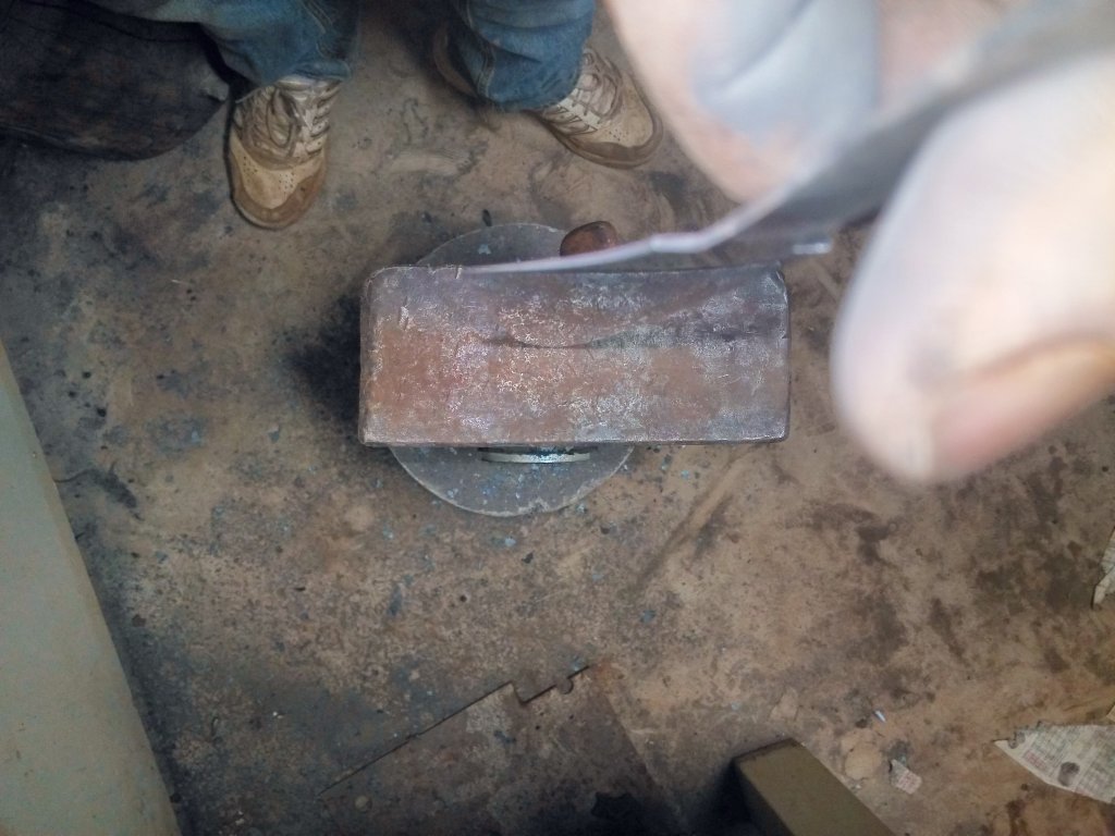

    Hey @Toothpick!! I need some help finding @strumke's 280mm suji. Think you could help a brother out??
    I'll even give you a closer view just so it doesn't bite ya :D!
    I think I should go into the puzzle making business lol...anyone agree?!

  18. Very nice! I'm trying to catch up. How did you taper/round the handle and make the facets? Did you use a belt sander?
