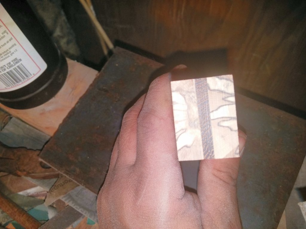

  1. Laser=So thin you can't see it with the naked eye
  2. Do you mean on the maple/nickel/wrought handle? I use a belt grinder for anything that requires flatness. The oval/rounding is all done by hand.
    Lol...it's ok...the sneaky bugger bit me too!
  3. Yup, that's the one I mean. I'm trying to figure out for myself how you make such handles. (And I've read a couple of how-to's already.) What I wonder is how a belt sander (in which the belt has some give) can make such straight surfaces. Funnily enough I thought that you'd do the rounding with a belt sander.

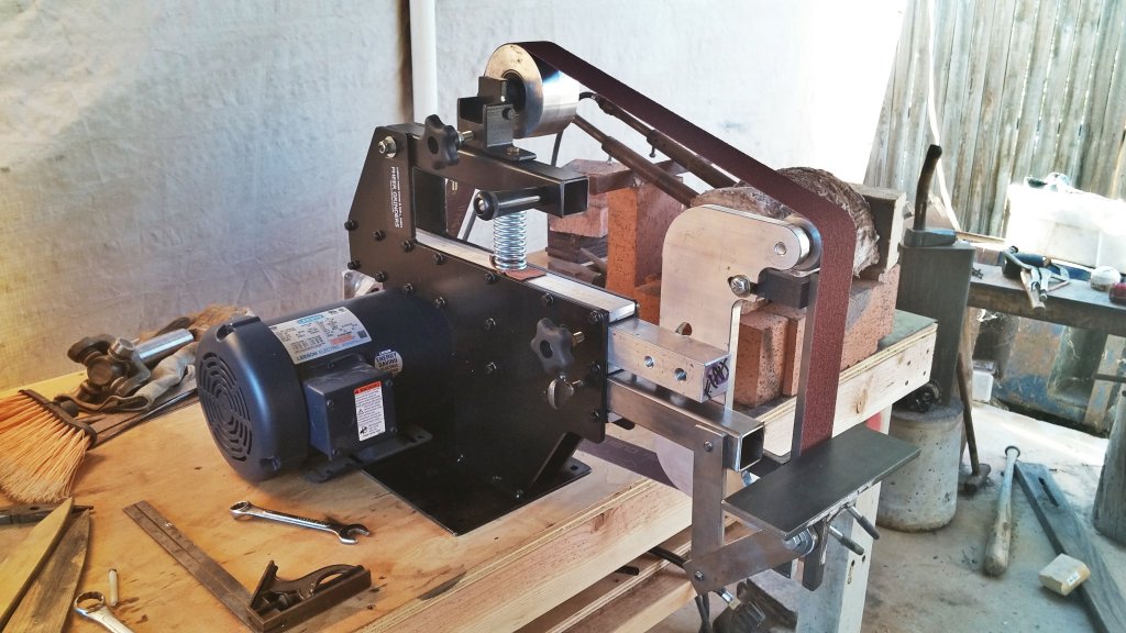

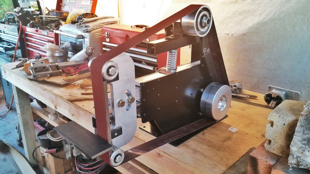

  4. This is my belt 'sander':
    Or rather, that was it when it was new lol. It's a 2hp variable speed 2x72 belt grinder. There is no give against the platen, though I can remove it to use the belt with some give (slack belt). Even my old 6x42 sander, which actually WAS a sander...had a hard flat platen. That's what I made all of my first handles on btw. There's a 'how-to' here:
    http://www.kitchenknifefora.com/threads/my-method-for-making-wa-handles.1202/
    I do things a little differently now...but that is a good enough tutorial to get you started.
    On the rounding...I found out very quickly that even at low speed, it either chews through wood insanely quickly (too quickly for me to control reasonably...my first oval handle almost ended up a toothpick!), or is so slow I may as well do it by hand.
    Soooo...I do it by hand. It's more accurate anyhow...and I have better control of where and how material is removed. For example, on the handle we're discussing, the wood would be removed at a far, far greater rate than the wrought/nickel. If I had tried to shape that with a belt, it would have left huge dips to either side of the metal (again...I found this out quickly on my first oval handle!). Being able to control the rate and location of material removal is mandatory for me.

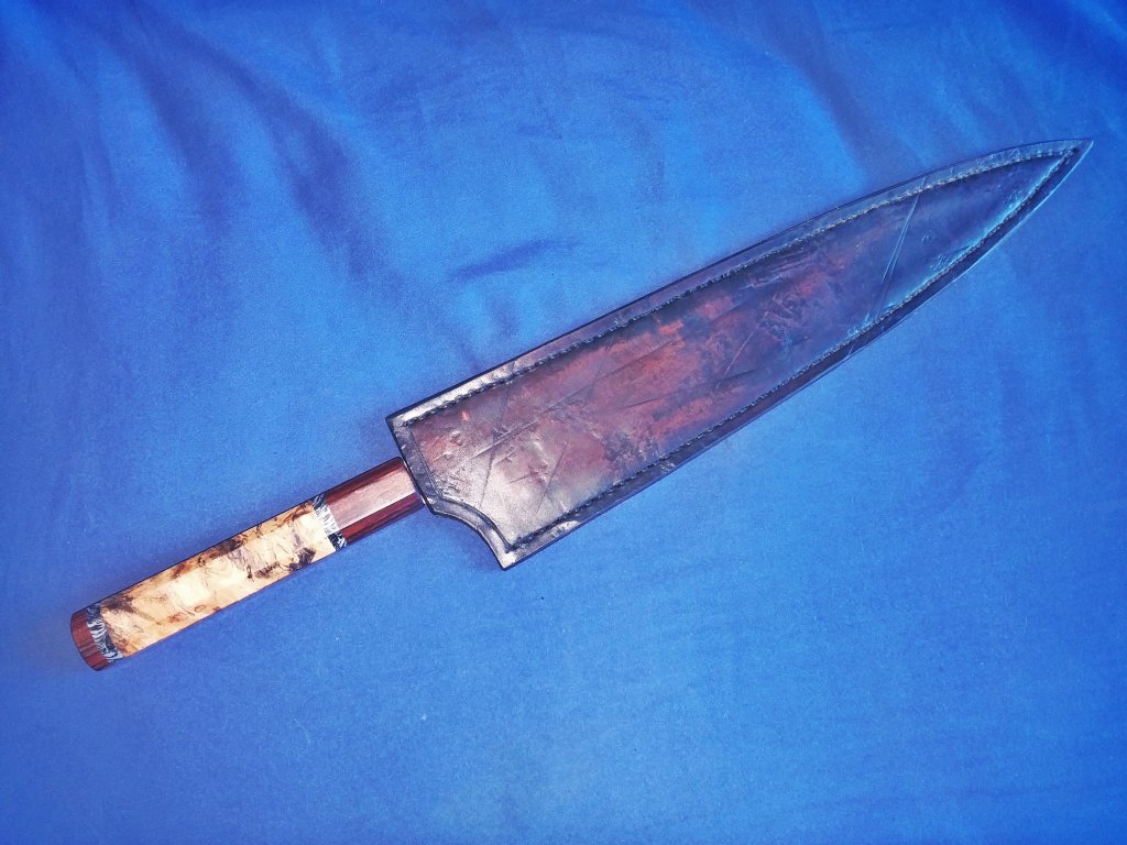

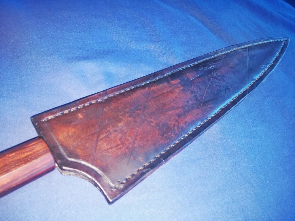

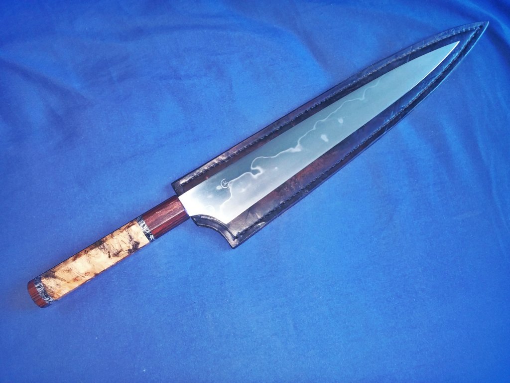

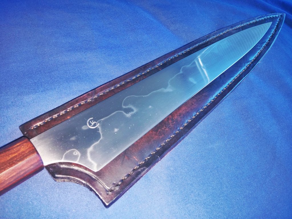

  5. Today we have @strumke's finished 280mm suji with a freakin gorgeous @mkriggen handle and my distressed saya :).
    20150503_115107-01.jpeg 20150503_115117-01.jpeg 20150503_115133-01.jpeg 20150503_115139-01.jpeg
    Loving this knife :D.

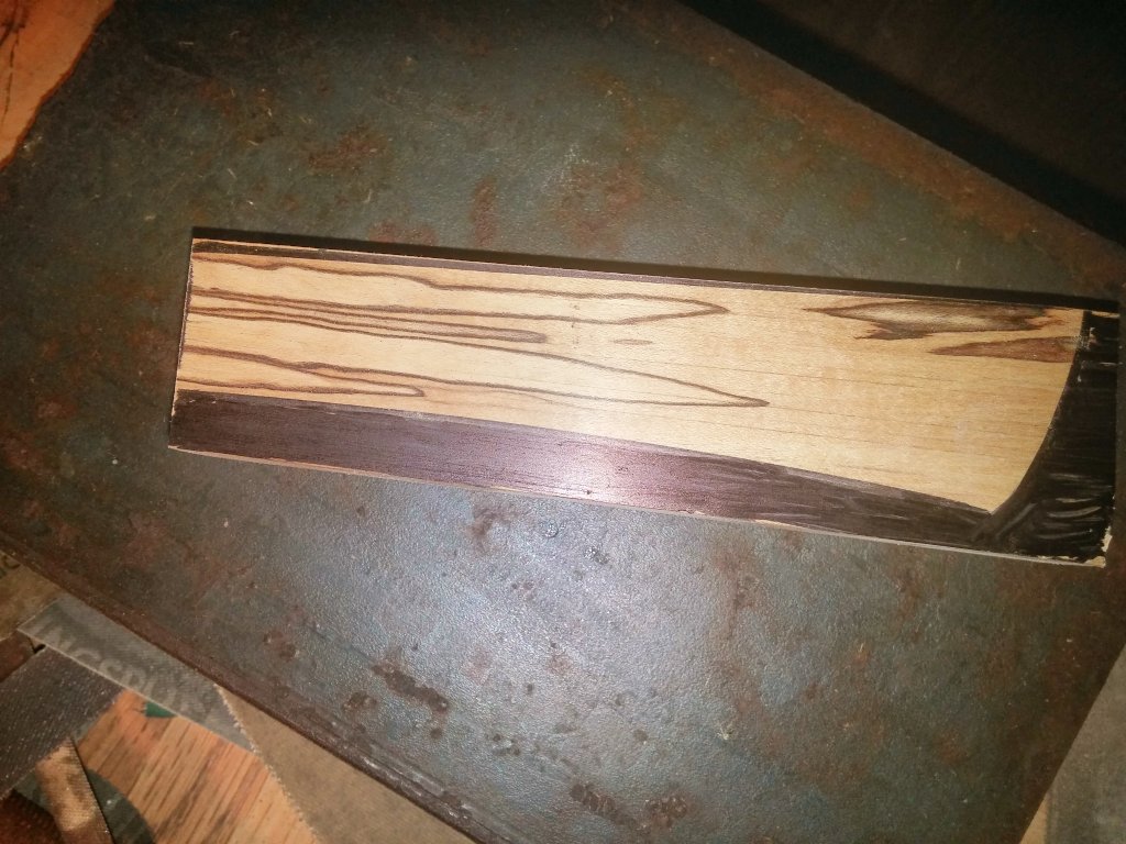

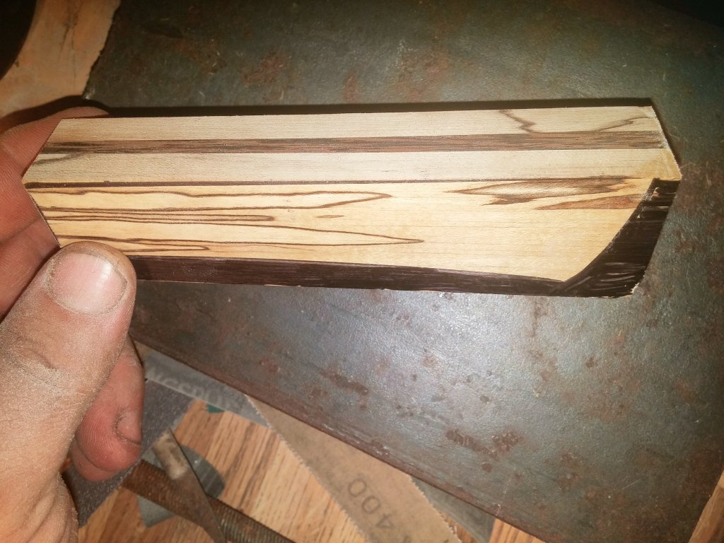

    So...what do you all think of this?
    I made this laminate blank almost two years ago...and have been sitting on it undecided as to its fate. I mean...the spalting is cool...but it was kind of...I don't know...on a standard wa handle it just seemed wrong. On a flared half round though...that could look nice maybe. There's plenty of spalting through the blank as well...you can tell by looking at the ferrule.
    Hmmmm...

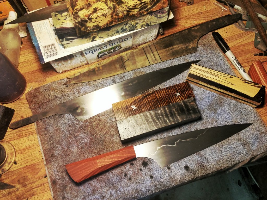

  10. What's on my bench tonight!
    Robert's ko-gyuto all polished up, sitting under the handle blank prototype I made for it (I've started rubbing the pine down with iron oxide paste so I can see the bevels! Seems to work well lol). Robert and I have been going back and forth between the koa and black mango pictured for this handle...and only just tonight decided on one. I'm curious which you guys like best though ;).
    This handle setup is going to be kind of cool, but I won't spoil it before it's done lol.
    Also pictured, 270 gyuto-hiki, and two 270 gyuto that just got straightened tonight. None of those three are orders, and will be up for sale if anyone would like to jump ahead in line :).
    Thanks for looking ladies and gentlemen!

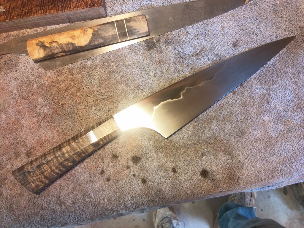

  13. A quick (very) little video showing off Robert's ko-gyuto. :D

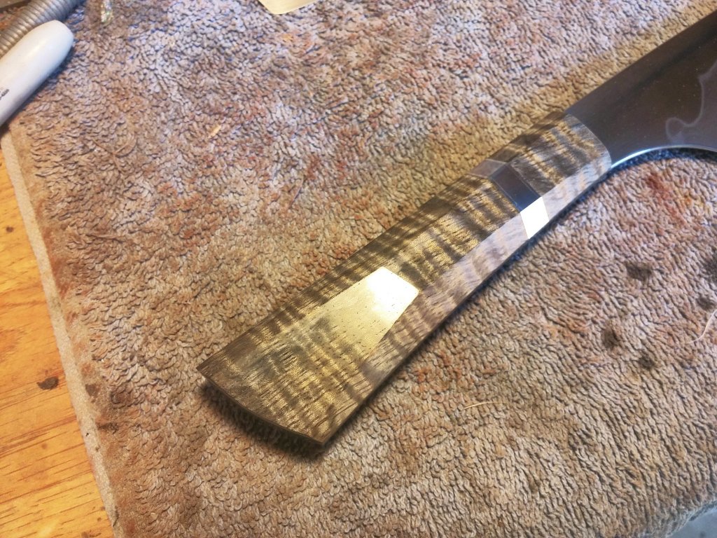

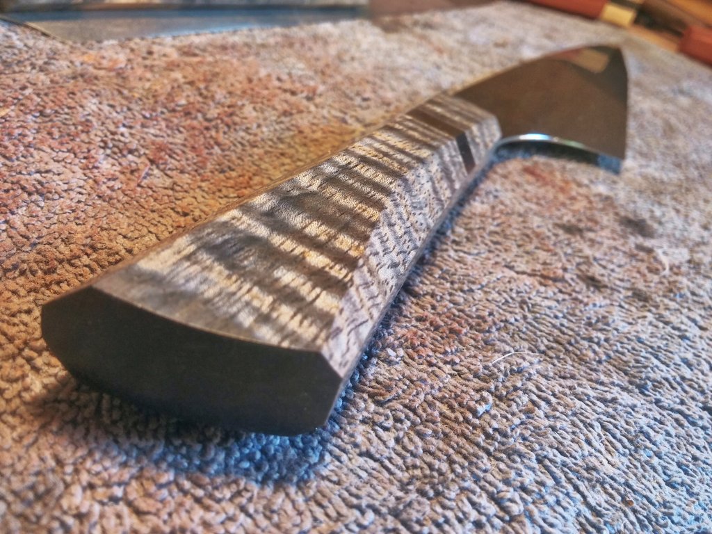

  14. Getting closer....
    20150507_132425.jpg 20150507_132126-01.jpeg 20150507_132136-01.jpeg 20150507_132146-01.jpeg
    So...the facets. What do you all think? Personally I'm freakin in love with the things, lol...and may actually modify the passaround's handle to have them when it comes back. The knife is SO light that removing as much material on the handle as we did (credit for the initial idea goes to Robert!) went a long way towards getting the balance point forward. As it sits the knife weighs 117g (it's 185mm), and the handle is 52g of that (mostly due to the wrought iron). The balance point is about 1cm in front of the ferrule. The knife feels good in hand, but I'm used to neutral balance knives that are feather light lol...so it's tough to say what you all might think.
    Anyhow, there it is lol. What's on my bench today :p.

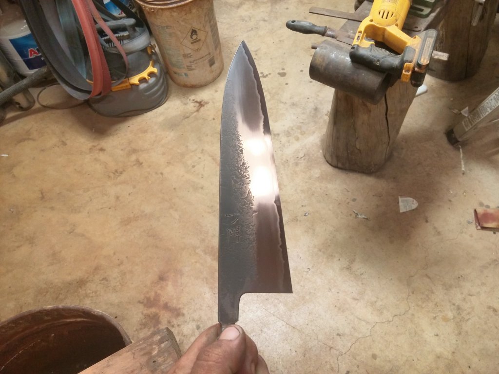

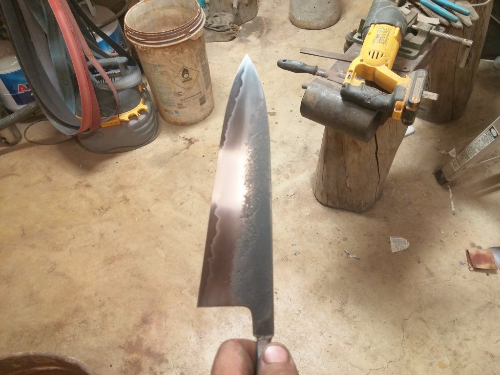

  16. Reprofiled and reground Ichinimon :).
    212mm, and 50mm on the heel. Its a sweet little cutter for sure :).

  19. Thanks for the quick explanation and kind words Brad!!
    Paul, Brad covered it pretty well lol. Ichinomon/Itinomon are a brand as he said. Robert (who owns both of those knives btw...both my ko-gyuto with the sculpted handle and the Itinomon) asked me to reprofile it and regrind. It really was a great cutter from the start...but I think this profile is much more useful, feels much better on the board, and cuts better as well. Honestly, it's a great little knife at the initial price point, but I think the cost of the modifications I made vs the improvements were a value as well.
