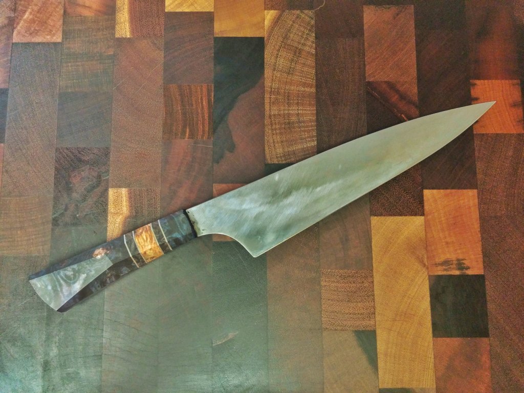

    The handle was one I made for another knife for Robert. When we switched projects we kept the handle for him to use on another of the projects I'm doing for him. The Itinomon ended up with it.

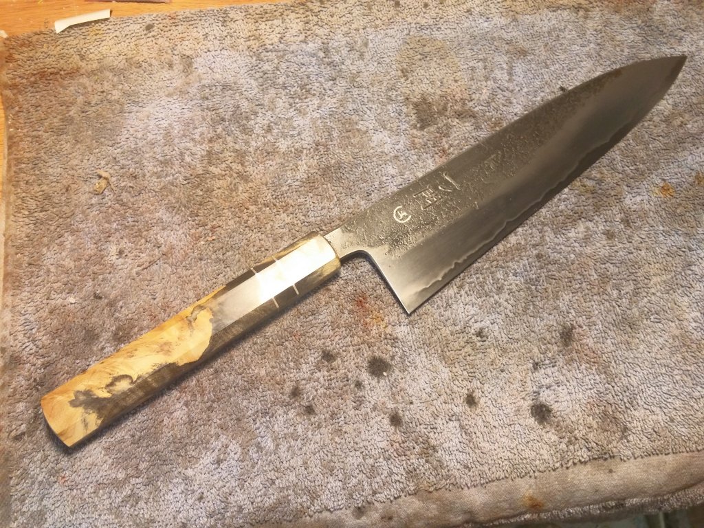

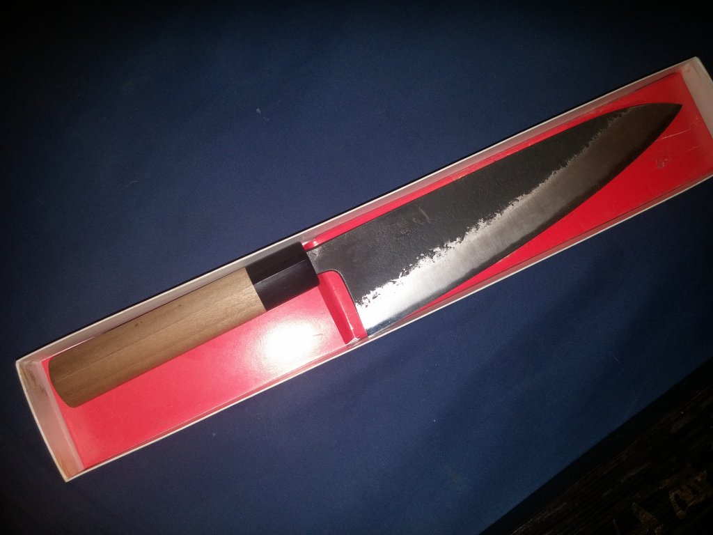

    As for the original knife, here it is before I started:
    And now:
    It's actually still 212mm...so no effective length was lost. The edge profile is a substantial improvement though, along with a few other tweaks I made :).
    On the DMT plate, I mostly use my grinder for it now. I still use the DMT to do the last 1" before the tip though so I don't burn them up. I'm still using the same DMT plate I bought originally...what, two years ago??

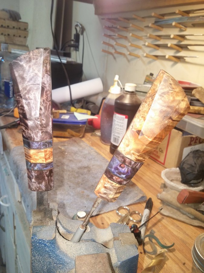

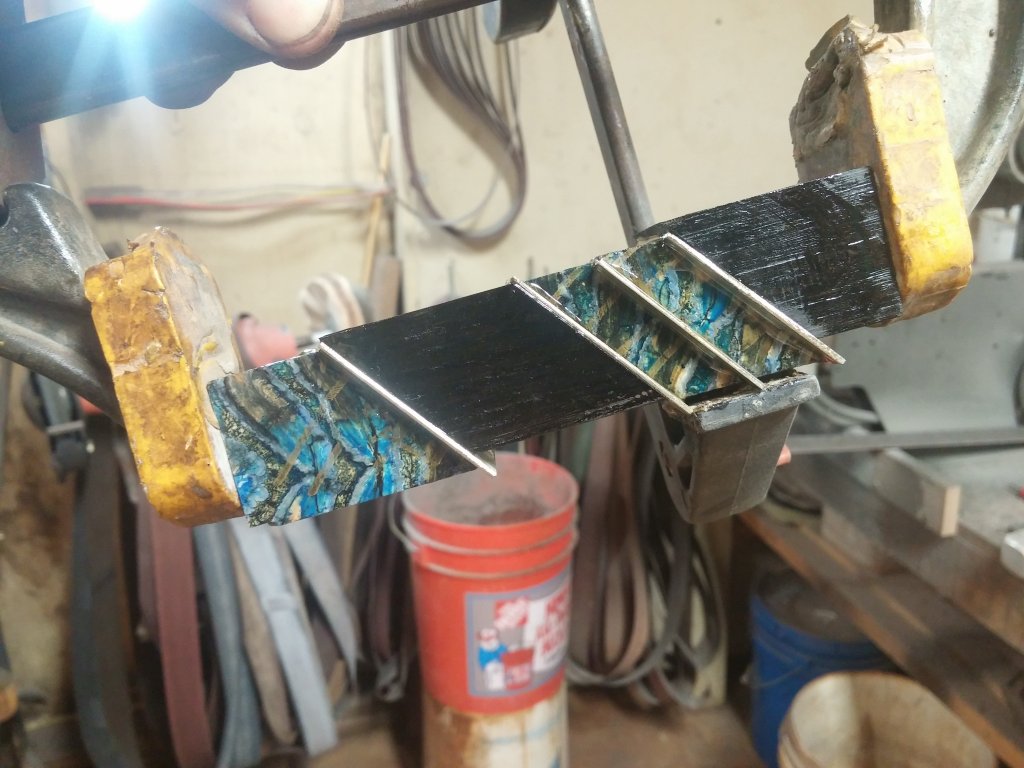

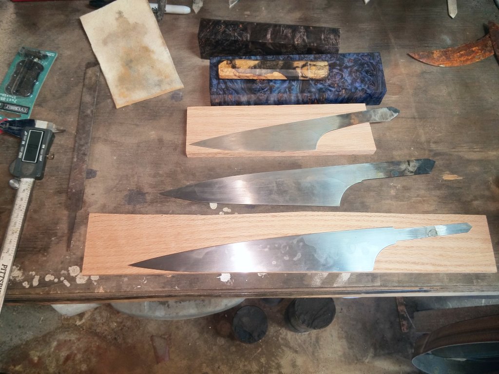

    Two handles out of @JIm Broom's three knife set! The third handle is all cut and ready to to be glued....and I'm not looking forward to it lol. These two fought me in every way imaginable. The grey one shifted on glue up, leaving me JUST enough room to get a clean handle out of it, and the orange one didn't glue 'straight' for some reason. I don't know if I missed squaring something or what, but the spacers were misaligned to the blade. Luckily I had enough 'extra' on that one that I was able to realign the blank (taking material off one corner, as well as the opposing corner) to give me a clean, aligned rectangle. Burning in the knife at a new angle sucked though. Oak dowels are pretty resistant to that sort of thing, which is why I use them :/.

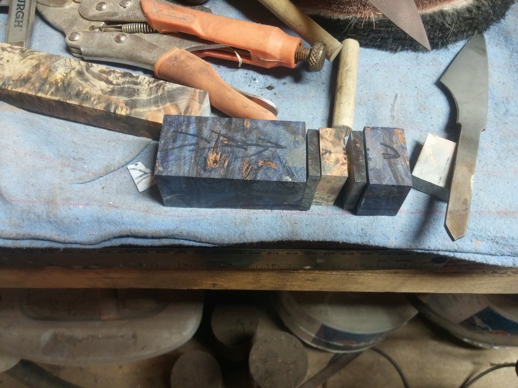

    Anyhow, here's the third all ready to glue up. Just need to make the nickel spacers and it'll be good to go.
    And the top two in this picture are two of the knives of his set. A 210mm gyuto, and a 155mm petty. The third is the 80mm paring knife that was up for sale awhile back.

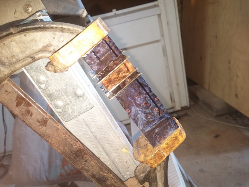

    Got the third handle glued, and working on oiling the others lol.
    As long as I gave myself enough room on the spine, this one should go pretty smooth lol.

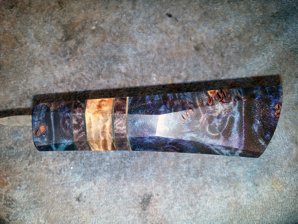

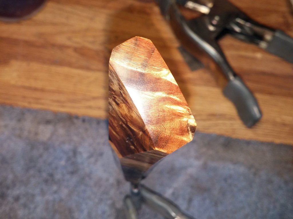

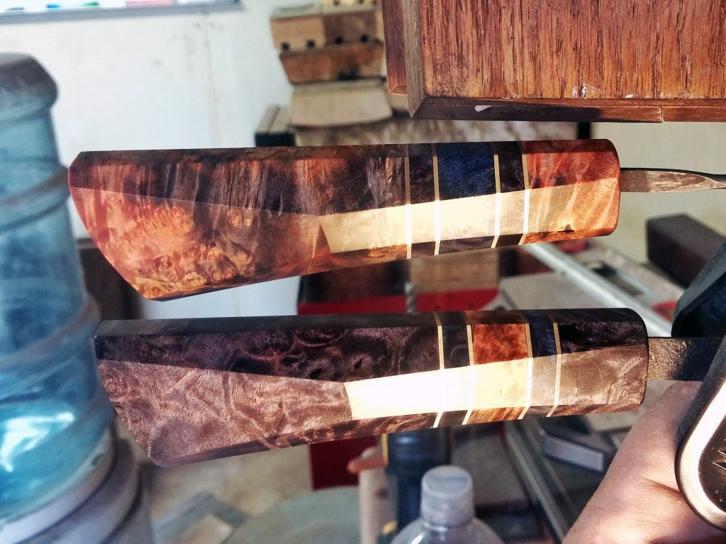

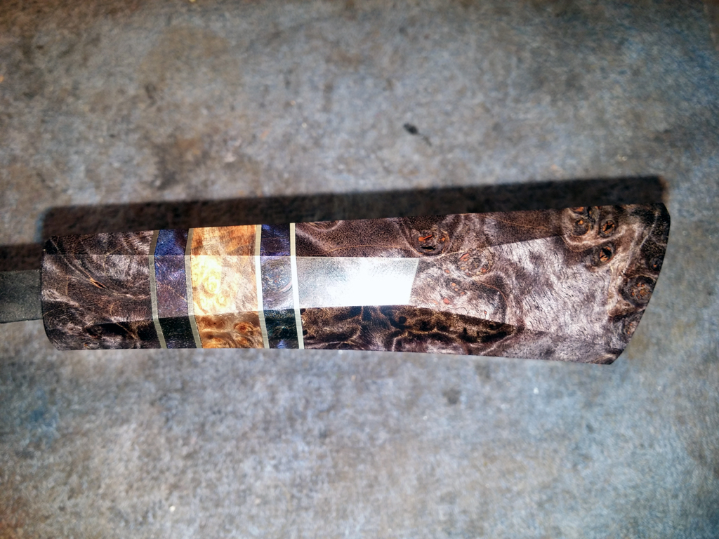

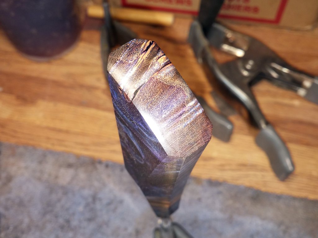

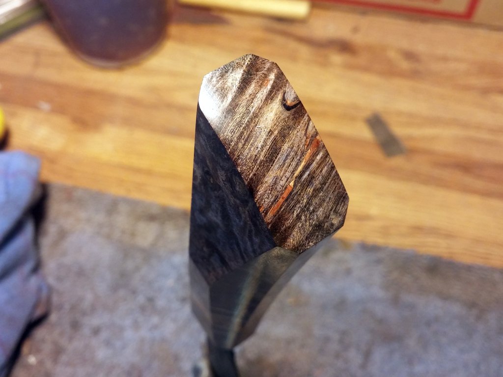

    So...here's how those handles finished out:
    The blue. This one is going on the 210 gyuto.
    The grey one is going on the 155 petty.

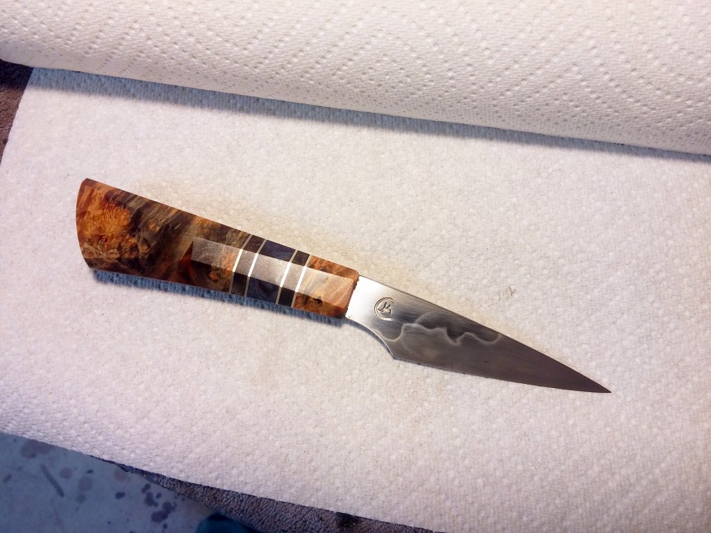

    The orange is going on the 80mm paring knife...which I have a sneak peak of below, since the blade was already rough polished lol:
    I'm going to shorten the neck just a hair as the blade feels different with this handle than with the wa handle that was on it...but even without, it feels even better than it did before. Really, really loving this handle design, and it seems to be really useful in multiple applications.

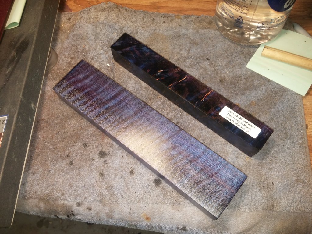

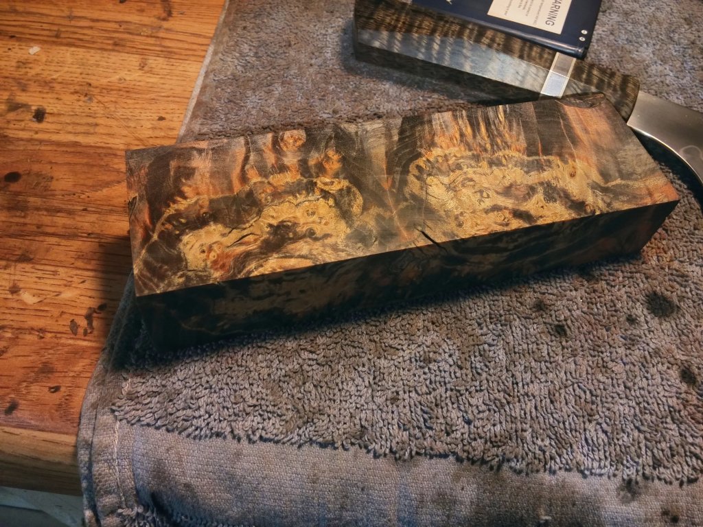

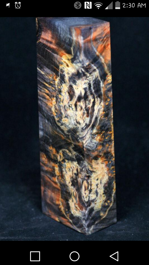

  9. Yes sir! This was the project I had in mind. I've got like four of these blue blocks...but yours had lots of orange eyes in it...which I figured would make a nice tie in for the orange spacer. If you look, the grey piece does as well. The orange piece was from Craig Stevens (I got it from a customer like I got yours)...and was ridiculously overpriced. By HIS pictures...it had blue in it. Of course when I got it it was all grey. This is the third piece of his that the picture was so ridiculously post processed that the colors weren't even close. I won't be going down that road again. I generally buy from Mark and Myron only (and Pete from PetesKustomKoa lately), but sometimes other vendor's colors draw me in.
    This was the picture from Craig. He says these pictures are just 'wet'. However...
    ...this is the same block of wood after taking it to 1200 grit on one side, and wiping it with mineral oil (the color should pop even more than just 'wetting'). Obviously the figure is the same, but that piece wasn't bought for figure lol.
    Anyway.../rant off. The customer I bought that from paid $120 if I recall...for a smallish 4.5"x1"x1.5" oblong cut blank. I guess Mark and Myron have just spolied me with their accurate colors and large, square cut blanks for 1/3 to 1/2 the cost :p.

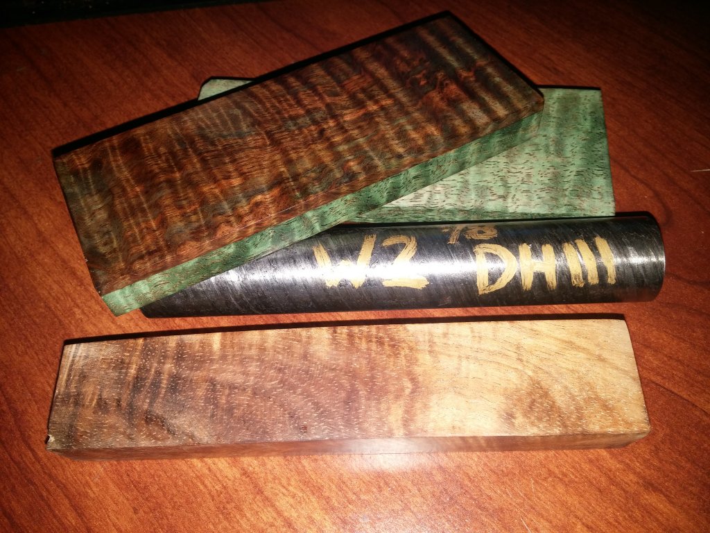

  10. Ooooohh!! Lookie what was in my mail box today!!
    And a better picture with the Tootsie Roll opened lol:
    That's a mango/lychee laminate from Peter Rushton of Pete's Kustom Koa in Hawaii, and a piece of Don Hanson III W2 (ironically, I used a knife I made from Aldo's W2 to open it lol) from @coldsteelburns :). I was thinking of making something from the two of them together...but sadly the laminate is already spoken for on a customer's knife.
    I also had a serious blast prepping dinner tonight with @JIm Broom's gyuto:
    Honestly, even unpolished the thing was just a beast. Some of you might notice I raised the spine profile a hair on this one to get some weight into the front of the knife (this is a definite struggle I face with each and every knife lol...light is thin, and thin cuts. Hitting the perfect middle ground is a genuine challenge!). I like the look a lot to be honest, beefy and aggressive...and the effect is noticeable.
    Anyhow, thank you Paul for the W2, and Pete if you happen to be browsing here, thanks to you as well! I'll keep you all updated on what comes from these two pieces as I use them :).

  12. It would take a month to do what I did on stones brother, lol!! It was 95% grinder work, 5% stones. Your comments about the work done were pretty close. By straightening the edge it made it much more friendly to push cutting and pull cutting, because the edge will contact the board in a larger area, limiting its ability to 'miss' part of the food being cut. Basically, with the old profile, you HAD to rock to get a clean cut. With this profile, a simple push or pull or chop will cleanly separate the food due to the amount of edge contact on the board. Imagine using a flat knife on a warped board, and you can maybe picture what I mean. The food that sat below the flat edge wouldn't be cut, because the edge wouldn't contact the board in those areas.

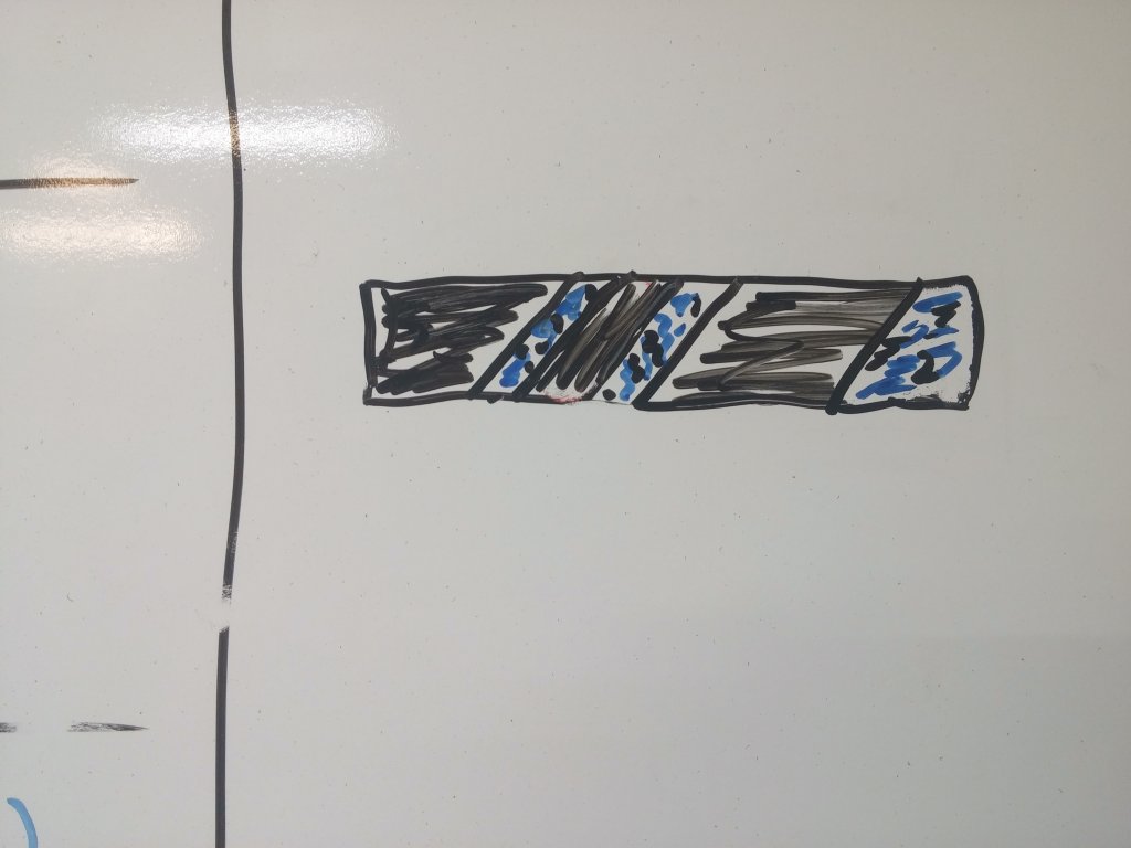

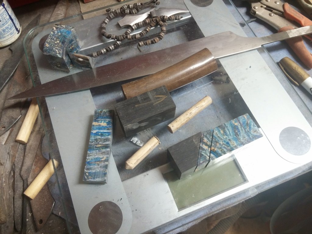

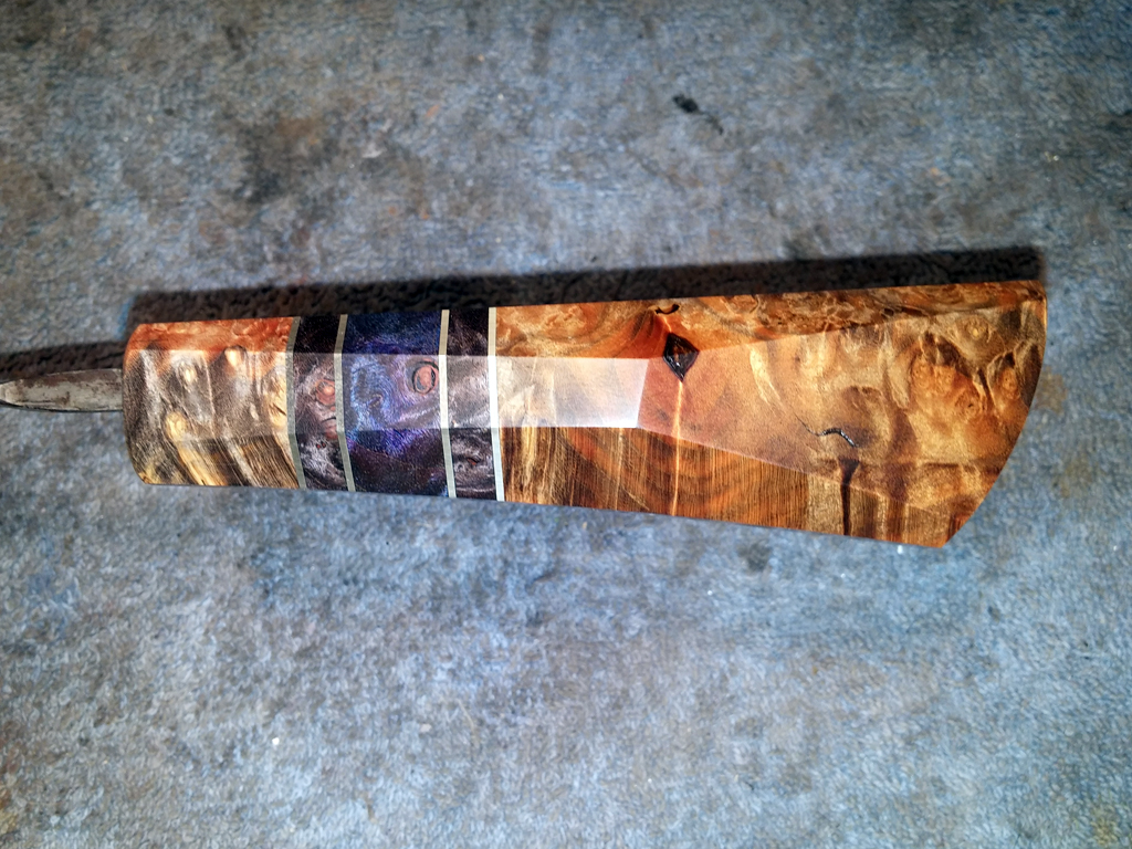

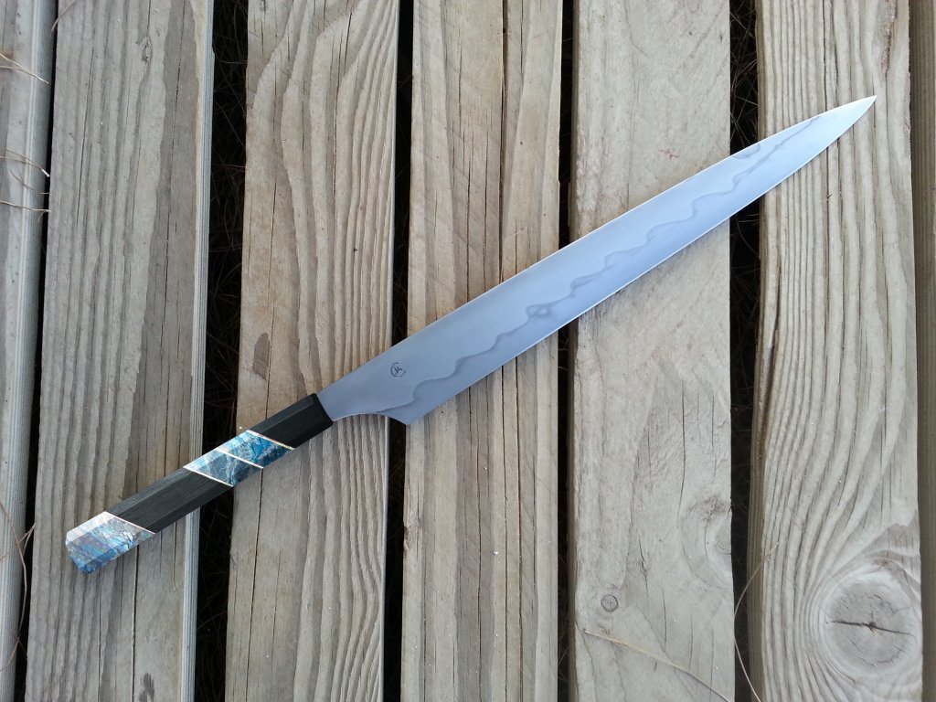

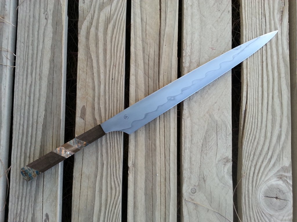

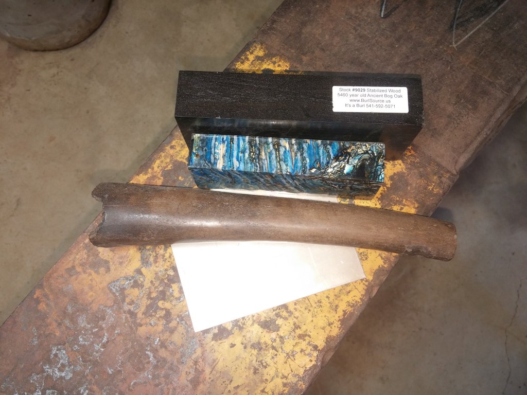

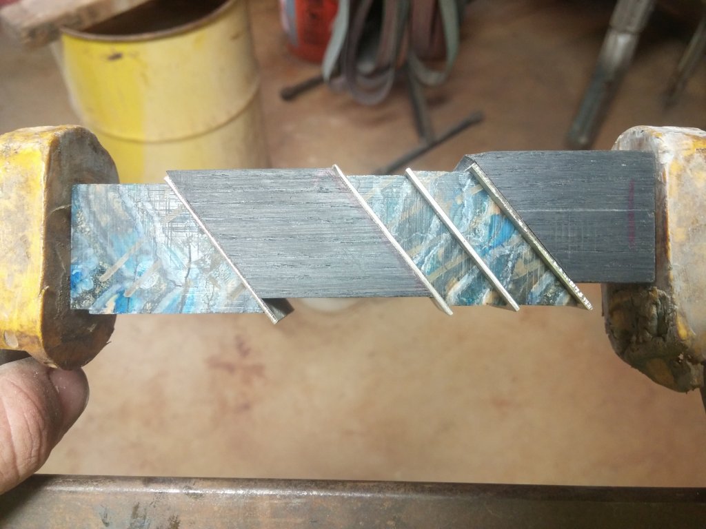

    The materials. We were going to use the oosic, but decided the color just didn't quite fit with the overall theme, so it got left out in the final handle iteration.
    The initial concept. We were going to put the oosic between the two diagonal mammoth tooth spacers.
    Making the cuts. THIS SUCKED lol. That tooth is hell on tooling. Luckily I'd ordered some diamond hole saw bits for the slot, but it killed my brand new bandsaw blade in 3 seconds, and so far has ate six Cubitron III 36 grit belts. To give you perspective...the 300mm blade in this picture took two 36 grit belts to grind, from fresh forged (including forge scale!), through rough shaping, heat treat, and final grinding the hardened W2. Mammoth tooth is nasty stuff lol. To cut it I ended up using (multiple) 4" cutoff wheels in a hand held angle grinder.
    The initial photoshop proof that made us decide against the oosic. I used my first suji blade (which belongs to @ChuckTheButcher) for the template, as it's of similar size and shape and I figured it would give a nice overall feel to what the new blade will look like.
    A second photoshop proof, eliminating the spacer. None of these showed the nickel silver I intended to use between each seperate segment (including between the two pieces of mammoth tooth in the middle).
    Final dry fit up of the pieces. The misalignment in the pieces is incredibly annoying, and is my own fault...but I'm not horribly worried about it, as everything is still centered on the dowel, and should have plenty of material for a straight wa handle.
    The final proof before glue up, including the nickel silver liners. If you noticed, we made the angled butt cap longer. I was initially going to trim it down as in the second proof, but this looked so good we decided to keep it long.
    And allll glued up!

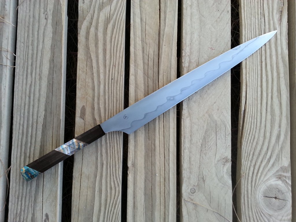

  18. Lol...the handle is done...but you'll have to either check IG, or wait till Dinsdale sees the video before I post it :p.
    It turned out I suppose. Not much else to say about it.
  19. Post away, its a beauty.
  20. Will do my friend, and thanks!
    As I said to Dinsdale...I sound kind of like an idiot, but every time I'd start to day something, some other aspect would catch my attention and I'd lose track of what I was saying. Plus it was 5am or so and I hadn't been to sleep lol.
    Anyhow...I think this one's going to finish out nicely :).
