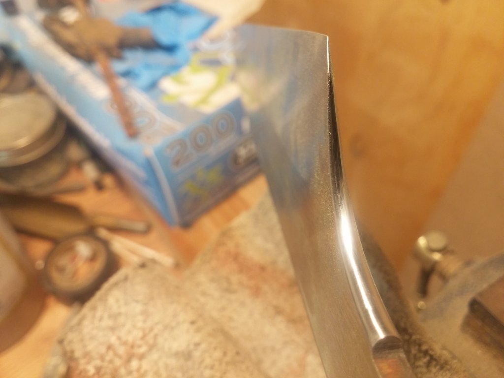

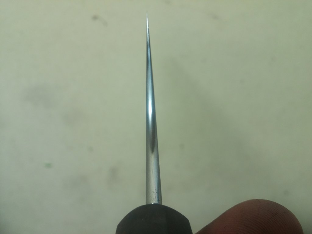

    200mm x 54mm tall and 4mm over the heel, with spalted deep compression koa, wrought iron, nickel silver, and W2.

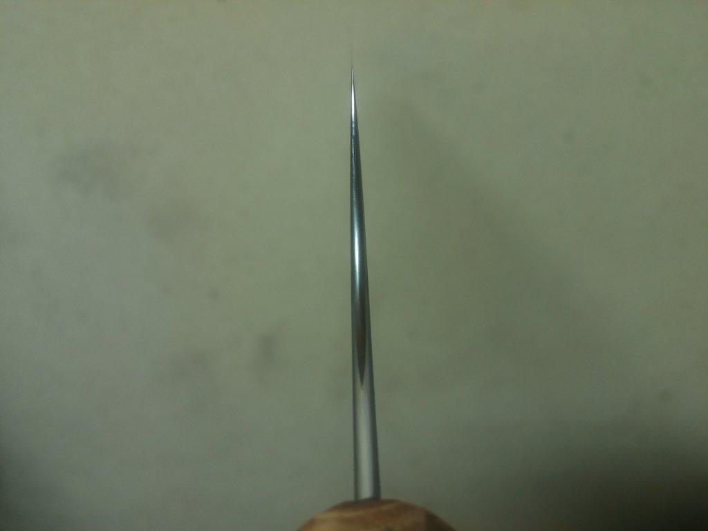

    :D...I think this speaks for itself to an extent...

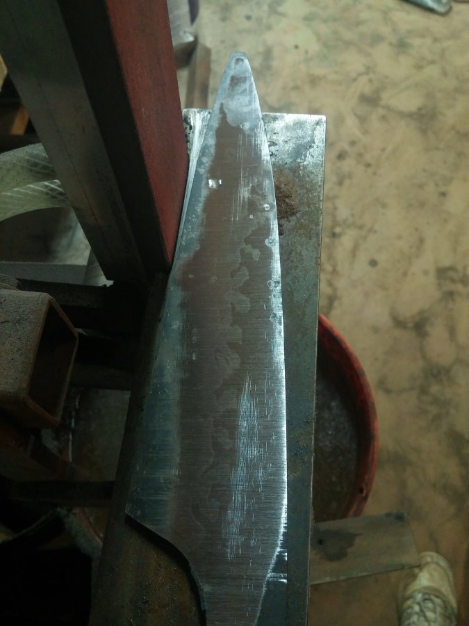

    20150706_050905.jpg ...but if it doesn't, thats about a 15° inclusive bevel ;).

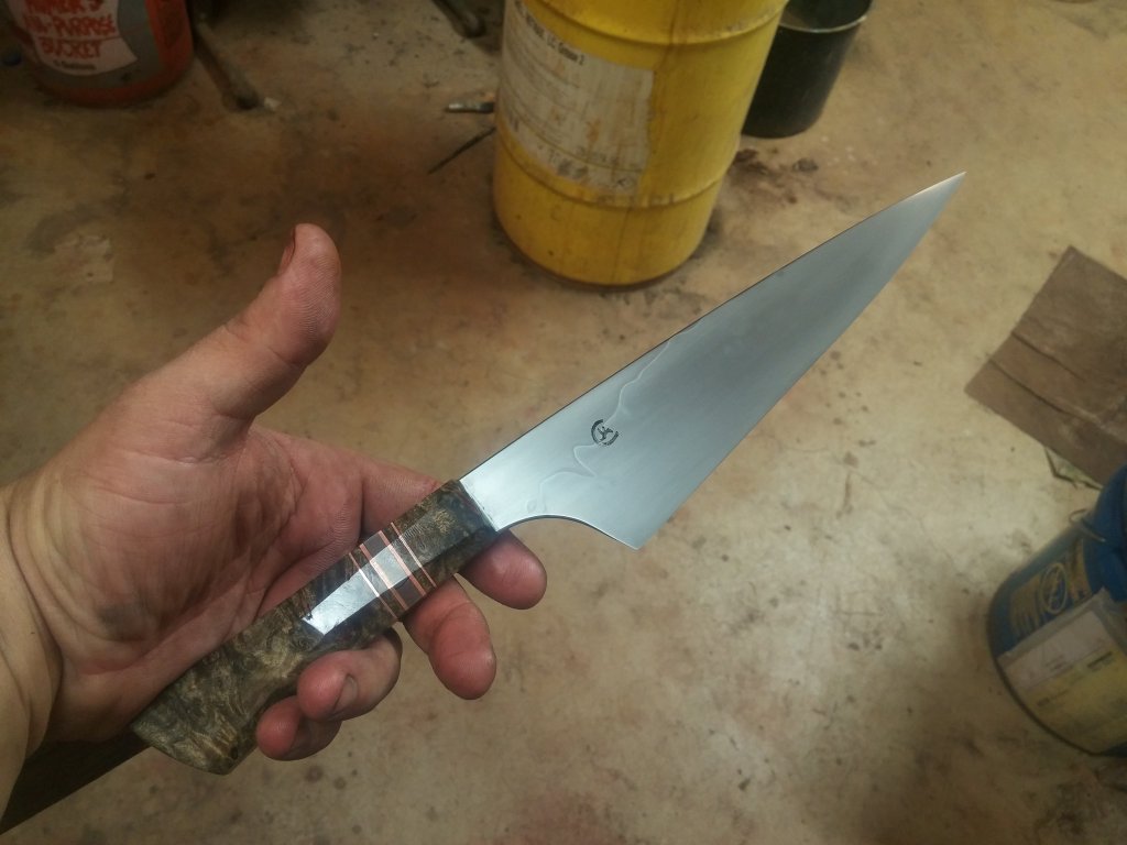

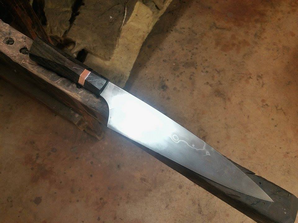

    @coexist44's 170mm W2 ko-gyuto :D. Hair splitting sharp, and ready to go out the door!!

    Hope these guys take well to the faceted handles. They look good.
  6. Brad Gibson
    beautiful work cris. mirror the choils and the spines on the next ones for fun. these look beautiful.
  7. Thanks guys! They are mirrored...or close anyhow. The camera just doesn't catch it well in my shop.

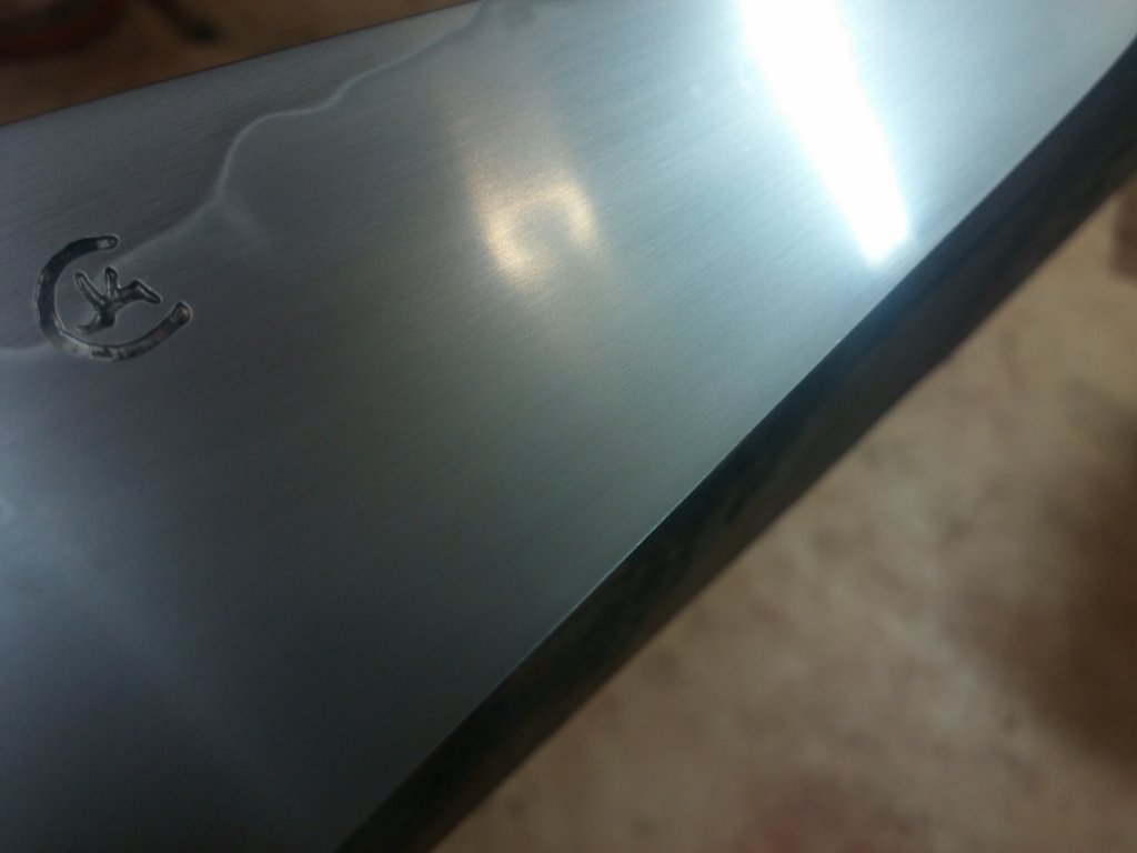

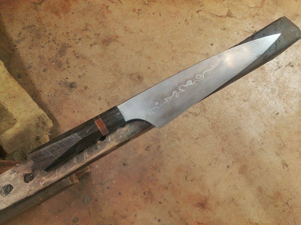

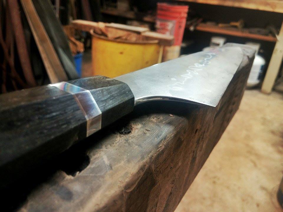

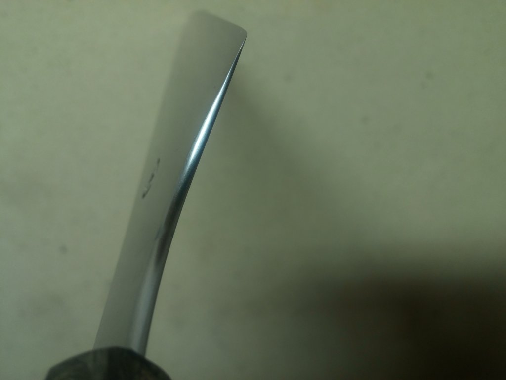

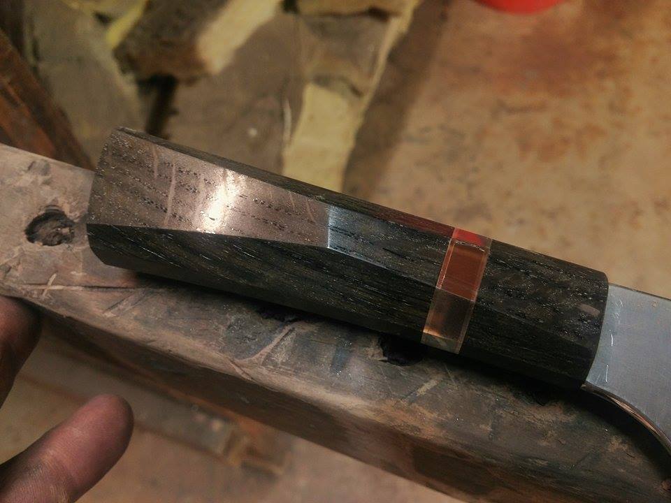

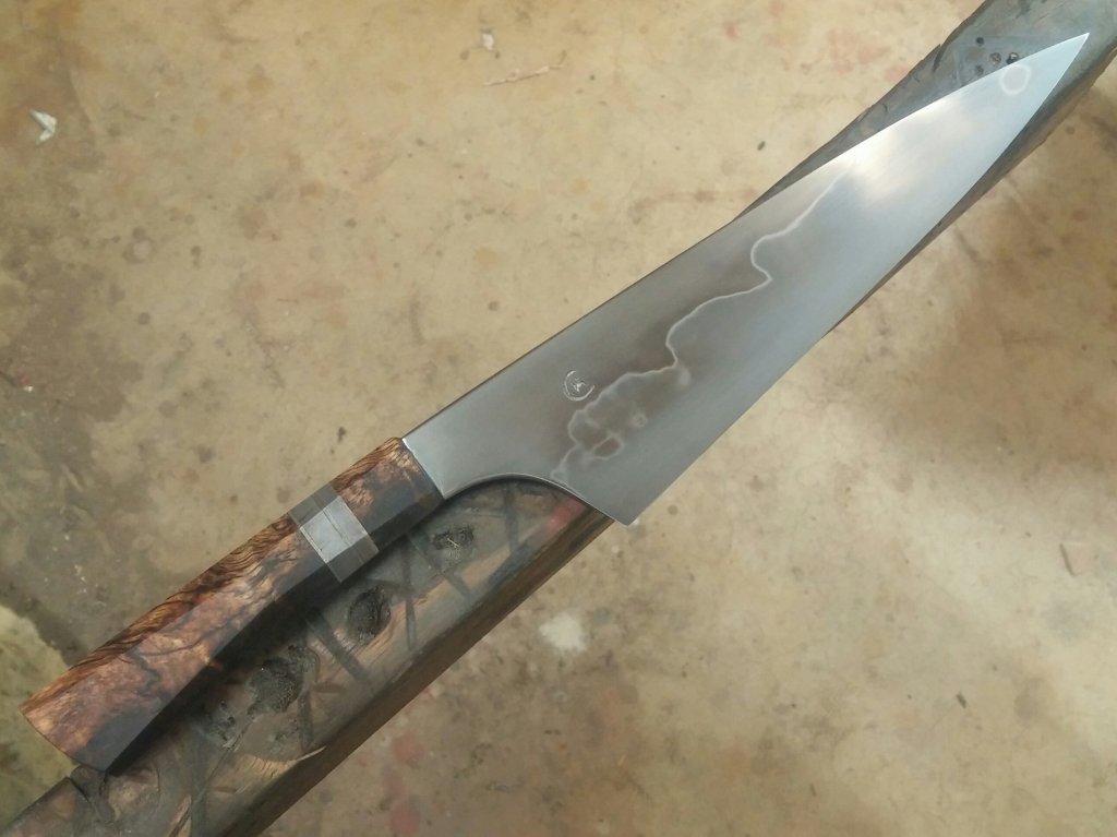

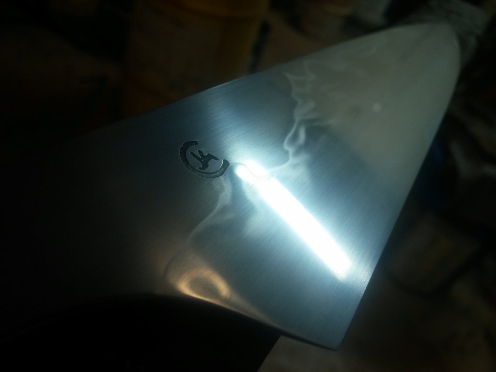

    Here's a few more from tonight's completed gyuto ;):
    207mm x 50mm x 3mm at the ferrule.

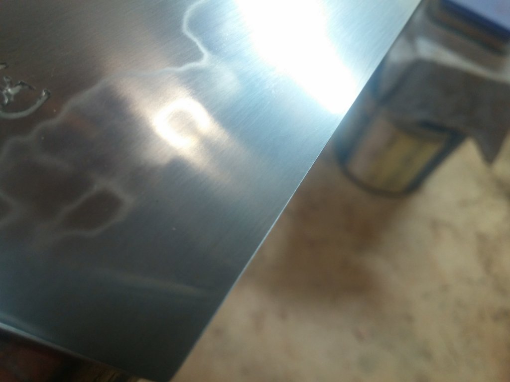

    I couldn't angle the blade right to catch the light on the primary bevel...so you got a cool maker's mark/hamon shot instead :D.
    See...this is pretty mirror looking, and the others are the same. It's a bit dirty up near the edge is all, lol.

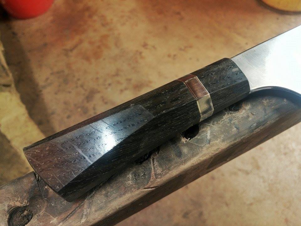

  8. MotoMike
    Looks awesome Cris. Your newish handles look very refined and as if you've been making them forever. A very nice look and I'm guessing a bit of form following function?
  9. Thank you my friend! And yes...very much so, particularly with the dial taper :).

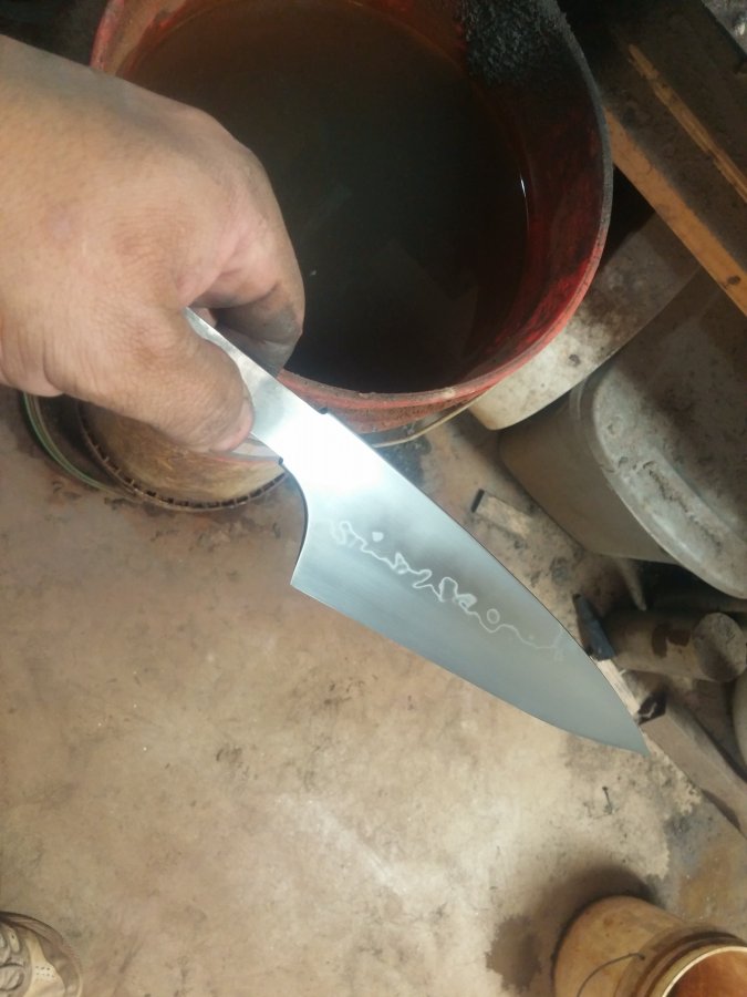

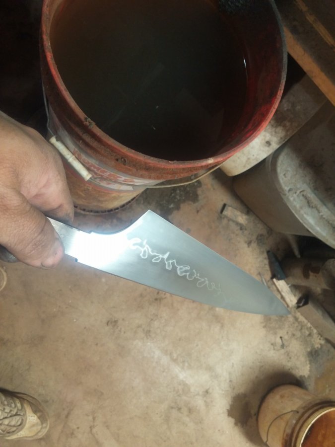

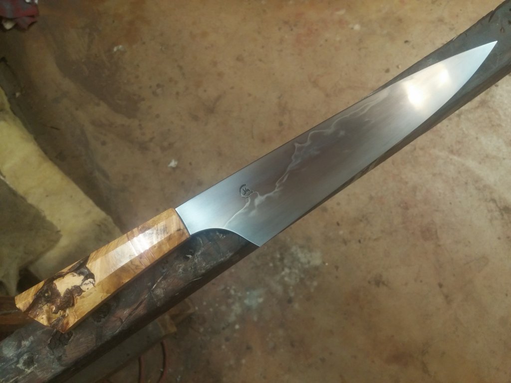

    Some of you may have seen Anton's knife the day I heat treated it:
    REALLY serious potential right there, lol. When you see something like that post heat treat...you know you're in for a wicked line.
    And...it didn't disappoint :D. This is only a dirty 600 grit so I can make the handle and saya. From there it gets its final polish...and then we'll see what it really has to give us!!
    Oh, and for the record...this is another extra beefy little beast!

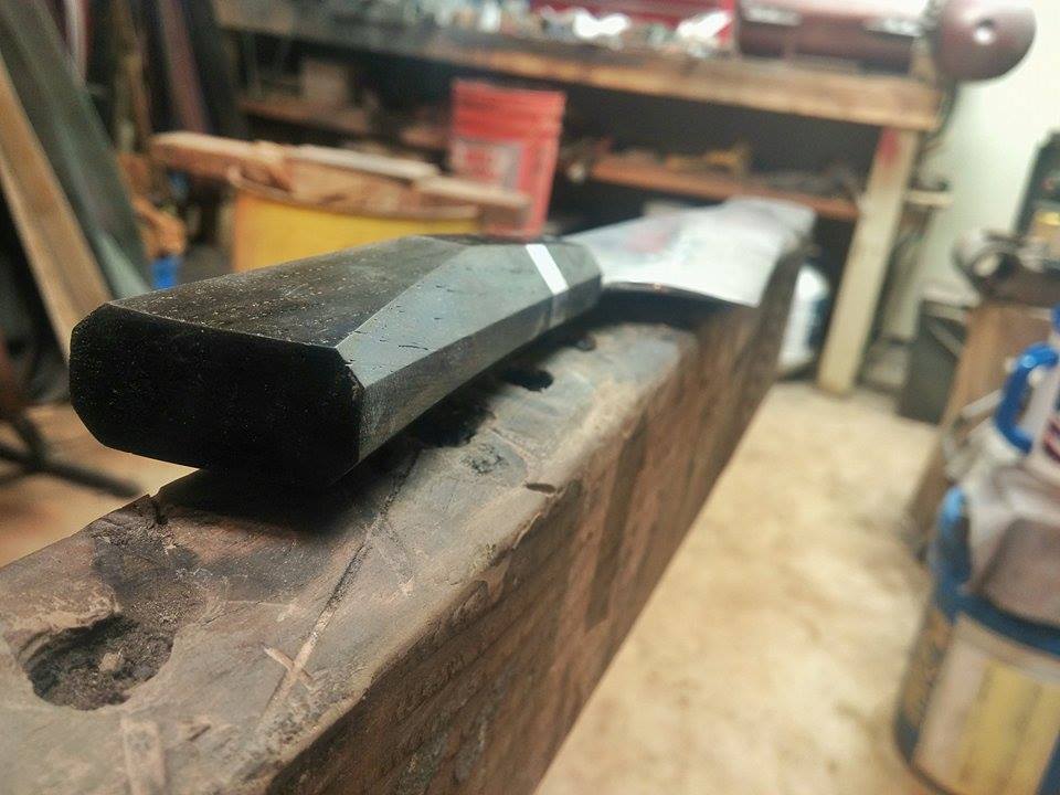

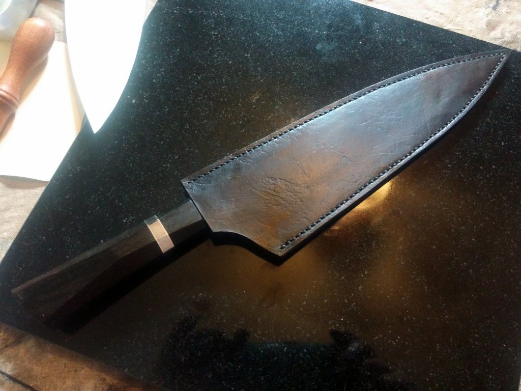

  15. Anton's knife coming together :D!
    11721159_1634034123481153_1587091088_n.jpg 11739648_1634034140147818_517272641_n.jpg 11736909_1634034156814483_926455976_n.jpg 11720478_1634034230147809_427918195_n.jpg 11715895_1634034250147807_1094120955_n.jpg 11748615_1634034203481145_1533139440_n.jpg
    The bog oak still needs a bit of finish work...there's a TON of figure in this piece lol. Most active piece of bog oak I've ever used. Tomorrow I'll complete the saya, then it's final polishing and fitment probably Monday, and off it will go to its new home in St. Petersburg! I think we passed the time where it'll make it before his birthday...but it will be close :D.
