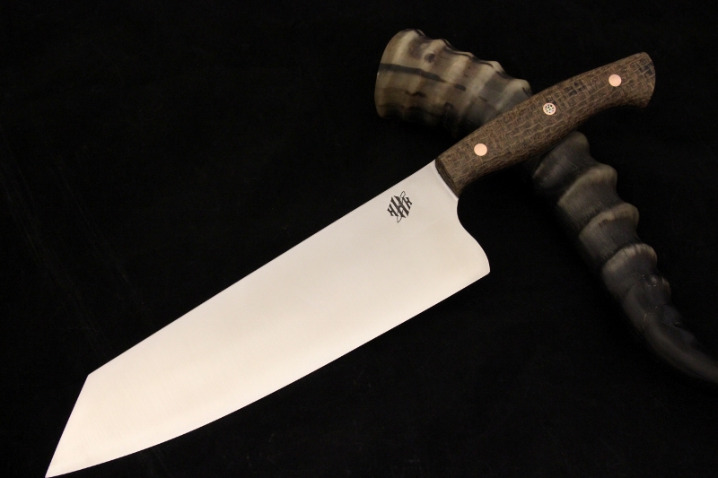

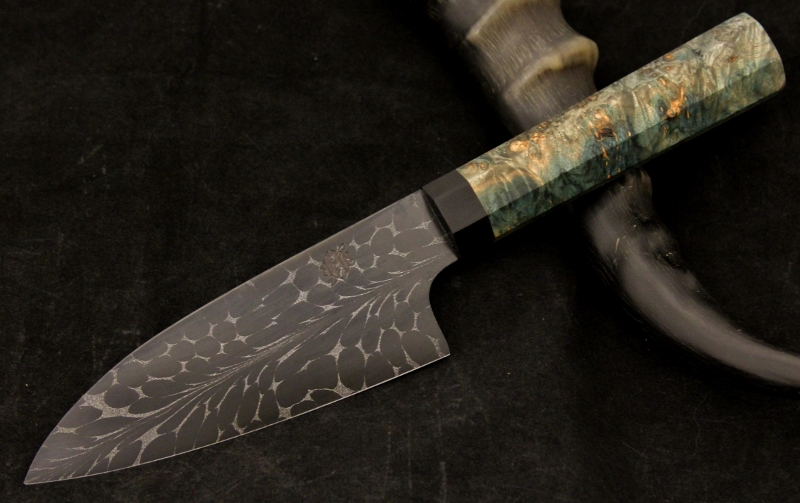

  1. cheflarge
    One darn sexy fillet knife, sir!!! :cool:

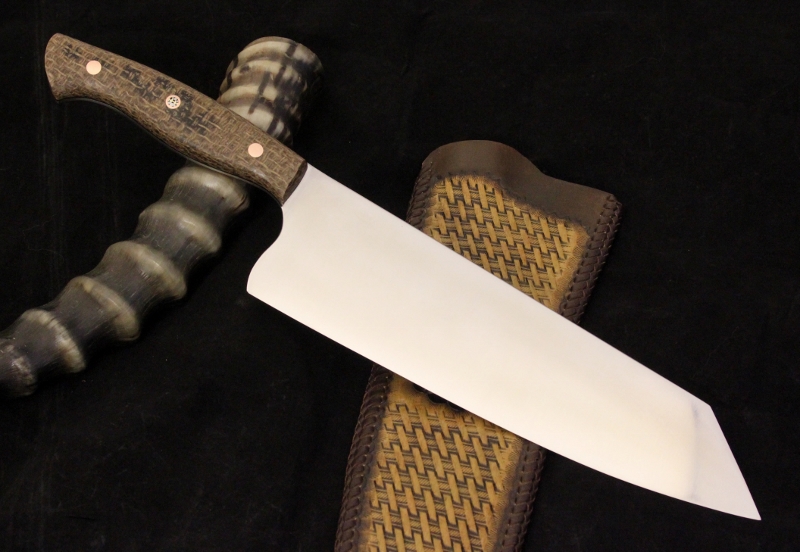

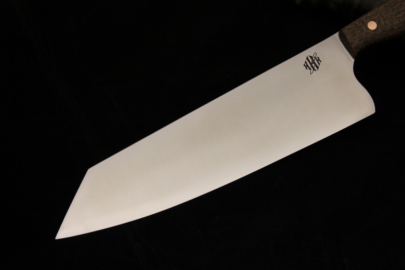

  2. HHH Knives

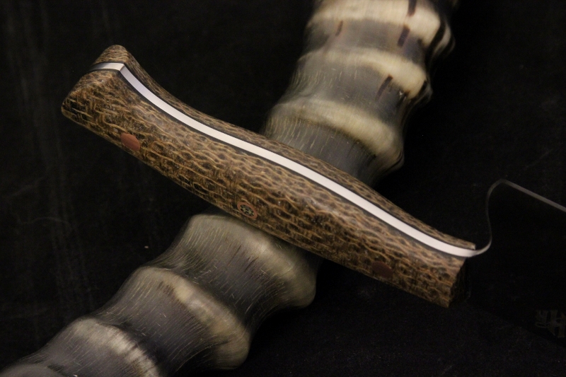

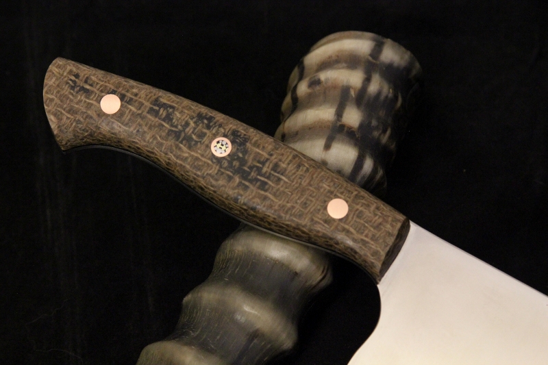

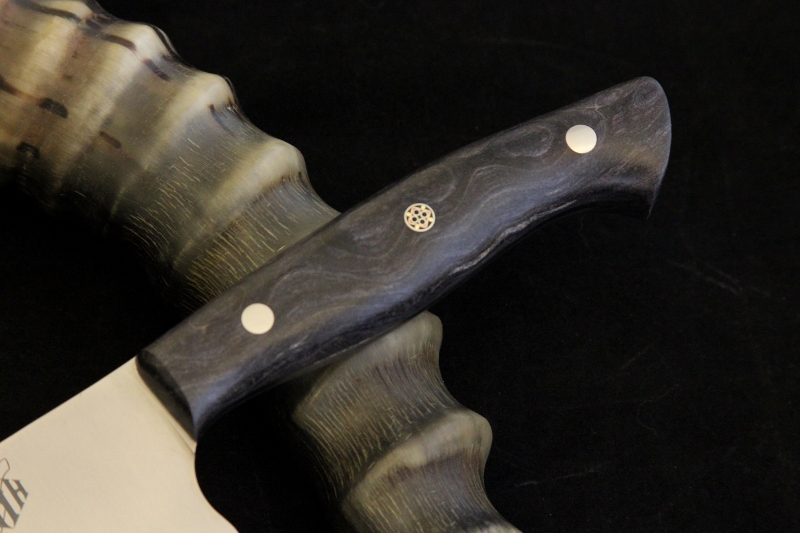

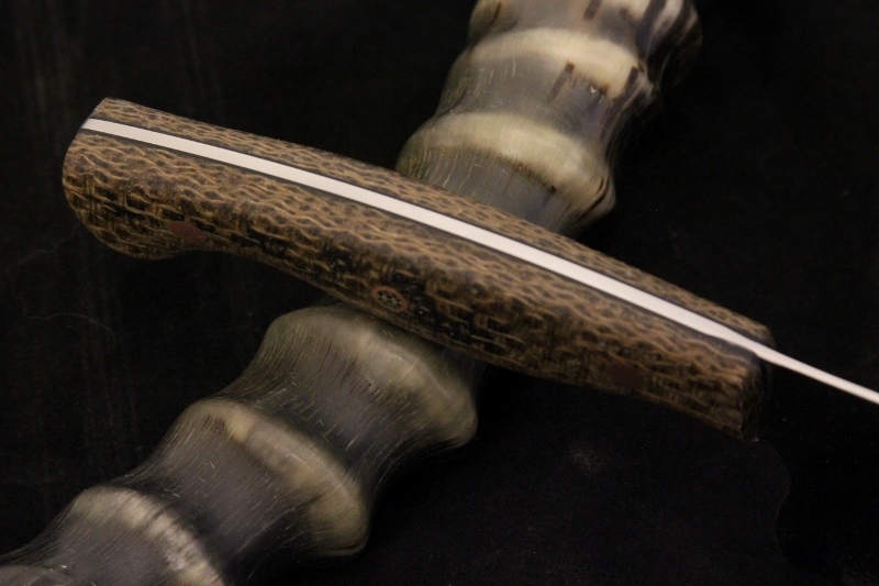

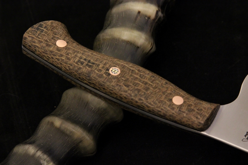

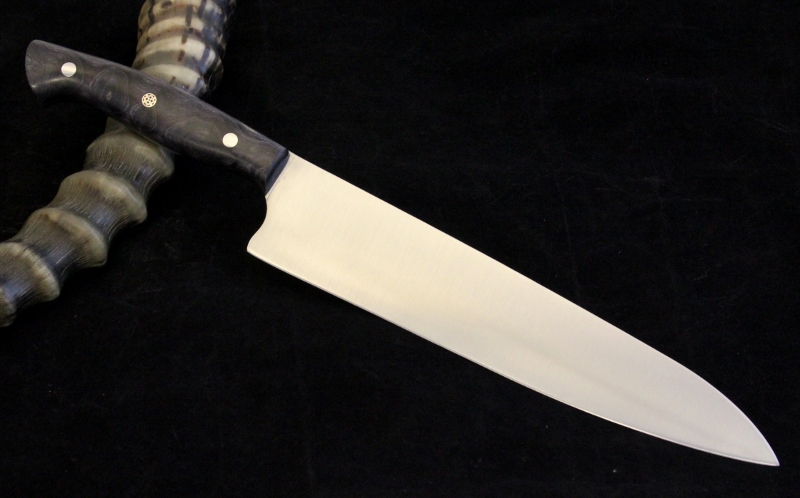

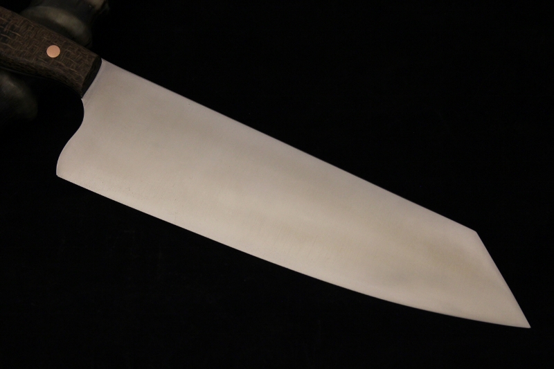

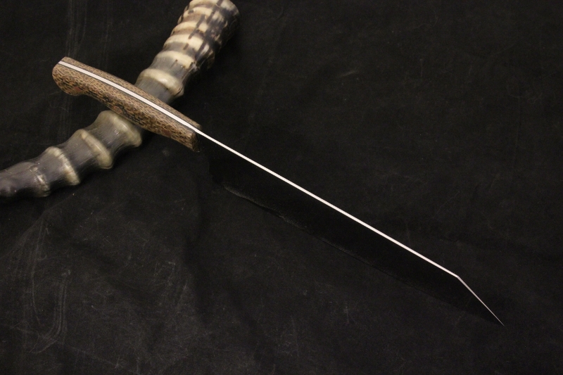

    Prep monster.. Revisited!
    CPM Stainless and coffee bag.
    230mm tip to heel.
    62mm tall at heel
    Thoughts?

  4. HHH Knives

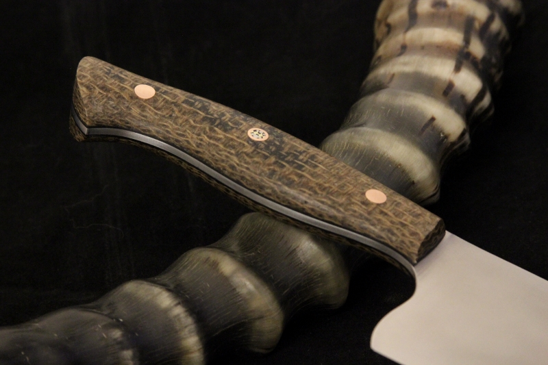

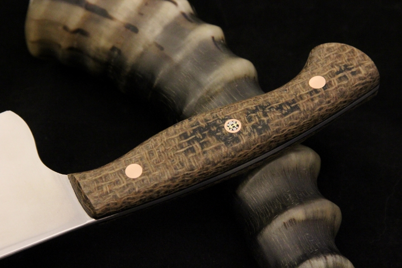

    The handle on this one is made from coffee bags..
    Say again? Coffee bags?
    Do you have pictures of that process? or rather...how the heck did you do that?

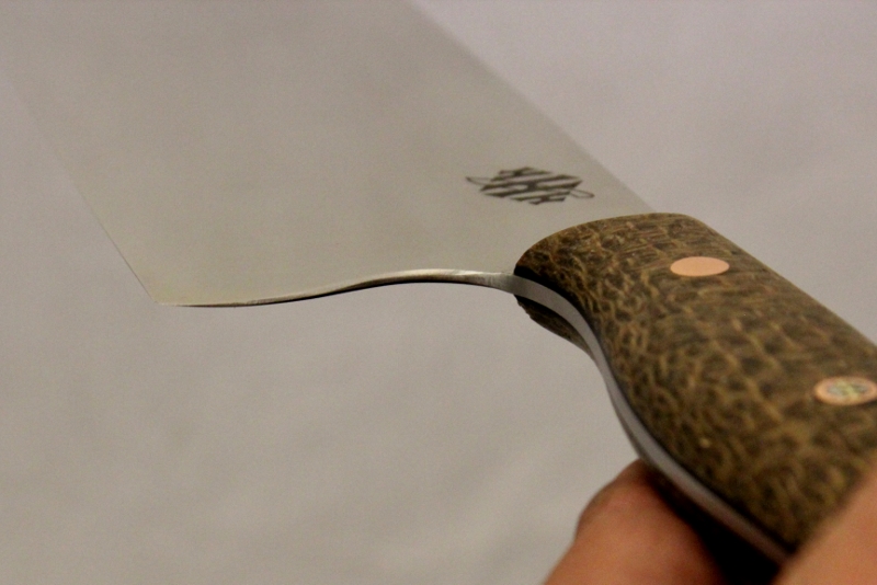

  8. Looks very purposeful, and the extra height will likely increase its usefulness for a wider variety of tasks. Likewise, the kiritsuke tip brings another level of adaptability for tip work over, say, a cleaver.
    Stylistically, however, the recurve in the choil isn't sitting well with the aggressiveness of the kiritsuke tip for me. I'd prefer a more traditional choil treatment, though I know this design is a somewhat of a signature of your work.
    Overall, it's a beast and I like it :)
  9. HHH Knives
    I dont have images of the process.But can describe. The coffee bags are cut to size and then soaked in a epoxy resin. then layered one on top of the other. At this point they are pressed in a home made jig. and allowed to sure. The resulting piece is then processed further into either knife scales or blocks etc.
  10. HHH Knives
    Thanks for the input. I can see where the S shaped choil is for lack of a better term. out of place on this knife. Yet its usefulness in my opinion trumps that. :)

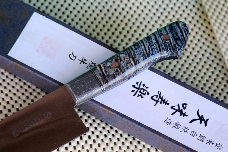

  16. HHH Knives

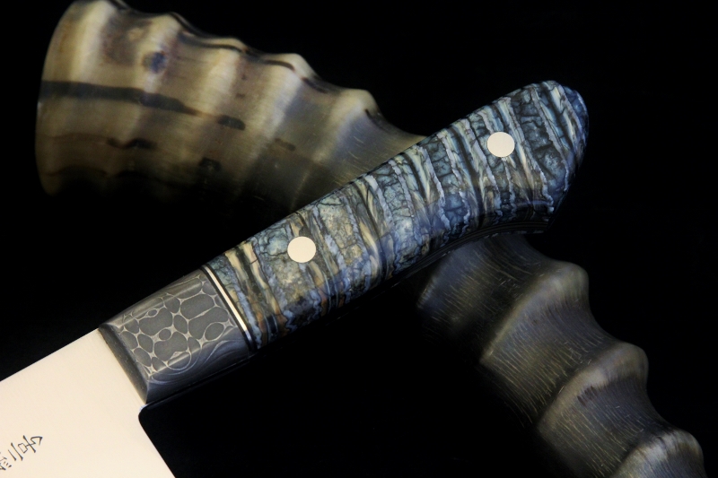

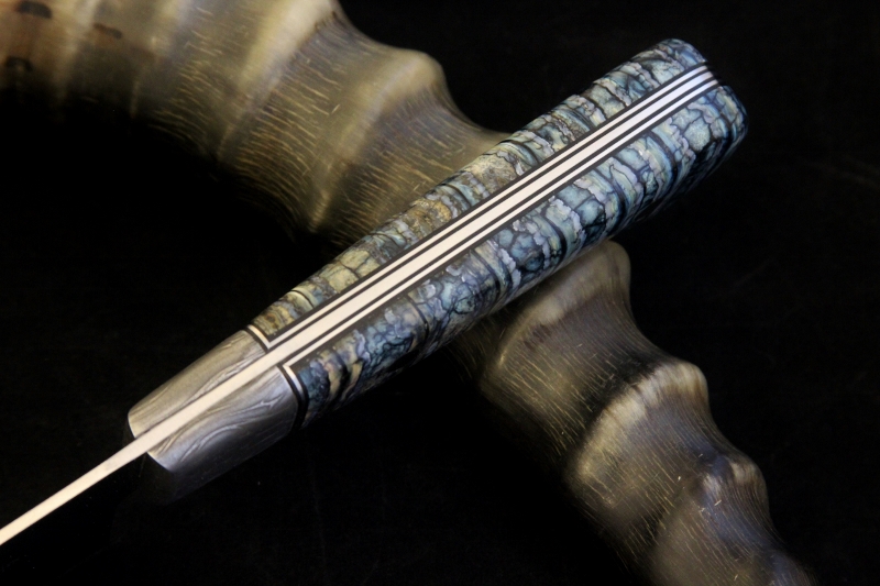

    I dont often do re-handle work. But when I do.... Its PIMP!!!
    This one is stainless damascus bolsters paired with mammoth tooth and stainless hardware..
    IMG_6024 (800x533).jpg IMG_6029 (800x533).jpg IMG_6033 (800x533).jpg IMG_6030 (800x533).jpg IMG_6032 (800x533).jpg IMG_6035 (800x534).jpg

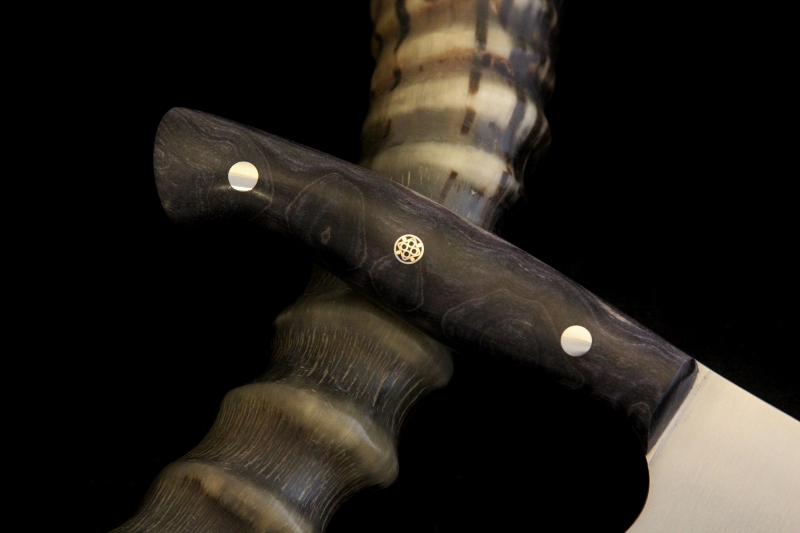

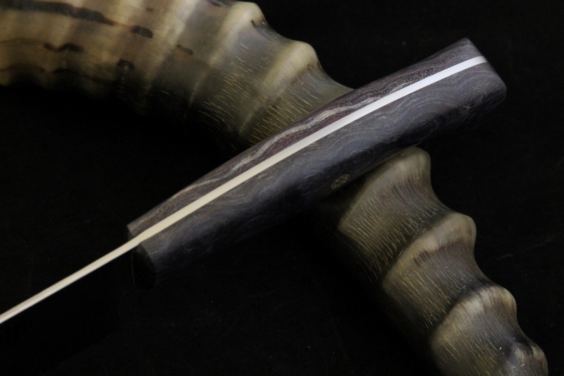

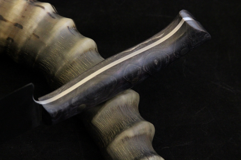

  19. HHH Knives
    IMG_6016 (800x533).jpg Black Beauty.. [​IMG]
    HHH Production 240mm gyuto blade from the run I did a few years back. It was mis marked at L&G.. Its been hiding in a box in my shop for a few years and I just found it the other day.. Perfect timing. As someone on the forums was looking for a knife for his chef. [​IMG]
    AEB-L stainless blade with Black quilted maple handle. Stainless fittings.. [​IMG]
    IMG_6040 (800x533).jpg IMG_6041 (800x533).jpg IMG_6048 (800x498).jpg IMG_6045 (800x533).jpg IMG_6042 (800x533).jpg IMG_6043 (800x533).jpg

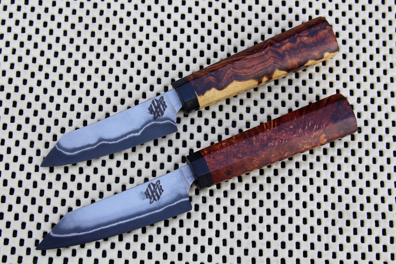

    And some Strawberry Slayer pairing knives!
